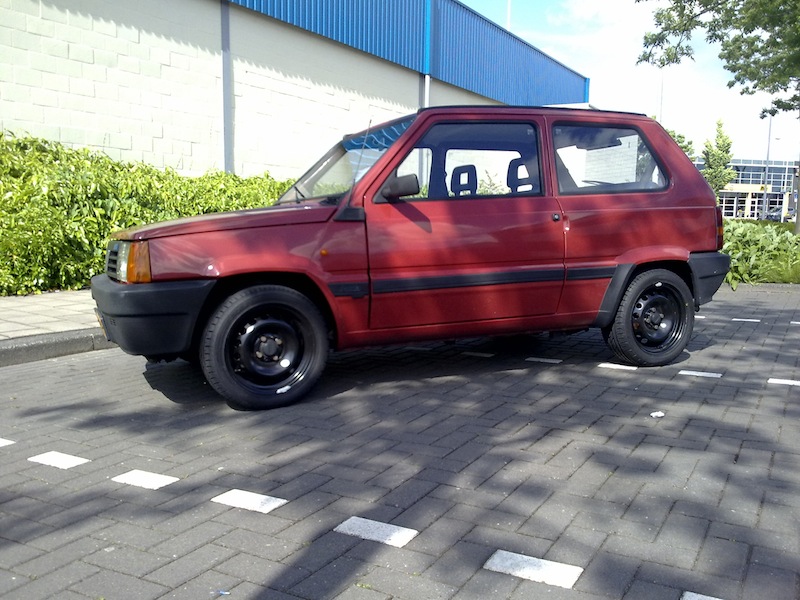

I had 5.5x14 ET35 steel Panda 169 wheels with 185/50R15" Toyo Proxes CF2 tires, on my 141A 1100 Young, with 30mm H&R lowering springs.
Awesome road performance, like a Go Kart.
