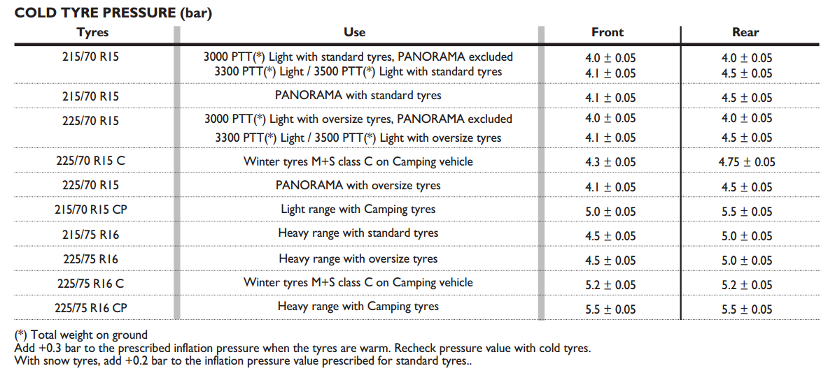

Hi. I checked the tyre pressures on my Ducato motorhome today. The plate on the body says they should be 79.5psi all round. The front 2 were 75psi. The back 4 on tag axle were around 55psi. I have inflated to 79psi. Is this correct or is there some reason the garage / previous owner had them at this pressure.
What tyres are you running on?
How does the vehicle tyre spec compare with the spec of the tyres fitted?
Maybe(?) the previous owner/dealer has kept the psi within spec of the respective tyres.

In general inflation is related to load and tyre size, with a tag axle and under max load I think 79psi will be horrible.
You can contact your tyre manufacturer for technical advise.
The plate on the body will be for a standard van not a motorhome.

attachment.php
Thanks all for the advice. I'm still confused. When inflated to 79psi there seemed to be a marked improvement in handling. Do you think the dealer will know the correct pressure. Seems a big difference from front and rear when front were at 75psi and rear at 55 psi. Would this be because of the tag axle?
I agree the plate could be for a van as it shows a single rear axle.
Just a note. Tyre sizes are 215/75R 16 C on a burstner motorhome weight 5000kg
In that case you're running over 90% of max load all the time with just the wife, water, gas, diesel and a few small provisions on board so those pressures sound about right .. just make sure the tyres fitted can take that pressure. Also check the valves, tyre shops often put normal valves on which aren't rated for that pressure.

The first thing you need to do is get your van on a weighbridge. I also have a 5 tonne MAM Burstner Tag Axle and due to the layout, I can easily go well over the front axle weight limit of 2,000 Kg.
Your front axle tyre pressures sound about right, I run mine at around 75 psi, anything around 75 to 80 is OK. The rear axles could be a little lower than 55 but I would leave them as they are. mine are actually higher than yours. My reason for this is that motorhomes spend a lot of the time standing around and my opinion is that the tyre walls last longer with the extra pressure.

Using Michelin Agilis 215/75R16 CP 113R
They are the recommended tyre and rating for the vehicle. The rating is pretty borderline that is why I put the van on a weighbridge. There is no spare capacity so I have removed the Super King Size mattress (we don't use the overcab bed), I travel with a minimum of fresh water and there is only 2 of us (plus the dogs).
Remember that the 2,000 Kg axle weight is carried by BOTH tyres, that is 1,000 Kg per tyre.
Using Michelin Agilis 215/75R16 CP 113R ... the 2,000 Kg axle weight is carried by BOTH tyres, that is 1,000 Kg per tyre.
The 1275kg/75psi was based on an individual front tyre.
The error in my thinking was that the load sits squarely on the 4 (or 6) wheels.
I see now there’s more to it.
Michelin (as one might expect) provide detailed guidance. They advise the load on each individual tyre should be measured - & where there is load variation between 2 tyres on the same axle, then both tyres should be pressurised to the higher load value.
But help me out – what load/inflation table provides for the stated 75-80psi for a 113R tyre?
