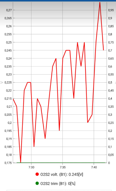

P0141 (post cat O2 sensor heater control circuit malfunction)

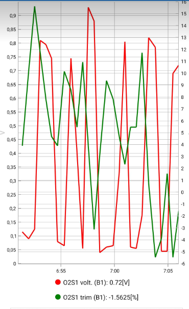

P0130 (pre cat O2 sensor circuit malfunction)
And the car was doing about 12l/100km.
I replaced the pre cat O2 sensor and the fuel economy is back on track. I due however still get a P0141 error after driving for a while.
Now the obvious solution is to also replace the post cat O2 sensor. However, it is rusted completely into the exhaust and I doubt i can get it off without ruining the exhaust. I also find it very unlikely that the two O2 sensors should fail simultaneously. Could the problem be something else or does someone have an idea on how to remove the rusted sensor? I am currently running the car without the exhaust heat shield (since it is rusted into oblivion) - could this cause the "heater control circuit malfunction"?
I've attached the Pre and Post cat sensor readings.

The pre-cat sensor is the one that does all the work. Your code suggested that one's sensor circuit was dead, and replacing it seems to have fixed that issue.
The post-cat sensor is there to confirm that the catalyst is doing its job. The code you quote states 'heater circuit', so that sensor needs replacing too, although less urgently.
The sensors need to be hot to work properly. They have a heater in them to get them hot, so they work quickly, without having to wait for the hot exhaust to heat them. The heaters then shut off after a short time. Without the heater, it just takes longer before the senosr can give good readings. Once it is hot, from the exhaust, it will function properly. If you have no other codes, the catalyst is working fine, and so is the sensor itself, once hot. You may suffer a slight iincreasein fuel consumption until it is replaced.

Thanks a lot for the answer. I will try to get an additional sensor asap. Meanwhile, should there be any concerns about driving the car? I'm worried about destroying the cat. The fuel consumption is back to normal.
Feb 22, 2004
9,099
Faringdon, Oxfordshire UK
No concerns. The pre-cat sensor is the important one, which is now working as it should. The post-cat is just an auditor, which due to the heating element beng dead, will just take longer to warm up and report properly. Only effect will be the code you've already got.
