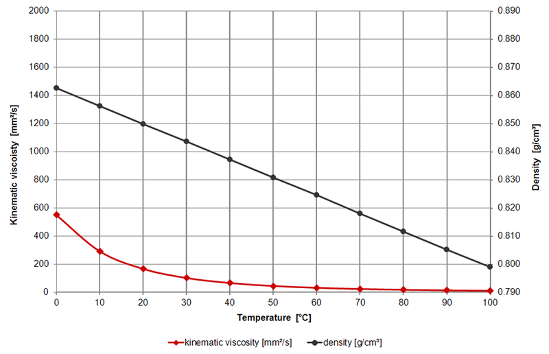

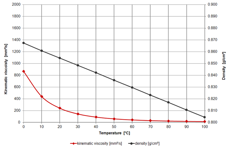

I've attached viscosity diagrams for the two oils.
At startup temperatures, the difference in viscosity is the equivalent of about a 6C difference, so an 0W performs exactly the same way as a 5W would if it were 6C warmer.
I'd be interested to know at what temperature folks were seeing problems. If it only happened on very cold days, and went away on slightly warmer ones, then there could be something in it.
But if an 0W oil really is the answer, everyone would be having problems at -5C, and we're just not seeing that.

True but I’m only going by what I experienced, it ran ok when warmed up a bit, it was around Jan three years ago so probably around 6 degs outside, ran perfectly when changed to 0w

How does it run on 0W when the temperature is 0C? (at 0C, 0W oil will have the same viscosity as 5W oil at 6C).
