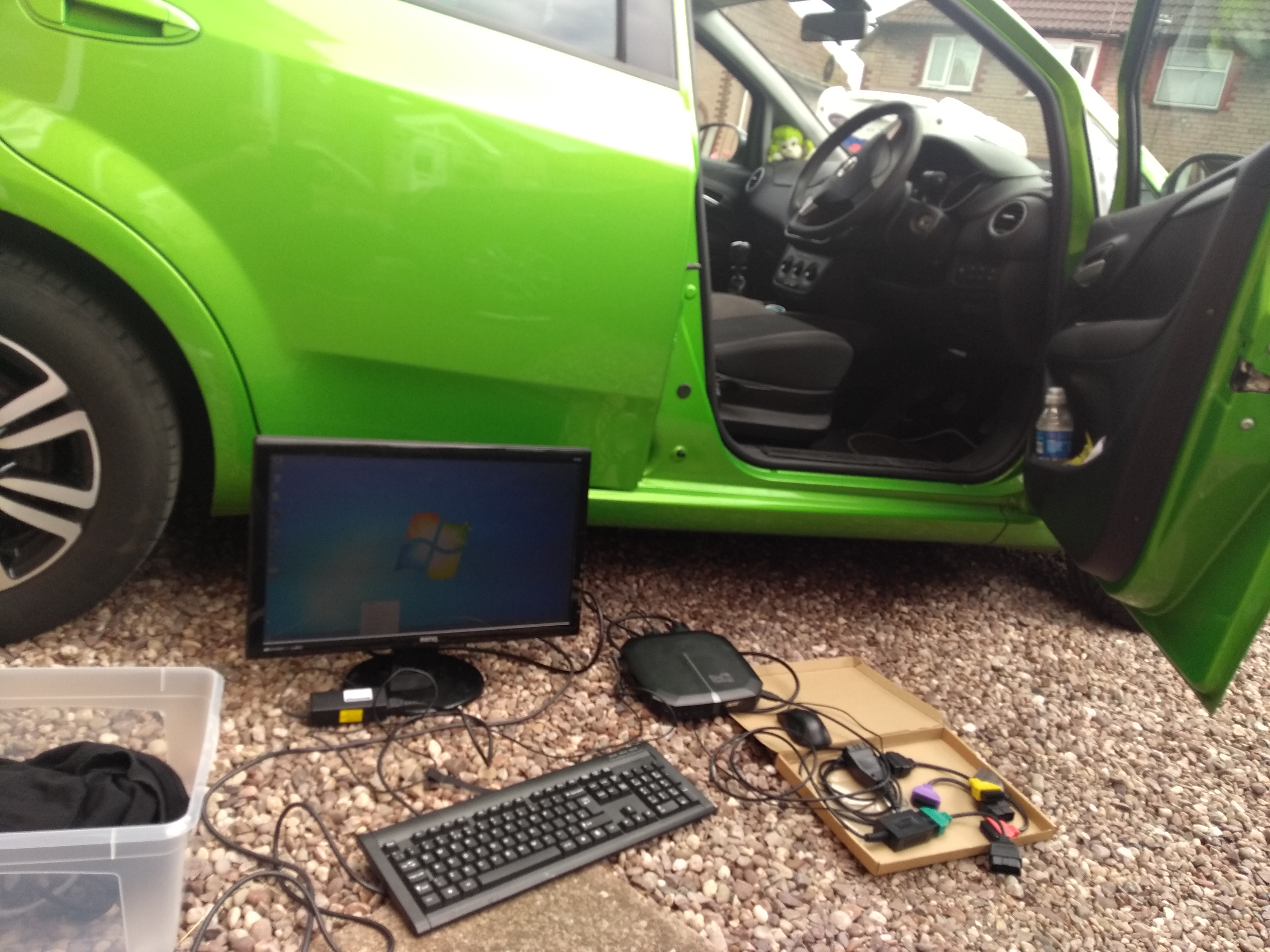

That's better than thinking simulation was read only non licenced version + looking to fix non real codes p068a-86 and b0110-15
Nope the mes free version will not connect to any module on my Punto twin air. It tells me which colour adapter I need but every function ends like this

have to stand on my own two feet :)
Just noticed that the single licence can be transfered to other PCs up to 10 times. "The License Transfer function has a limitation of 1 transfer per month and a total of 10 transfers."
maybe have a go at registering tonight when the kids have settled.

Thanks - yes the methodical approach will be best. Emma has taken the car to work so I won't be doing much tonight. Maybe Saturday I'll get a chance to tinker.
Edit I don't know which ECU is which Hmmm.
Will try and get some pictures as I go as the TA stuff is a bit thin on the ground.
I'll have to get the laptop sorted before I can record stuff on MES - all new to me and have a few codes on the Panda and Punto to see if they re-occur.
Oddley the Panda has never had codes read over the last 104K I've owned it yet the Punto has more codes :eek:
