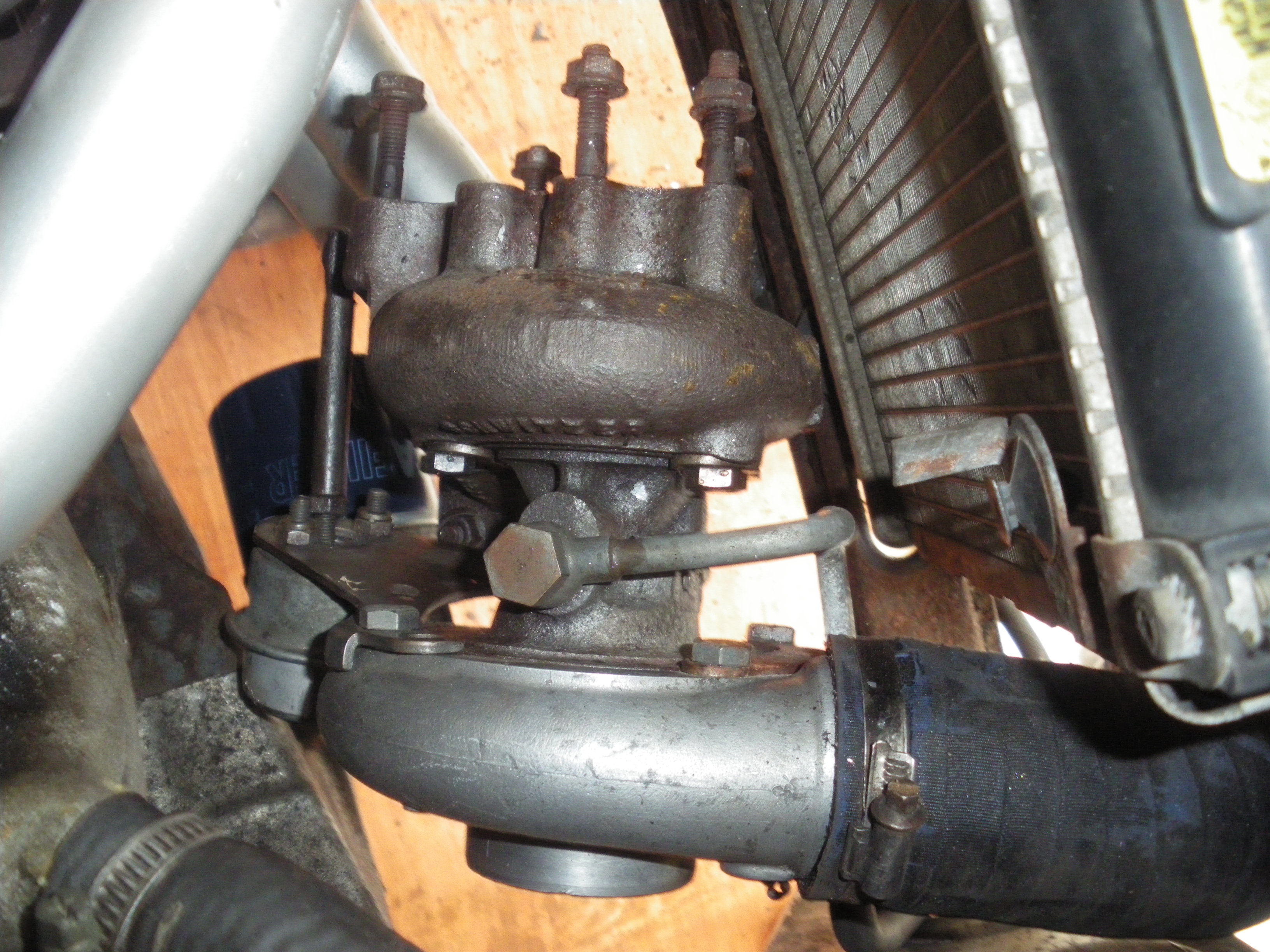

last week I have finish the turbo installation,
what we have done move on the right the water cooler, take off the sandwich plate oil cooler, move the horn

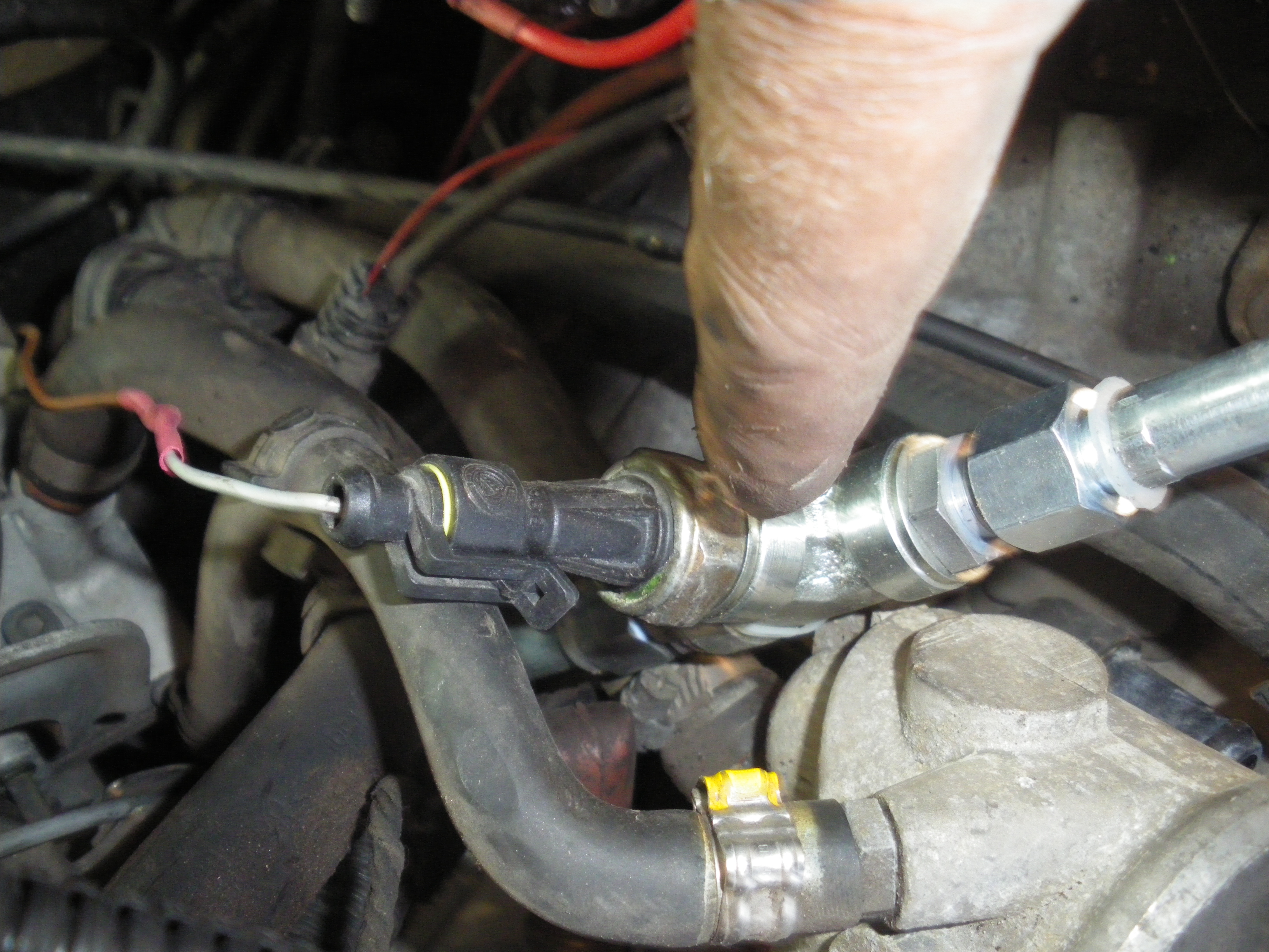

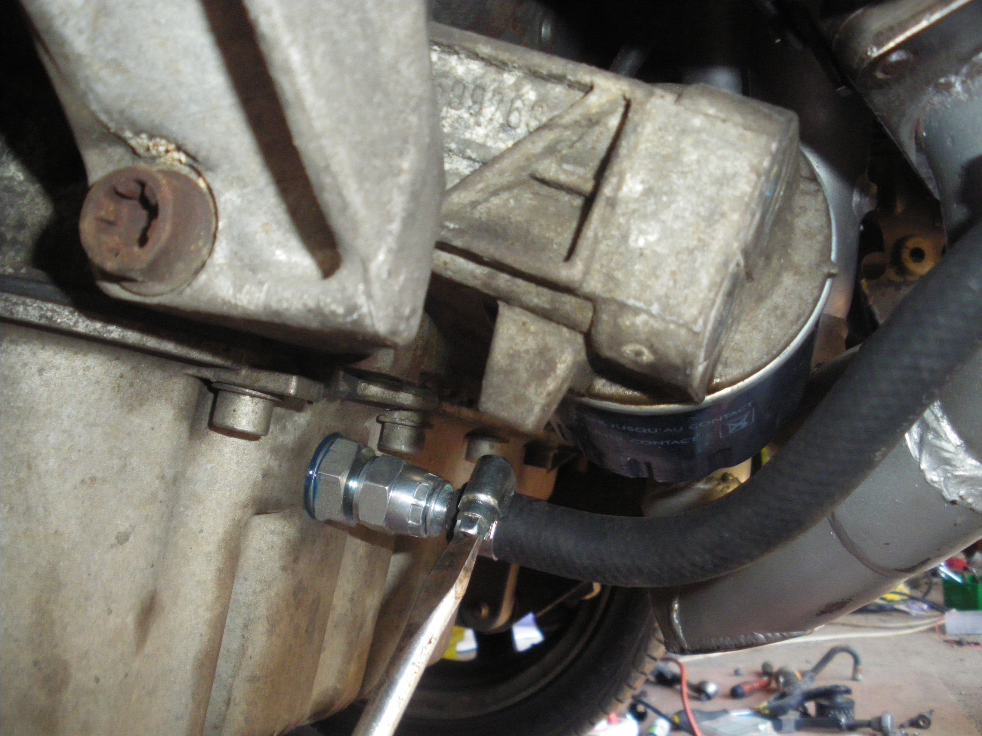

then we were looking for an oil feeding for the tubo intake....so we decide to take off the pressure sensor and move it on a T, then we have to find where to connect the turbo oil return, as we do not have oil filter plate adapter we have drill the oil sump,:p
look at the paint burning
Hey! Nice one!:D
Great work and looking good!
Is the engine up and running then.
Make sure you have a bigger diameter exhaust pipe as the original may cause issues and sure you will need bigger CC injectors to get the power up.
Again, A high flow fuel pump and regulator will help and make the tuning easier.
If you've kept the same compression ratios, then no more boost than 0.4bar and you should be OK!
Looking forward to seeing and hearing more. (y)
Hiya! Hows the Turbo build going?
I was looking back at some threads and remember that placing the air filter in a better position and shielding it from the hot manifold helped.
The maf sensor may play up in the position you have it now, so make sure the manifold has a shield or some wrap around it. (y)
