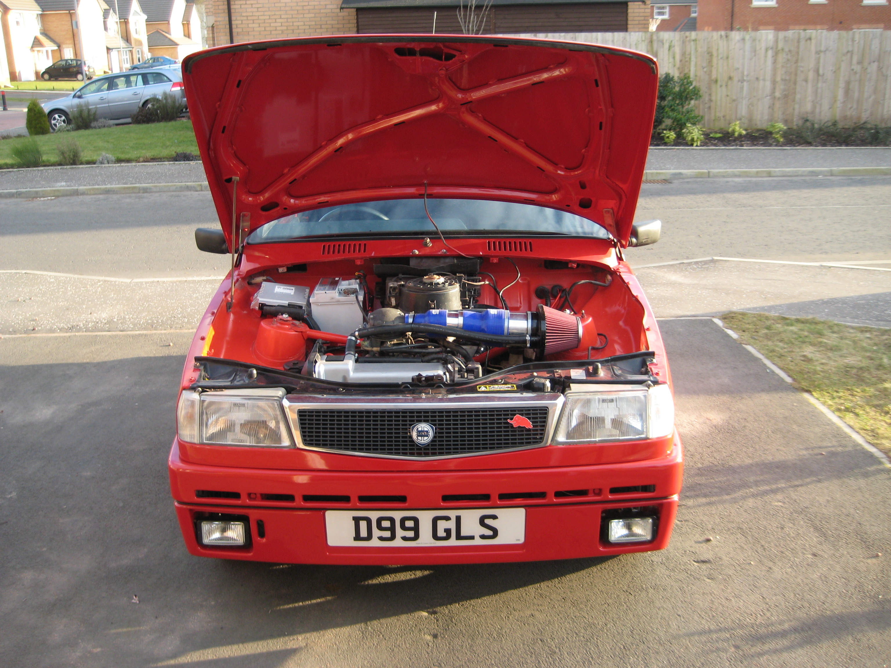

It is currently running with a K&N 57i induction kit that has been adapted so that more cold air can get to the filter and also to get the bonnet closed (see below)

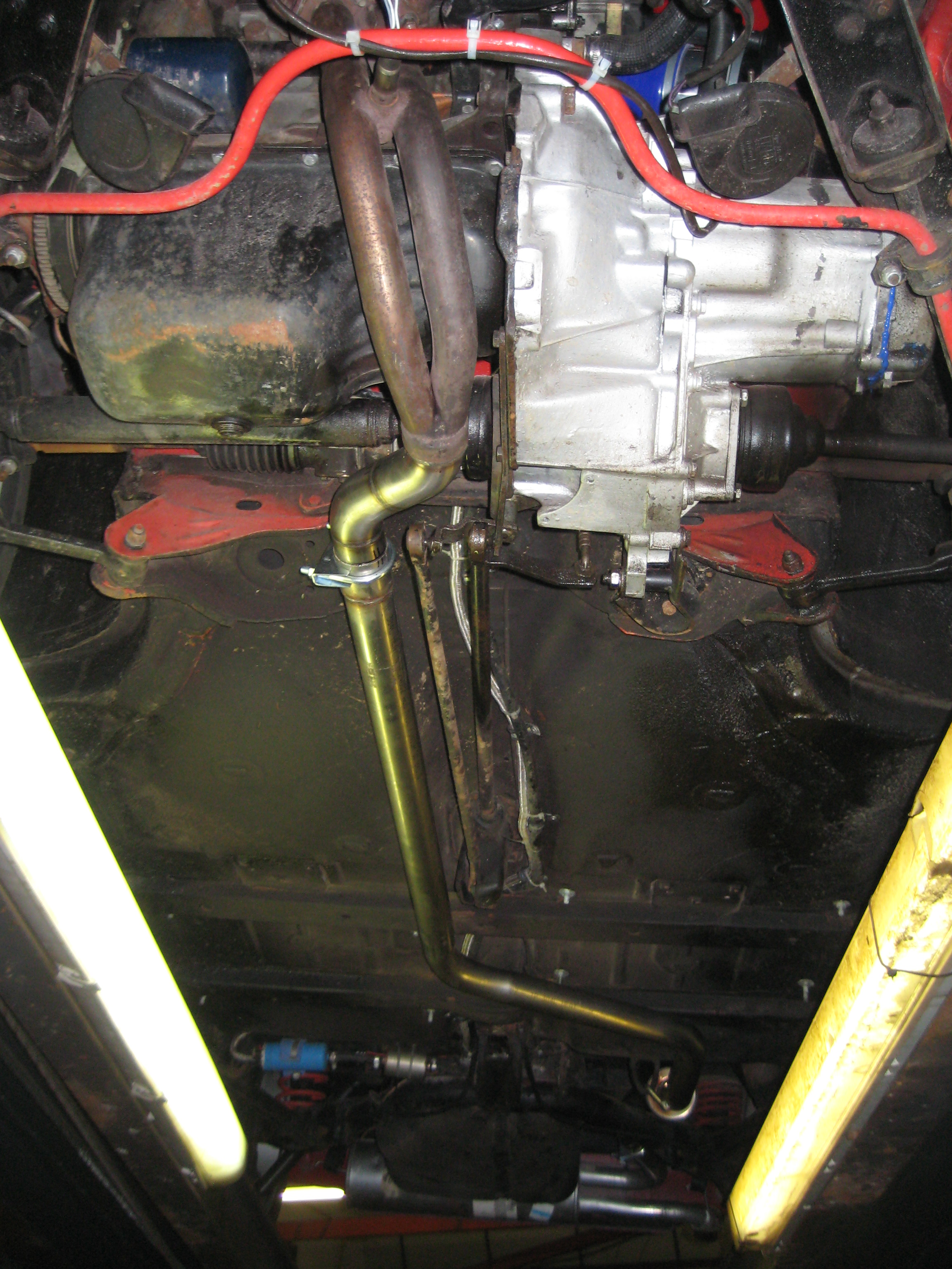

It now also has a custom stainless steet exhaust that got fitted last week. Bonus of no cat as the car is a 1987.
