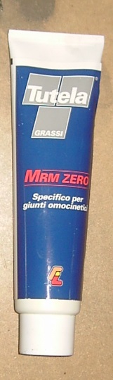

I couldn't find MRM ZERO for the tripod joints on my Stilo.
It's made by Petronas, so I phoned them and they gave me a list of stockists here in the UK. Perhaps they can tell you stockists in Greece. Here's one company you could try: http://www.condellispaul.gr/brand.aspx?id=9
I'll try to contact them thanks.
Although Fiat now use tutela star 700 on all later cars.
