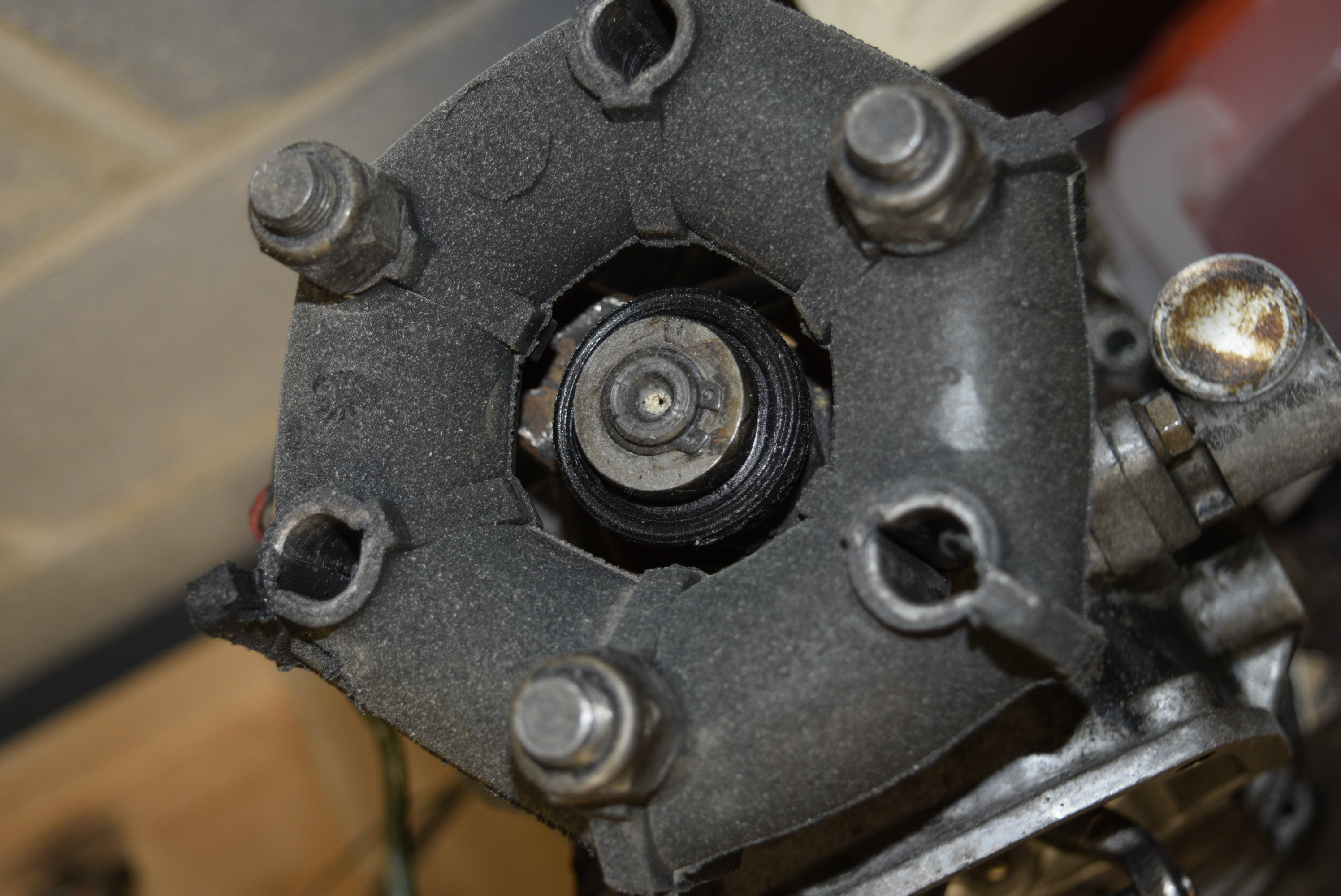

2. To loosen the large nut on the output shaft (rear of gearbox at rubber doughnut coupling) and the bolt on the front of the layshaft (2nd motion shaft ), visible when the bellhousing is removed, - engage 2 gears at once to lock the gear shafts. This can be done by first engaging any forward gear, then remove the 10mm headed pinch bolt from another selector fork and engage another forward gear.

You hit the nail on the head with your tip about removing the donut. I was just going to post and ask for suggestions.

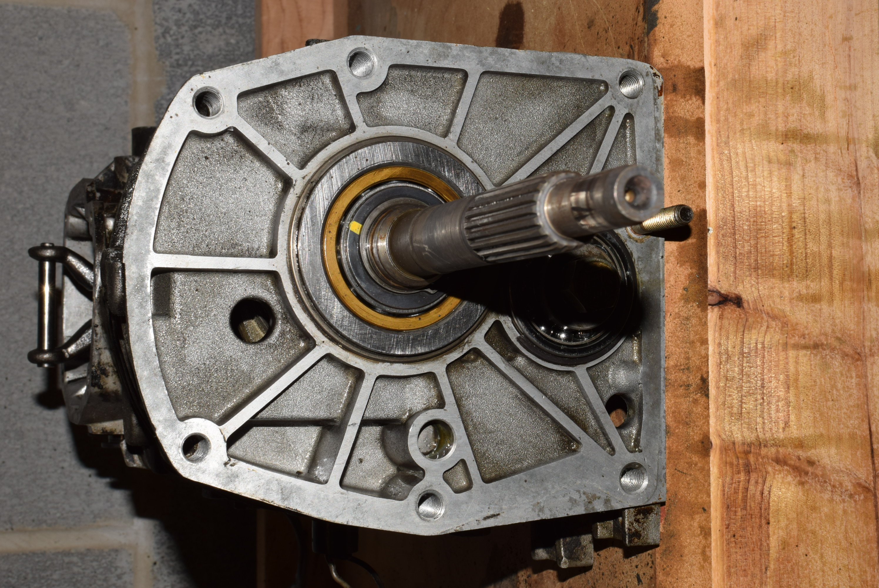

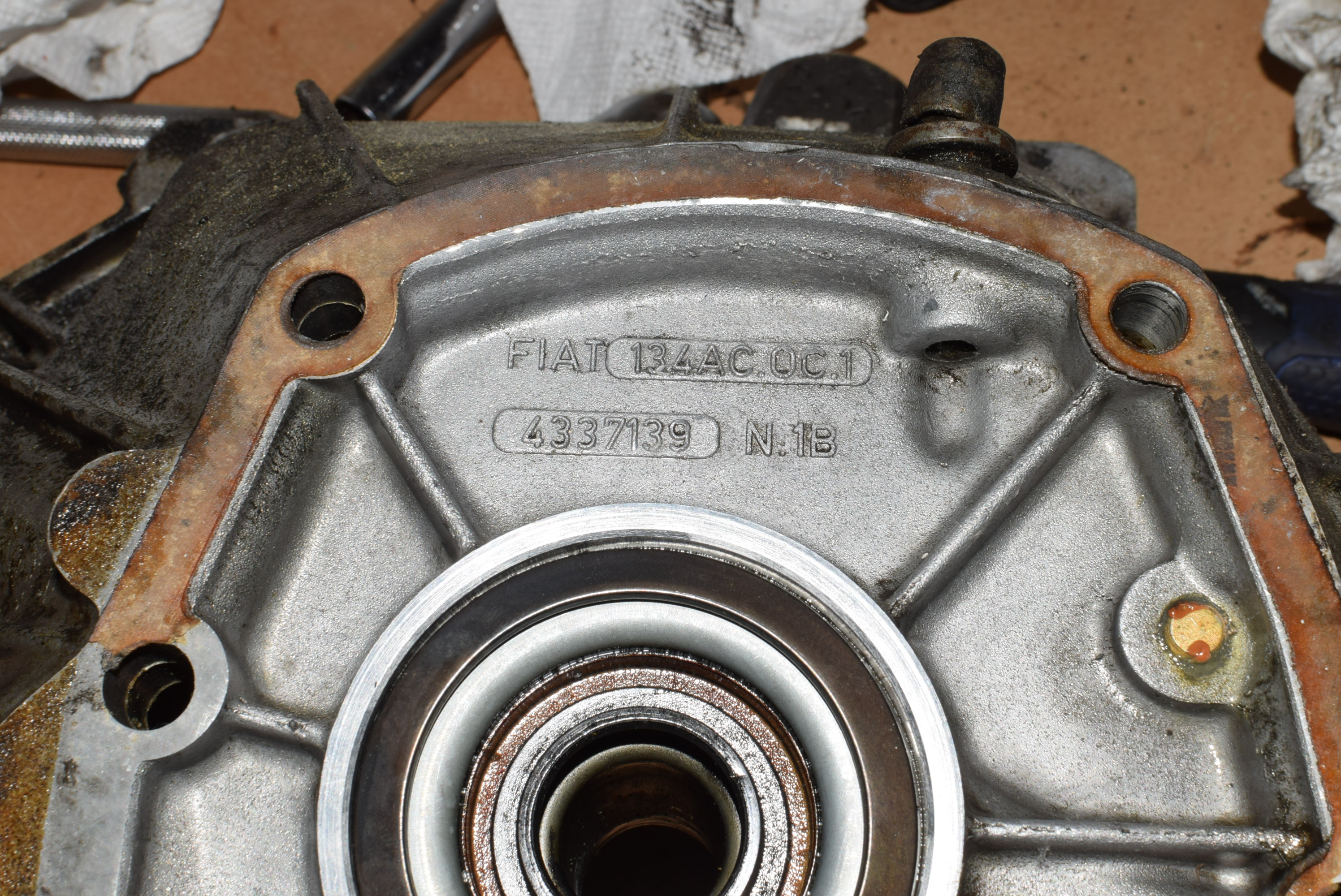

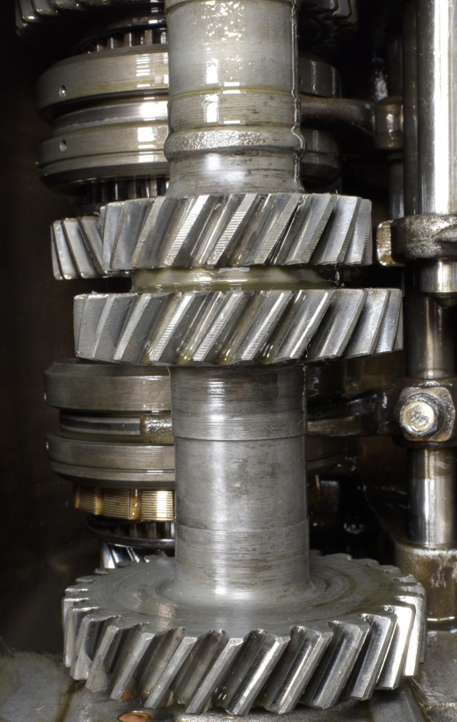

Just needed an impact wrench. A few more photos after removing the bell housing
What's the best way to take off the round spacer on the output shaft?
Re: Transmission Rebuild - How to Remove Spacer
Any suggestions for removing the round spacer on the output shaft? I don't want o damage it with a wrench..appears to be screwed on. Here's a picture.
No answers, i hop you got it off by now.
What i did is is pried it off using two bars on resting on one of the three eyelets and the other wedged under the spacer after that i alternated the prying one lob at a time, this will kill the rubber bushing behind it.
The spacer is NOT screw on it is a very tight fit.
