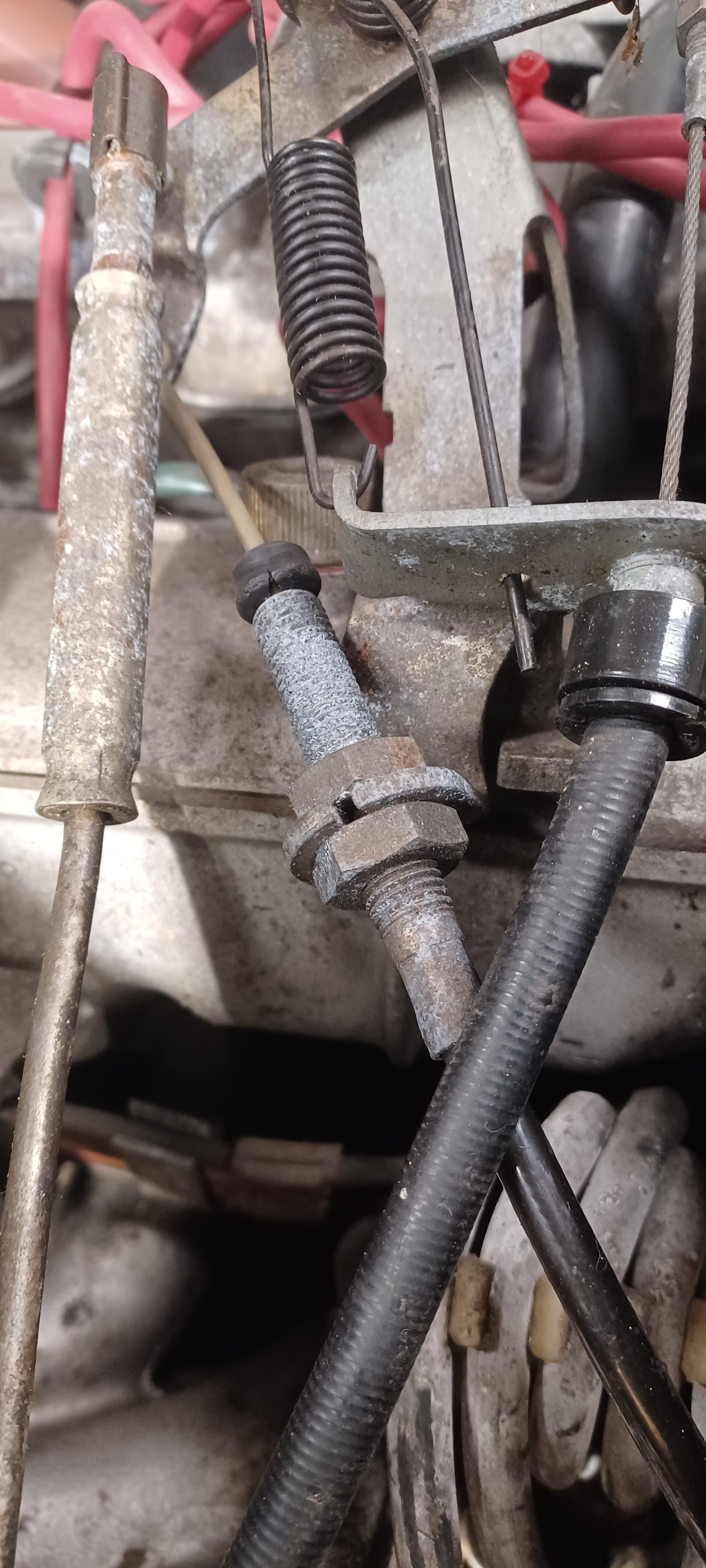

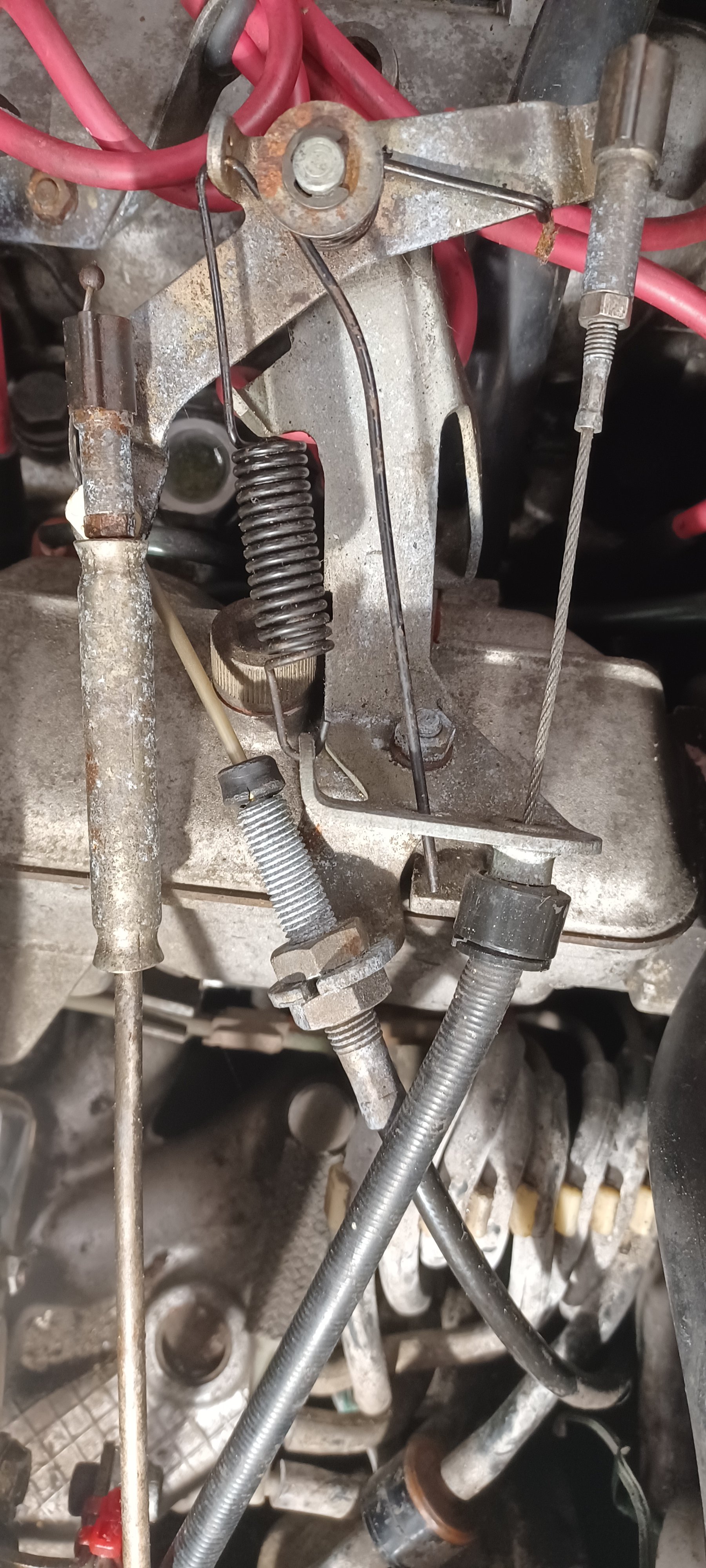

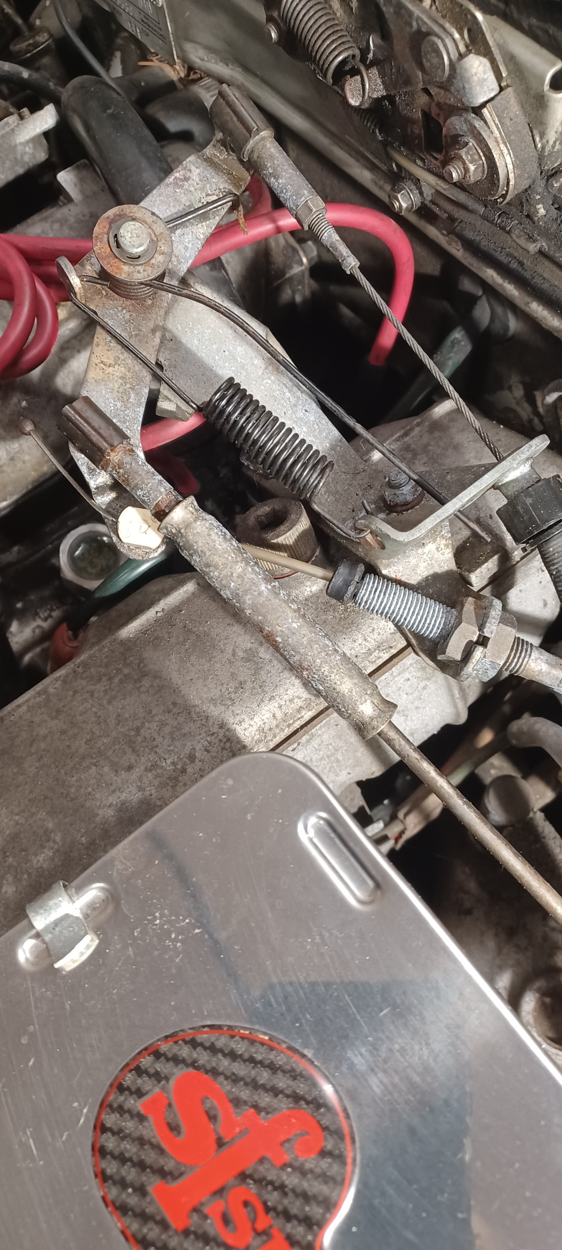

I'm looking for information about the kickdown cable bracket on my 1979 124 spider. I'm converting to automatic and need the bracket, or at least pictures. Can anyone help?

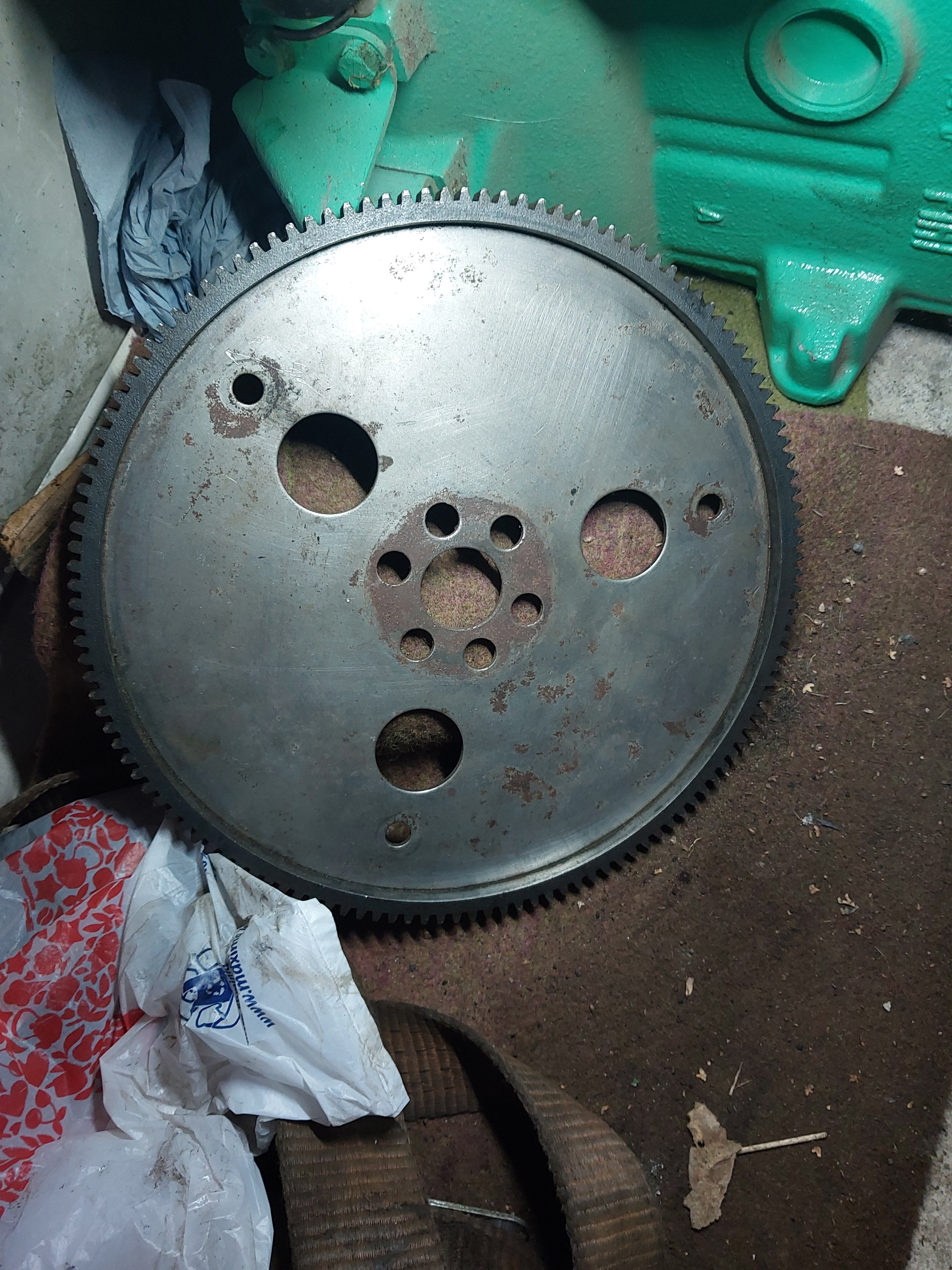

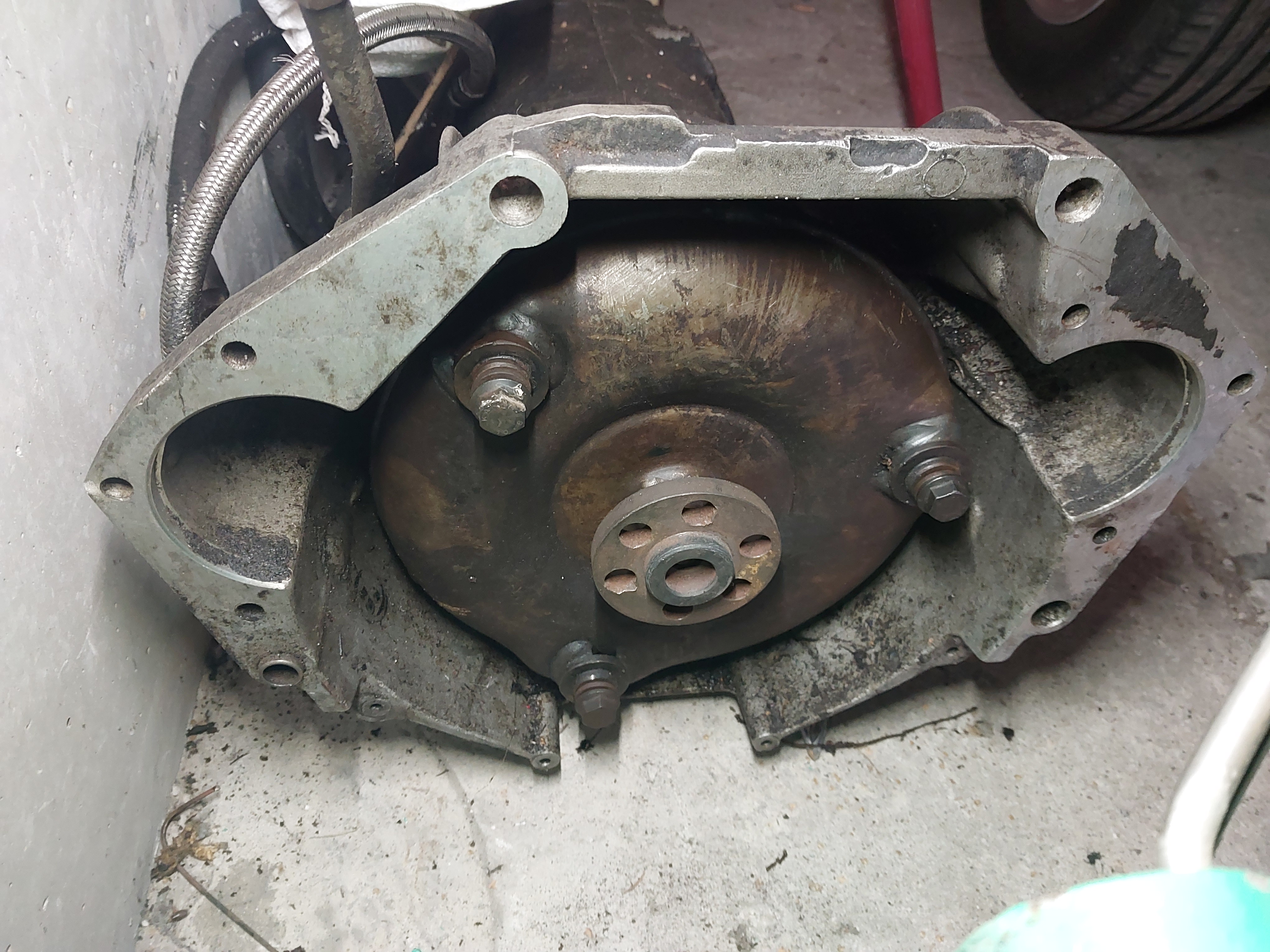

I have the same project with classic Lada 2107. Project is a realized. With correct bellhousing you need special flywheel and hub( use crankshaft bearing place). Also, automatic transmission longer then Standart, and need shorter cardan shaft( about 150-170 mm, forgotten this different)

sorry but sometimes I am a bit slow, can you explain this part "With correct bellhousing you need special flywheel and hub( use crankshaft bearing place)." to me? I haven't looked at my crankshaft bolts yet of my fiat 131 engine. you are saying that those are M12?
And where did you get your flywheel (flexplate) from or which one have you used?

Another question for your automatic transmission experts.
Is the kickdown cable arrangement fully watertight?
I go through some puddles at times.
This transmission is widely availavle all over the globe.
In australia it is called trimatic, and in europe mostly TH180. In north america 3L30.
the fiat bellhousing only fits the 3L30 without lockup converter.
The newer one with lockup converter has a differrent channel layout and the bellhousing will not function.
It needs to be an old transmission with no lock-up to function with the fiat bellhousing

I bought my fllywheel from ebay USA, my transmission from kleinanzeigen germany, two came in a bundle and were 50€ combined.
They are callled Opel CIH automatikgetriebe there. the type is GM 3L30, TH180 or trimatic in australia.
My bellhousing came from www.midwest-bayless.com.
It is important to buy a 3L30 TH180 without lockup, the bellhousing is differrent between the two versions.
