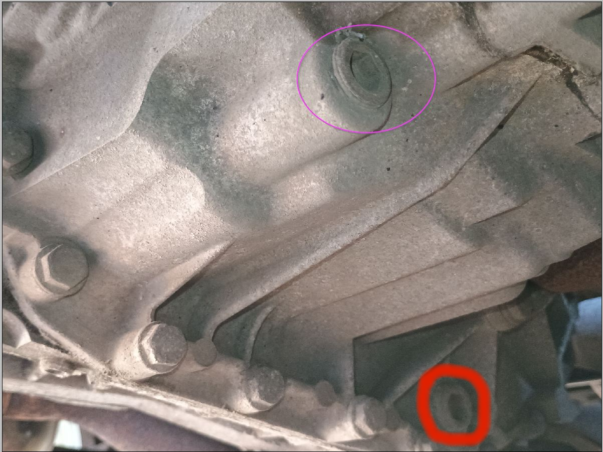

Hi, just checking if I've found the drain and filler plugs on my 2016 Tipo. It's the 5 speed box on the 1.3 multijet.
Would this be the C510 gearbox?

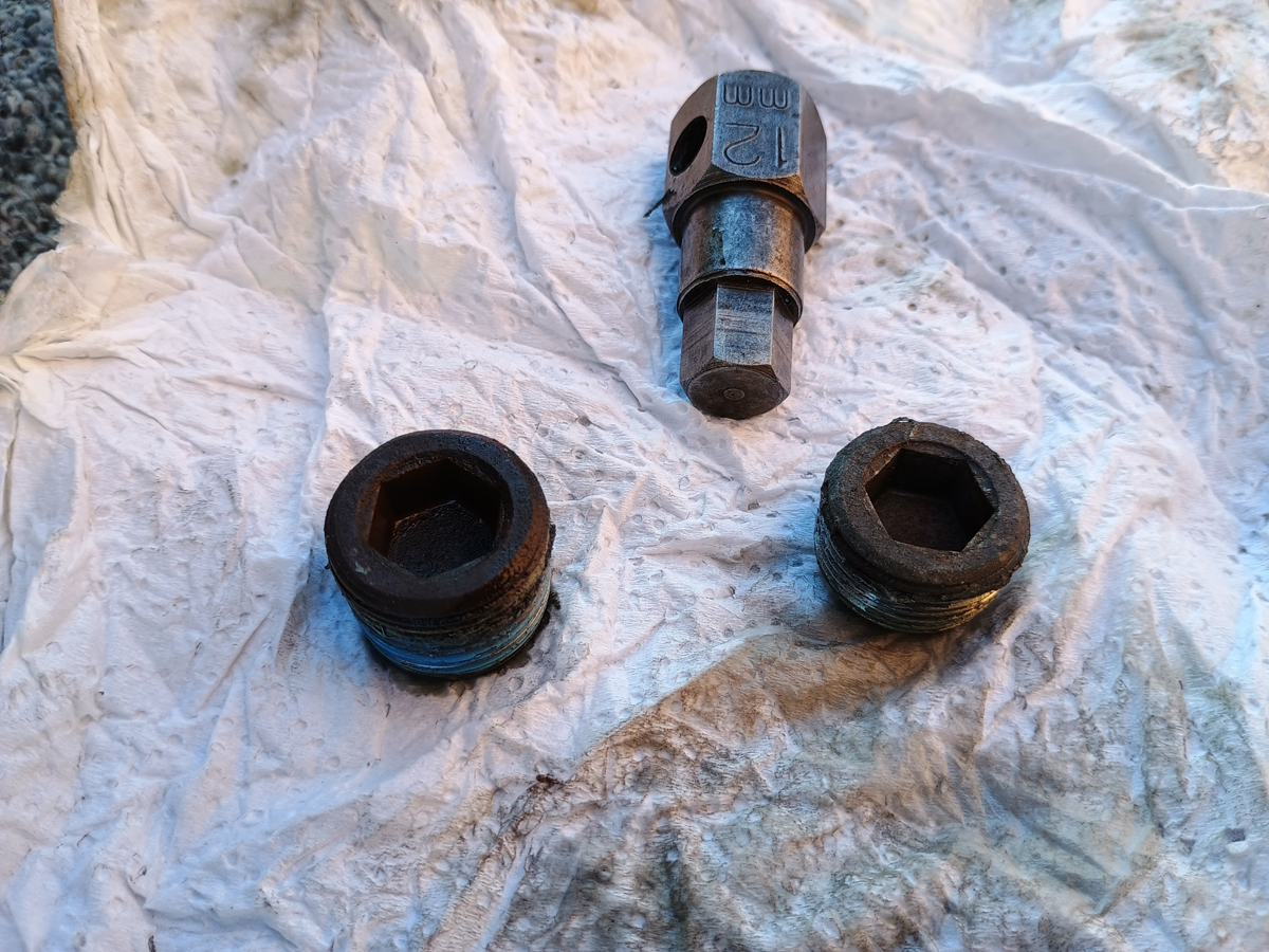

Both are hex plugs 12mm

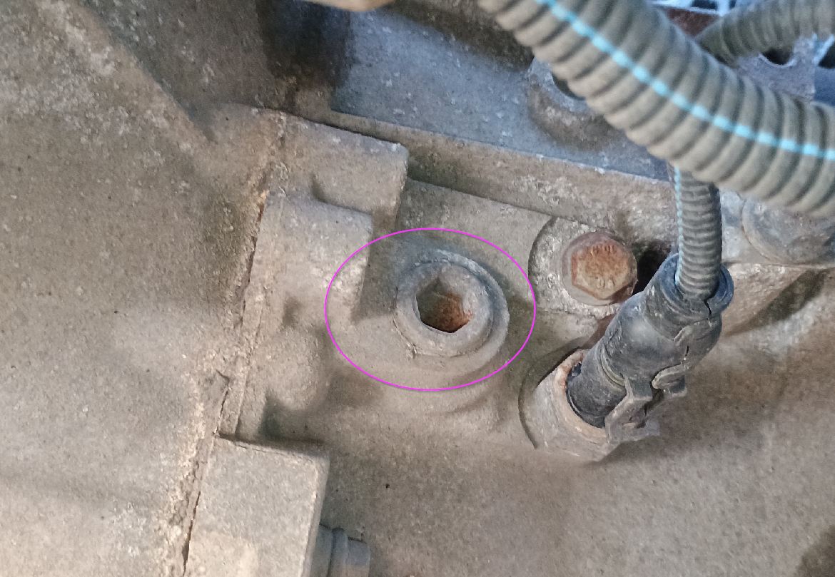

Front of box - filler?
Side of box - drain?

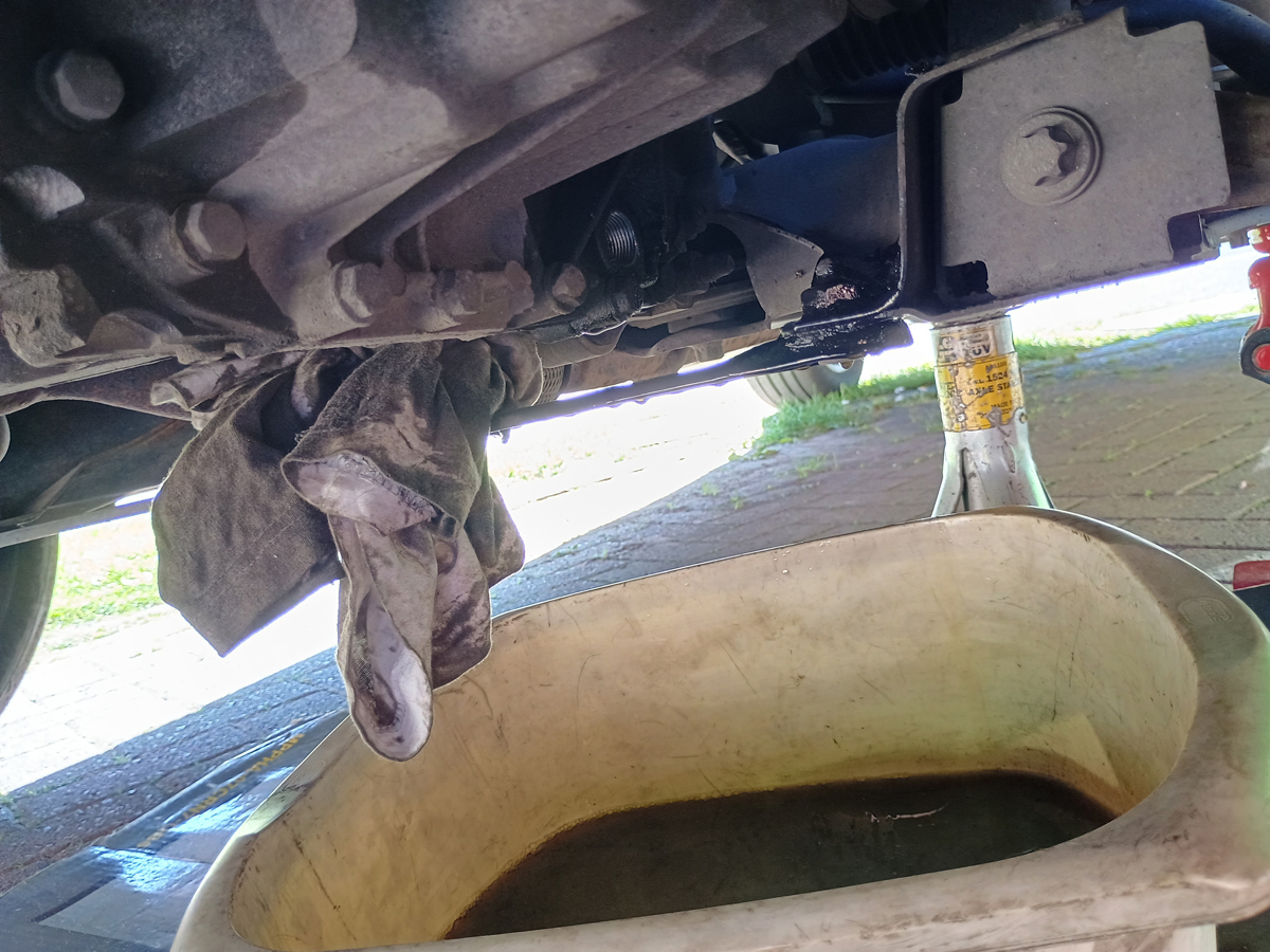

Similar locations to other FIAT boxes I replaced the transmission oil in, but worth checking what's behind the plug before removing it on a gearbox.
Millage is around 81K and probably on original oil but it's not mentioned in the service schedule in owner’s handbook... after searching the digital Haynes manual I see they now list this oil change under Transmission / Differential and I'm right on schedule… but no pictures / diagrams of where the plugs are on my car
