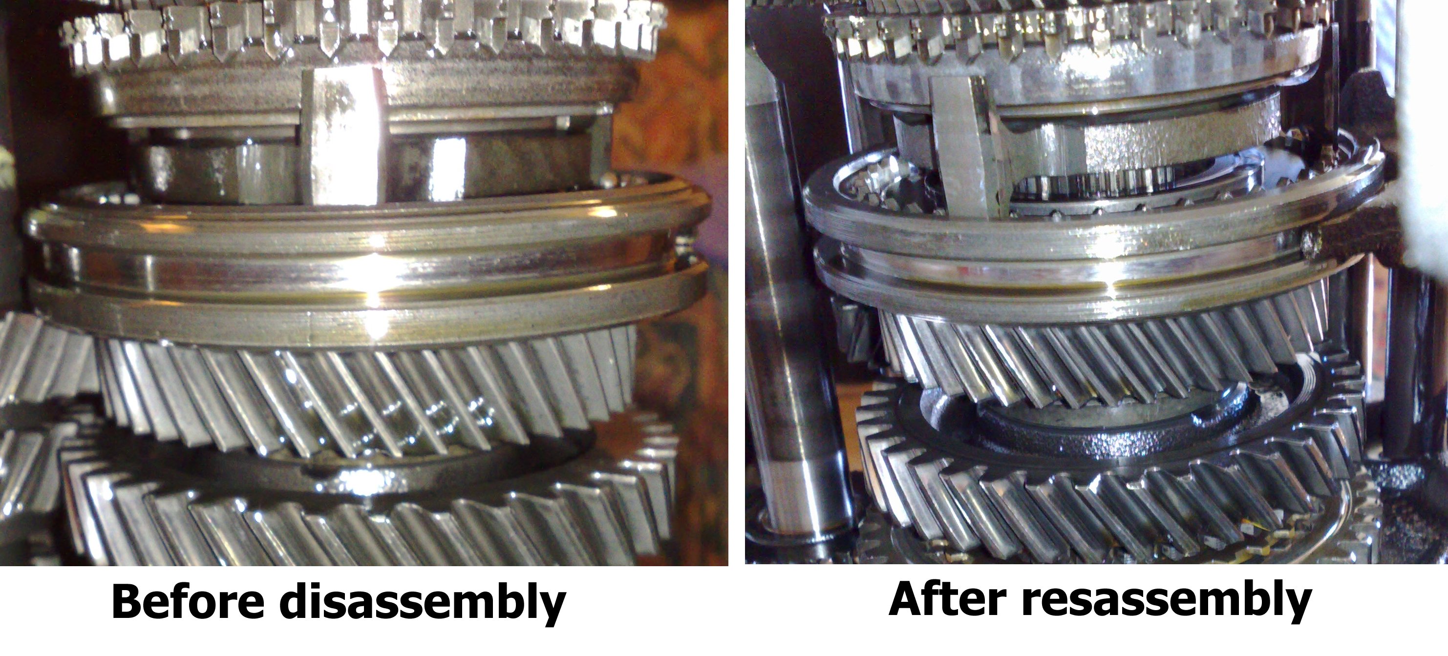

Things left to do, refit starter, attach rear mount, put the jubilee on the inner driveshaft gaitor, put the hub & ball joint nuts on, fill with oil, then see if it works... :woot:
One more thing to mention... arent digital cameraphones handy? :D

Got it all done just now, it started up, no whiring... selected 1st... went in fine, no noise... 2nd... fine, no noise... 3rd.... nothing... :mad:
4th, 5th & reverse are all fine too, no noise, but absolutely nothing in 3rd... it selects the same as the rest, but theres no drive at all.
The gear lever seems further to the left in the car, but it wasnt removed, which is a bit odd, maybe the new mounts have moved it?
Any ideas? :(:cry::bang:
Interesting...
The fact that 1st and 5th select normally suggests, to me, that the mountings and gearchange linkages are all within tolerance.
It must be a problem with the third gear assembly itself? Some sort of toothed ring left out or reversed? I know this is maddening to have to take it all apart again, but no-one ever said gearboxes were easy... :) think of it as a Sudoku puzzle, but with a more useful outcome... Good luck!

Interesting...

I didnt leave anything out, a reversed part is a possibility, but unlikely as I dont think the gears would sit right in the casing if I`d done that, plus they wouldnt mesh properly with the other shafts, which, I think would mean most of the gears wouldnt work?
The other thing I`m thinking about is the syncro bit with the 3 springs & 3 pads, that gear clicked down over them when I reassembled the gear set, I`m wondering if I was suposed to position that differently, thing is its not covered in any of the manuals, so I dont know.
I took numerous pictures before, during & after reassembly & the gear sets look the same, as does everything else, I`ve looked at them over & over again, as well as the relevant eper pictures & I`m still at a loss... I`m pretty sure something somewhere inside isnt aligned properly, I just cant work out what. :(
I`ve driven her a few times since finishing, & other than 3rd missing & the gear positions being out , she`s driving better than before, quiet & smooth, including the syncro during quick changes.
