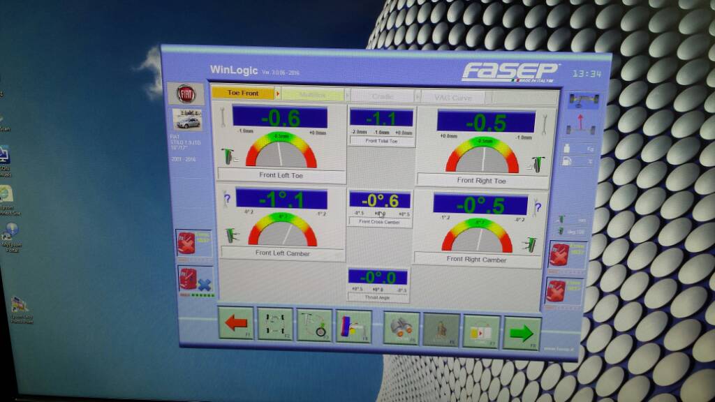

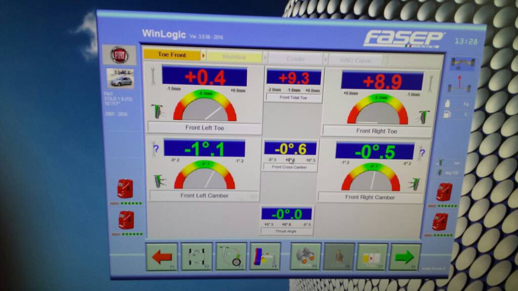

Had tracking done last week with new wheels fitted.
Feels much better but still pulls to the right a little, not as bad as before.
Im going back tomorrow to get it re-done as the steering wheel is off slightly.
Ive attached pics of the before and after when i had it done last week, it was way out!

Its the Camber difference that makes your Stilo pull to the right.

it'll have been that massive toe on the right hand side that was making it feel like crap mate.
There is no camber adjustment, no. Plus, if you look at it they're green anyway, so they're within spec.
You might find that if the toe has been out it's unevenly worn the tyre scrubbing the inner edge which is giving you a bit of camber (some lean in the tyre).
I doubt you'll be really feeling such little camber though mate.

Ok... so ive had it redone today, didnt bother taking pics, front offside was showing as +1.6 !! Which means they didnt do it right before... its now bang on -0.5 on both sides... steering wheel is nice and straight again.
Drives nice and straight but pulls to the right under boost...
As a test, driving uphill i throw the car to the left whilst under boost and it straightens up then shoots off to the right... it feels more like torque steer.. if im tootling along it feels ok and i no longer have to hold the wheel... but under boost its a different story.
Handling feels much more poised and twitchier, more of a true feeling rather than a soft numb feeling like before... it feels more planted and gives me more confidence..m the car is handling and talking to me now :) - thats was one big bug bear for me with this stilo!

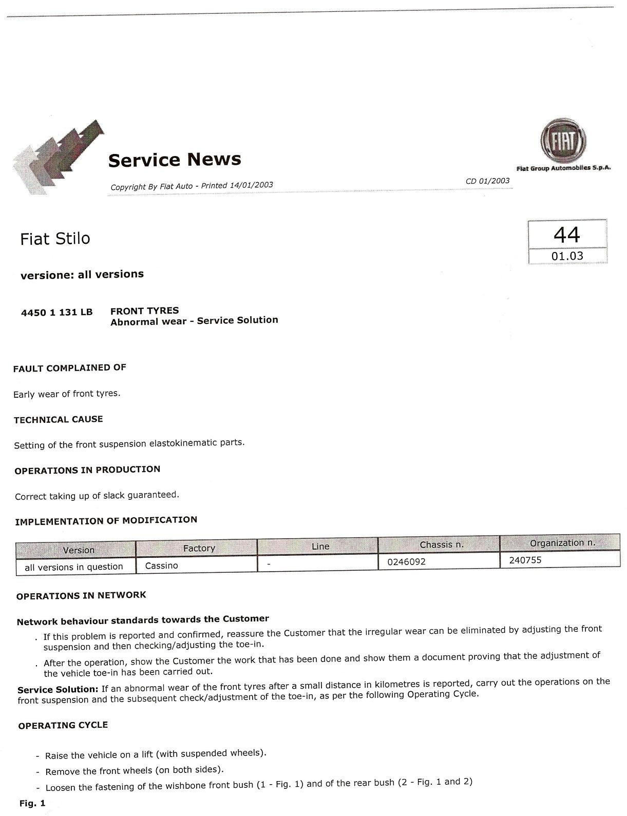

Yes.... Fiat originally specified front wheel toe in as -1°. The eLEARN manual, and possibly specifications held by garages, still show that.
It was changed to 0° by a service bulletin issued in January 2003.
Thanks for posting this - I will take a print out of this along to the garage with me.
The fasep system was saying -0.5mm - not +0.0
+0.0 shows as too much toe on the machine.
