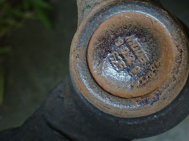

Found the perfect part. Took some research. It's listed for a fiat bumpy. Strange that it didn't come up on a number plate search at euro car parts /gsf
