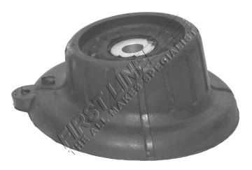

Hi can any one show me or tell me what its a called lol I'm doing my springs and I keep finding the rubber strut mount but I would like to get all the top of the strut as I have a rattle I'm new to haven a fiat and don't know what the set up is like and I would like to get it all before I pull it all apart thanks. Its 192 115hp jtd :bang::bang:
Hi, Welcome to the FF,

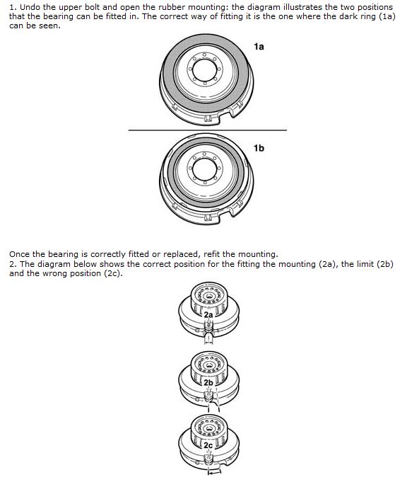

It's known as the top strut mounting and comprises of 3 separate parts, the top rubber, a metal roller bearing ring and the bottom rubber. Fiat only supply it as the top rubber and the bottom rubber with the bearing ring attached. Other suppliers supply it as separate parts.
When reassembling the parts, cutouts in the 2 rubber parts must be aligned correctly as in the diagram below.

Thank you Iv order the top rubber and I did see the other part on eBay thank you
