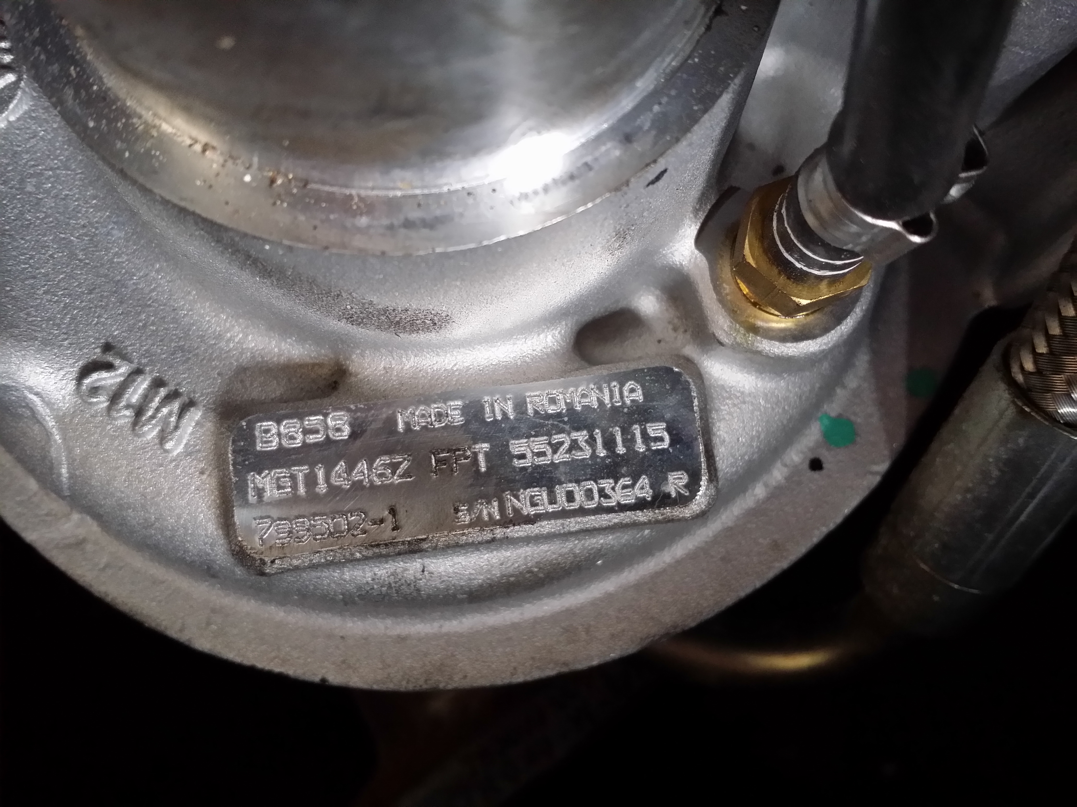

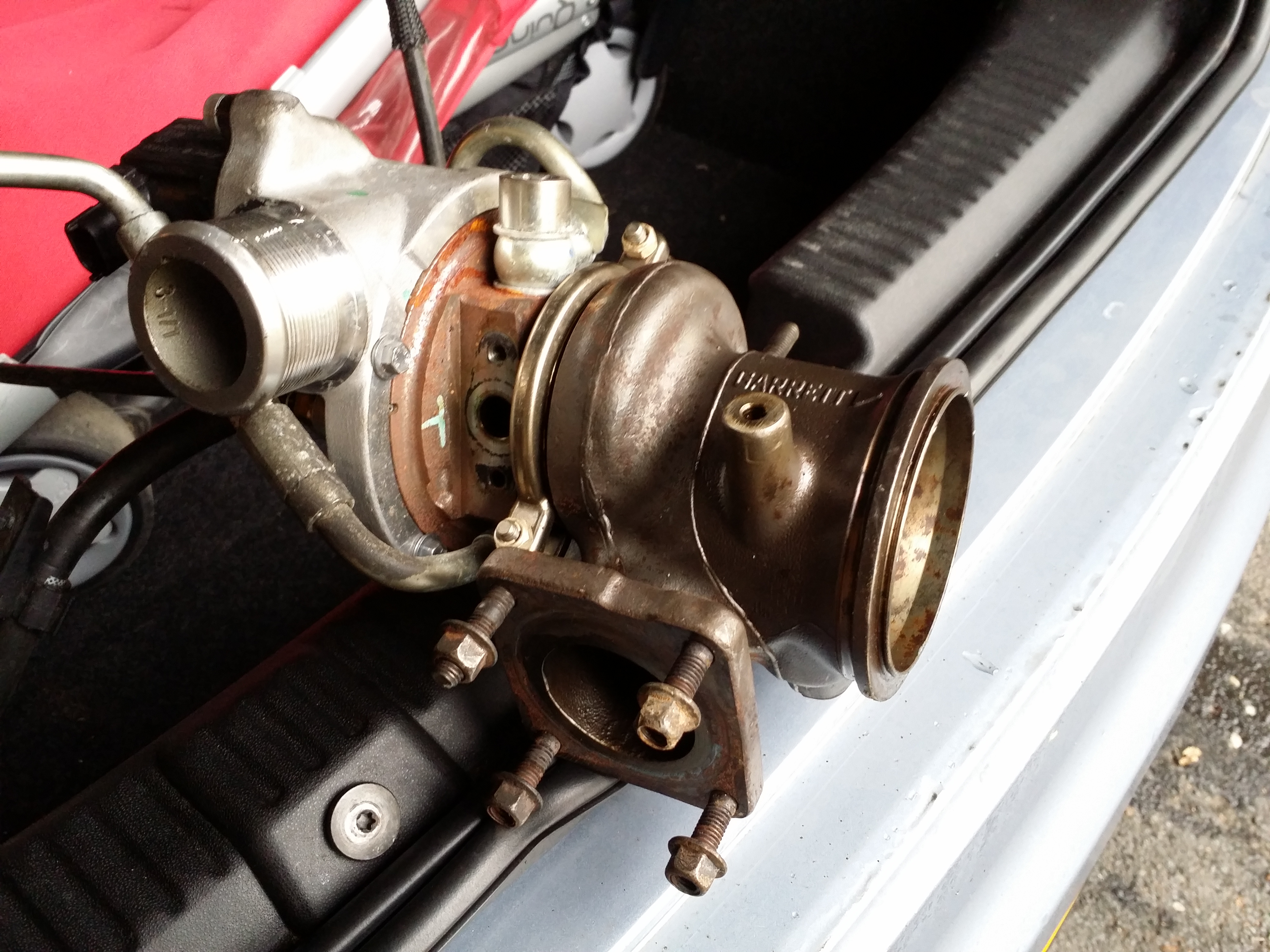

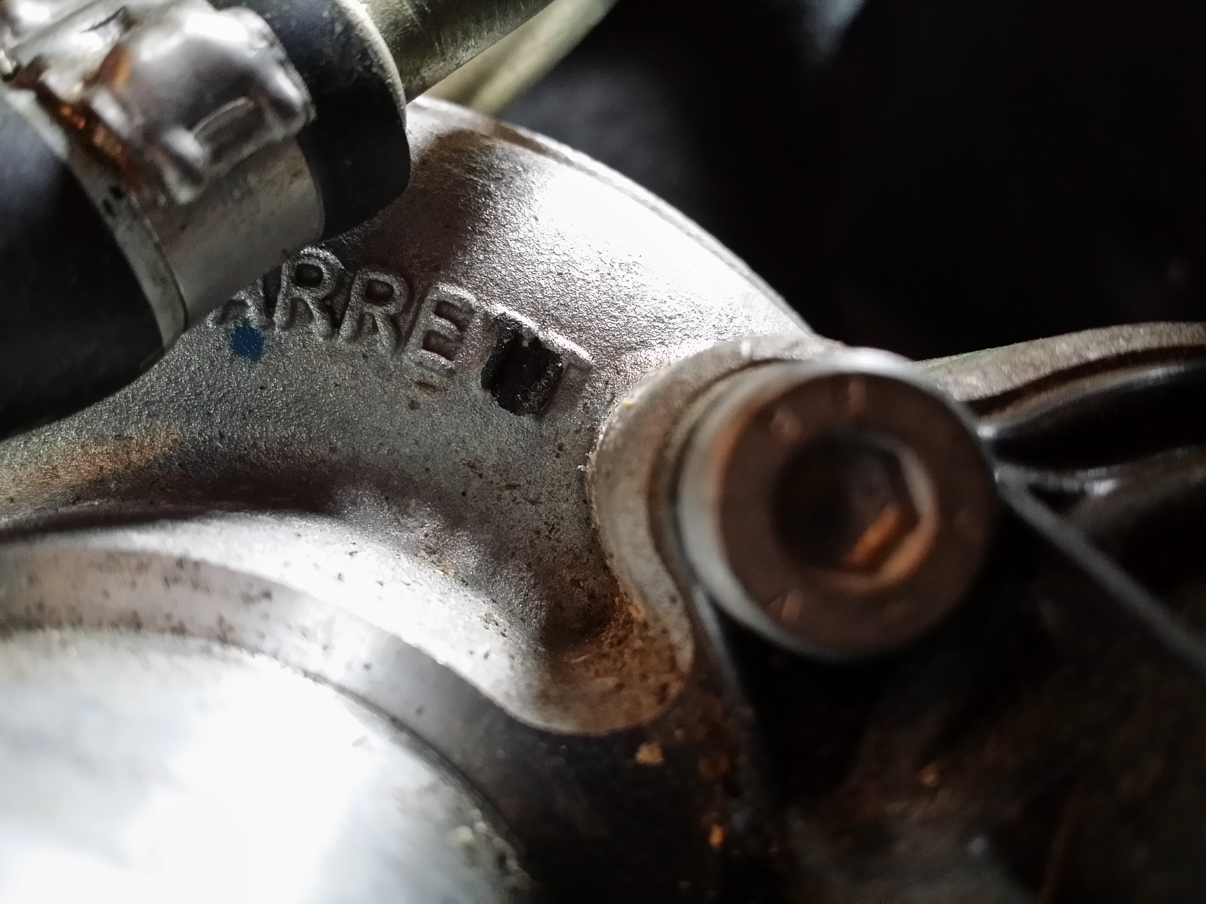

The other day I bought a 500 Abarth turbo - assumed it was a VL36/ VL38 and that I could just swap my turbos over!
What turned up, turned out to be a MUCH larger Garrett turbo.
GARRETT 55231115 is what's on the turbo. Quick google says it's from an Alfa Romeo TB170!
What Abarth 500 ran this turbo !?!?! The breaker is 100% convinced it's a 500 Abarth and he also has other Abarth 500 parts for sale.
Any help with this is much appreciated!

Well I've looked at the essesse kit features an exhaust manifold and oil feed pipes at the very least. Then I've got to look at the wastegate actuator which appears to have a large black connector attached to it which isn't present on the standard one.
It doesn't look an easy task.

The main difference is the turbo but the 150 turbo will bolt on with no issues at all.
This a much larger turbo, and is it designed for the MultiAir engine rather than the T-jet which is where I think I may struggle.
A quick chat with TMC autosport tomorrow should sort me out!
