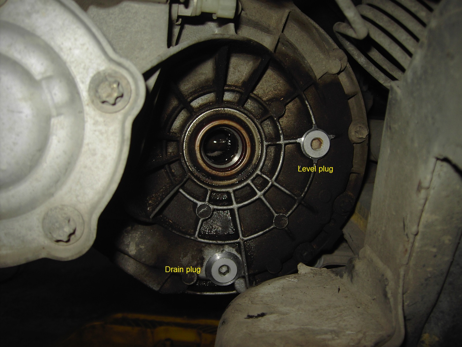

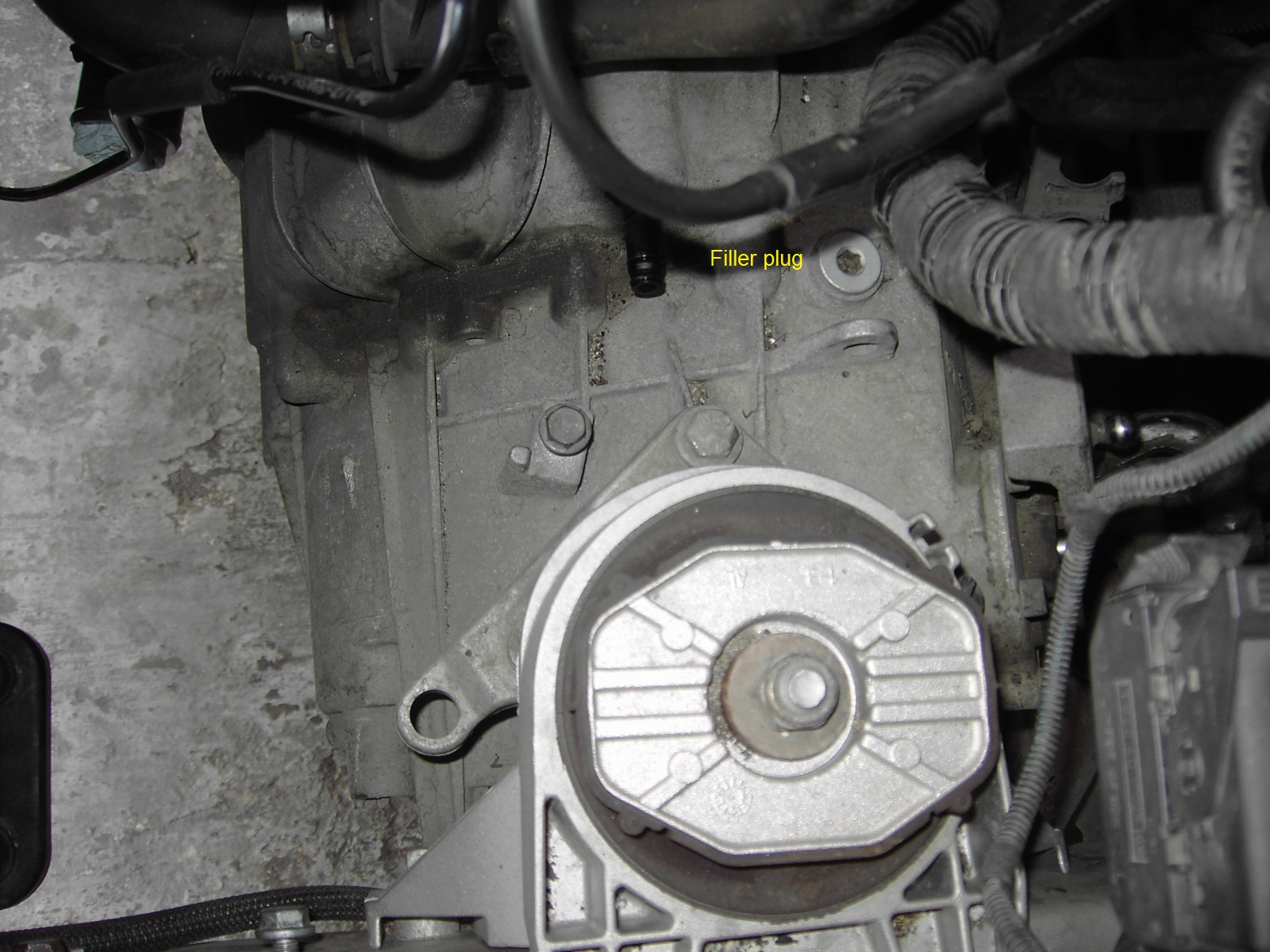

There are 3 oil plugs in the gearbox. Which ones are you using?

I noticed that one on top, but I wasn't sure it is filling hole. I used two holes on the side, like on your first picture.
