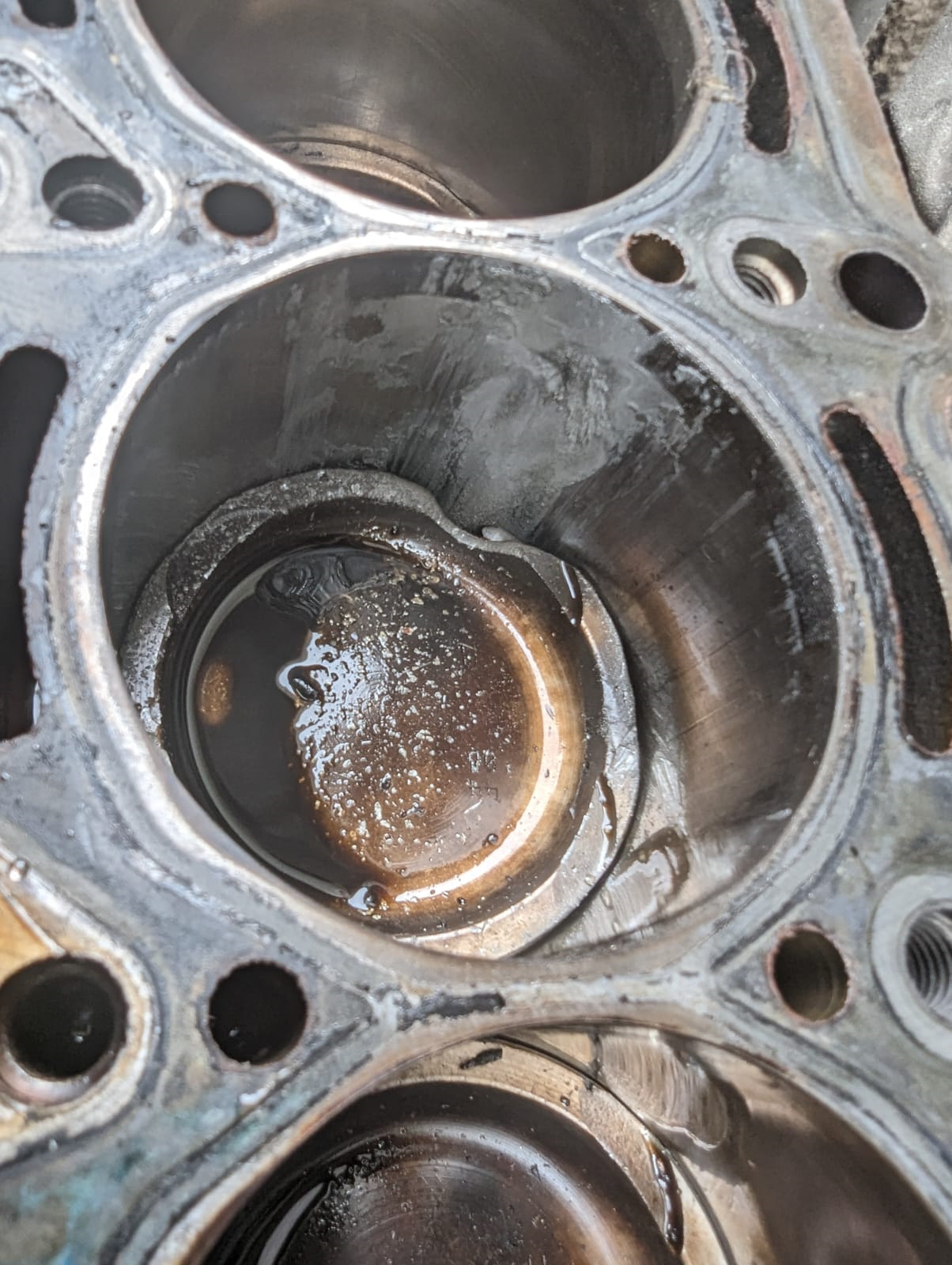

Popped all the spark plugs out , one spark plug tip is broken , possibly entered into combustion chamber damaging piston,wall or valves. Tried new plugs still misfiring.
My mechanic is gonna call me tomorrow morning and tell me the damage. My question is why did this happen? Bad fuel quality ? Bad injector ? Coils ? Spark Plugs ? Should i replace all these things after rebuild?
I have the car for 10.000kms not a single issue. Engine was running smooth till yesterday. No codes , no overheating , nothing. A small metal piece possibly killed my engine.

First off thanks for your reply.
Yes, the ground electrode looks melted. So i assume the cause is heat.
Running too lean? Wouldn't that affect the other plugs too?
Plugs were changed approximately 19.000km before. Torque down to spec. I used to replace them every 20-22.000km.
Unfortunately i have very bad news. The engine is done. Needs a rebuild or new engine. The damage is big.
A rebuild would cost me around 1.3k euros and a new engine which my mechanic found will cost me 1.6-1.7k . New engine is from Mito with the 155bhp. Only 39000km on the clock. Seller sent me a proof video of the engine working, idling aswell as revving it. Sounds healthy.
I think i will go with the new engine. Can't risk the rebuild.

A plug that was not tightened down properly would run hot immediately, so I would expect a failure much sooner.
Normally a weak mixture would be highlighted by the oxygen sensor, and the ECU would richen that cylinder to compensate. If unable to do so, should illuminate the engine management light, and store a code. An injector blockage or fault that gave less fuel than required should give the same results.
An air leak into the inlet, after the flow sensor, will cause weak mixtures, but again the ECU should be trying to overfuel it to compensate. I would expect a stored fault code.
I see you are going with a replacement used engine, which is the option I'd go for. I'm surprised at the cost, you have my sympathy.
How do the other plugs look? If they all look a bit distressed, that could indicate a general air leak. If the others are all good, an air leak on an individual cylinder, or an injector fault, need to be checked. You don't want to move the cause onto the replacement engine.
With melted plugs or pistons, often there is only one, as the first failure causes a stop, preventing the others from failing. Hence the need to look carefully at the others. Important to diagnose the cause, not just fix the result. Good luck.

The other plugs, aswell as pistons,cylinders looked in good shape. No codes at all before this happened. Engine run very smooth.
My mechanic also suggested me to send the injectors for a test. I will also visit a tune shop to take a look on the map. I will keep updating this thread.
