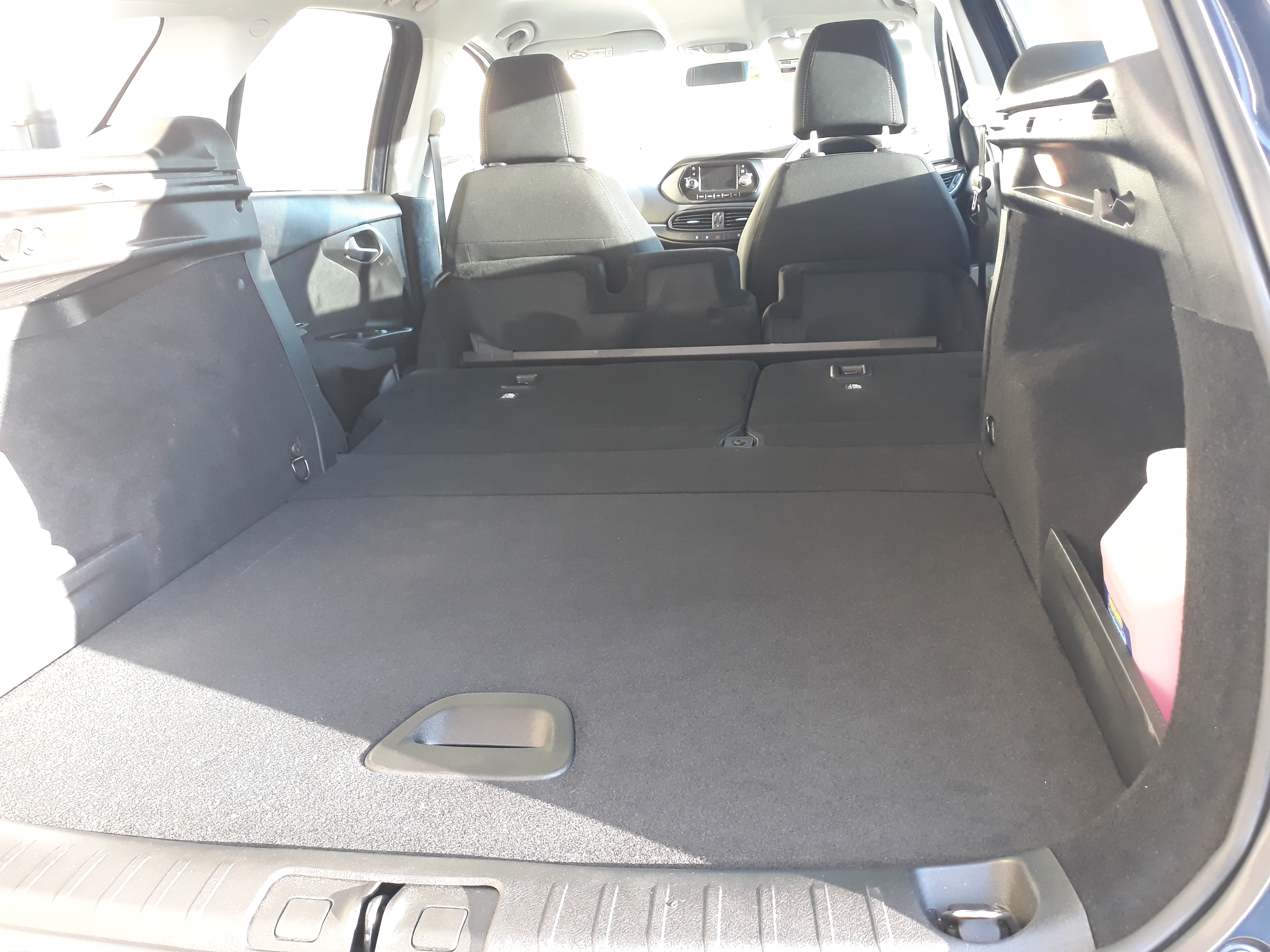

Hi, Chris3234 is right, the seat bases fold forward which means the seat back can fold almost flat. Not the best pic but hopefully you get the idea. IMG_0135.JPG
That's spot on as I was thinking it should be. Most of the reviews I've seen are really poor at telling you the basics. Thanks all!!

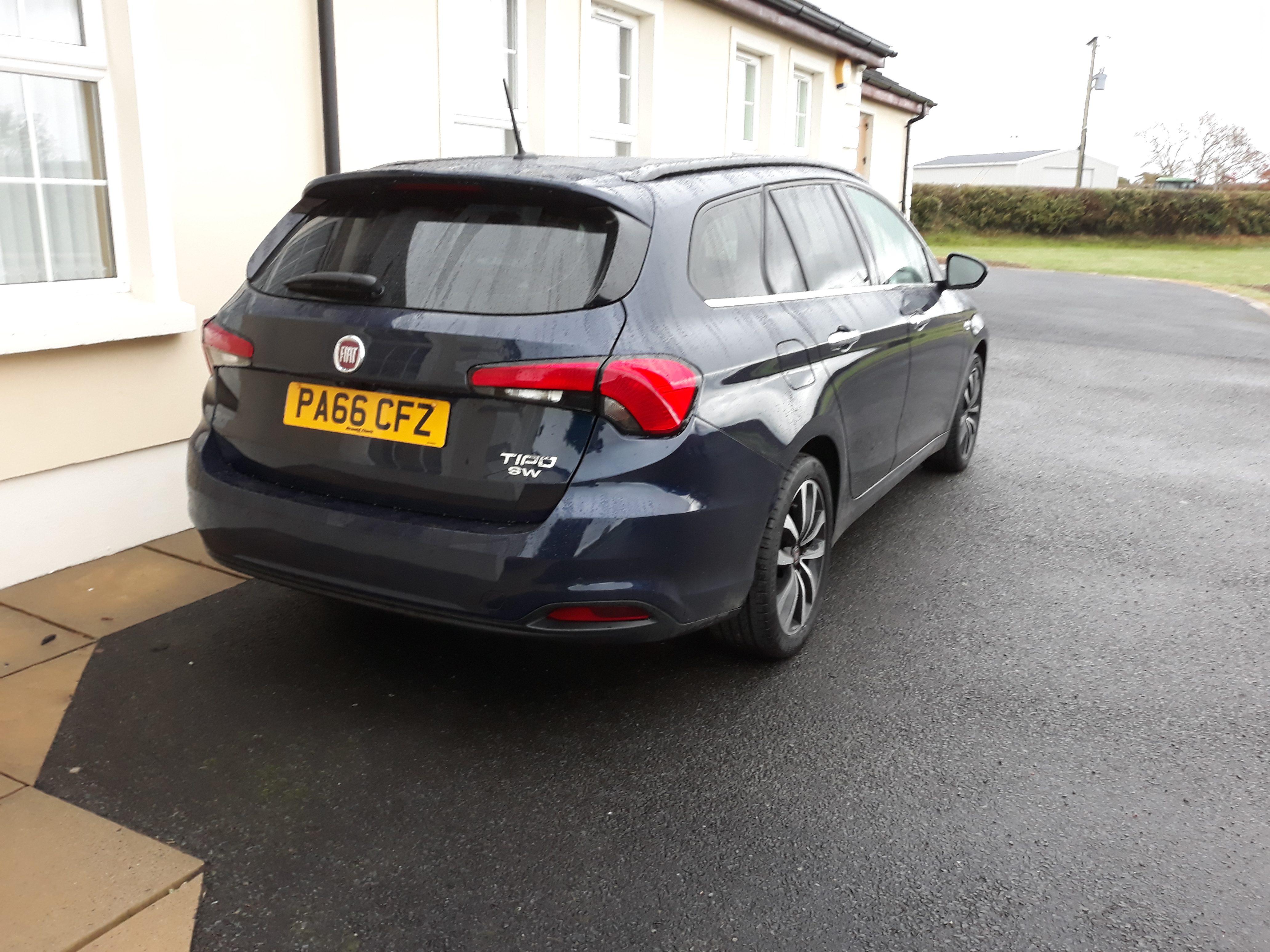

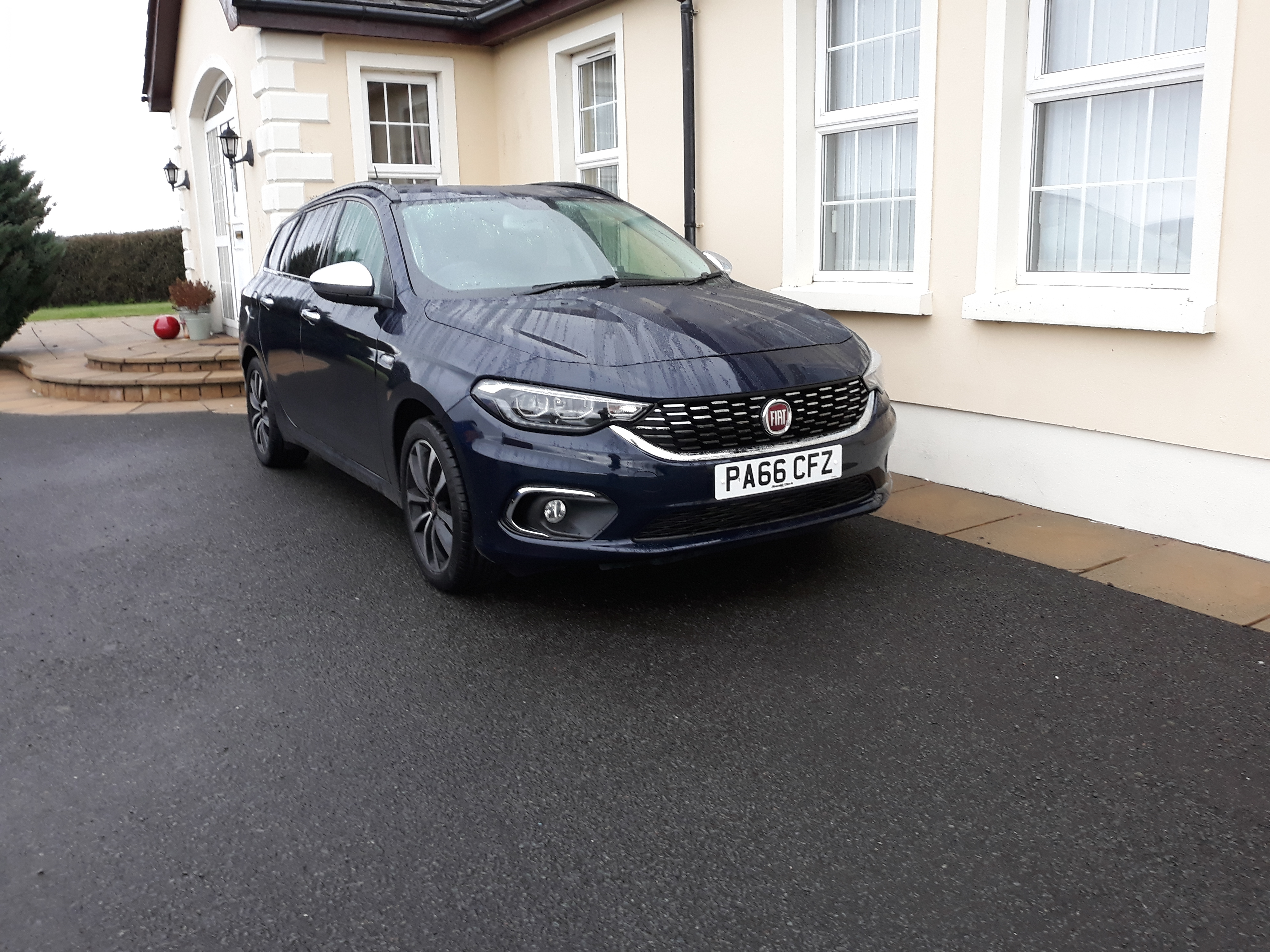

Picked up the Tipo that I was looking at and been using it for a week now. It's a nice place to be and does all the day to day things very well. The load area is long but the opening is not as tall as it could be. A full sized wheelie bin will not fit in unless you turn it through 90 degrees but there is plenty of room with it in there. Pretty happy overall although it is definitely harder on fuel than the bravo tjet that I was previously using. I'm thinking a map might release a bit more torque and that would help a little perhaps. Some pics..

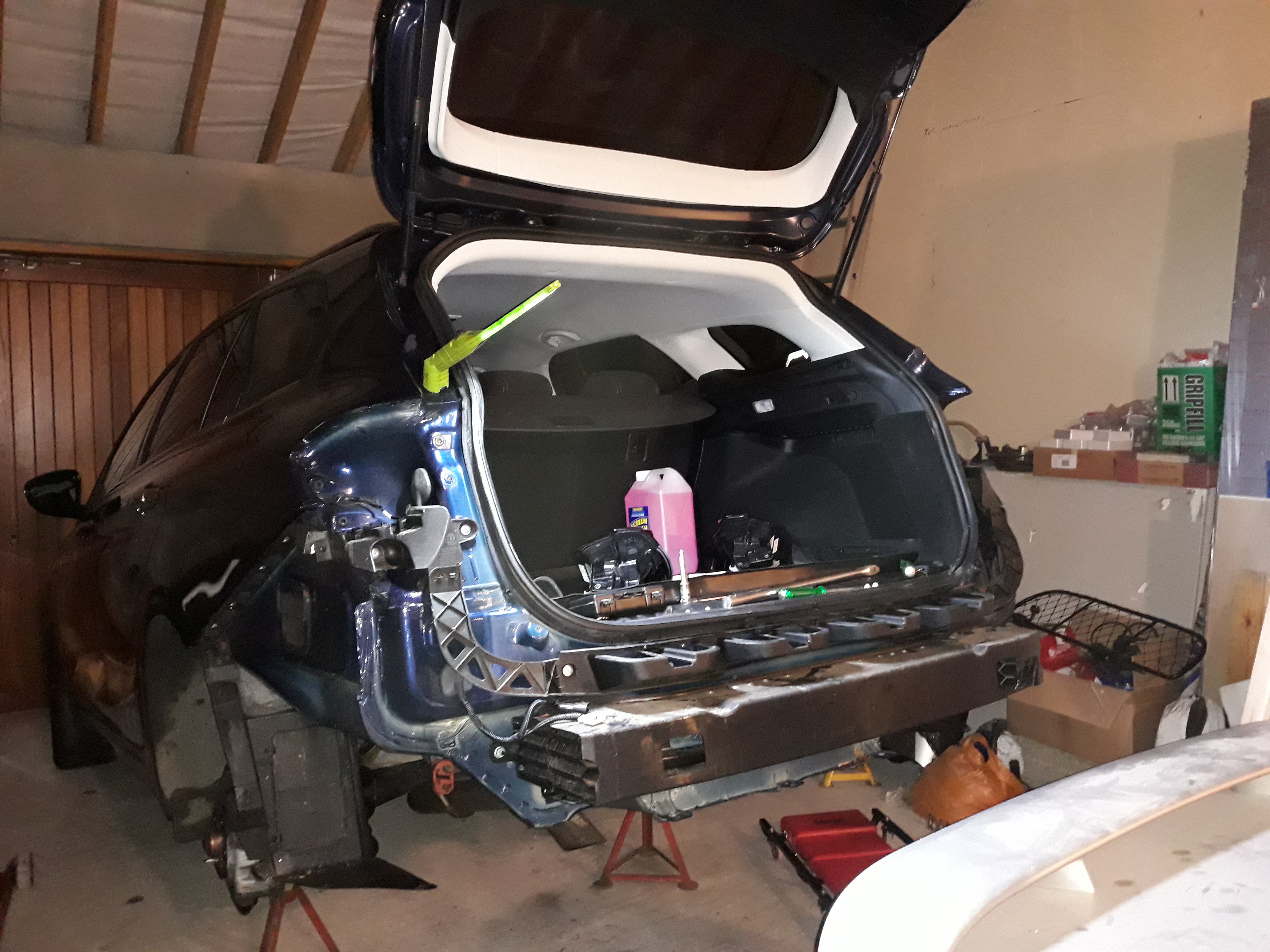

Still enjoying the Tipo, spent a few hours last Saturday fitting a Brink towbar which was all reasonably straightforward other than the dimensions for the cutout in the lower surface of the bumper which could have been much smaller. I may use the section I had cut out to cover some of the gaping hole that resulted. :-(

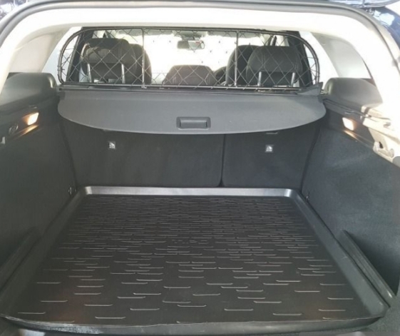

Another thing that I wanted to offer here for anyone that is interested is the dog guard that was fitted to the car when I got it. I'm not selling it per se, I'm doing a charity car rally this Saturday in my mx5 and would take a donation of £25 to the Friends of the Cancer Centre (NI) in exchange for the dog guard. I will package it up and send it for that price.

155Ringman, do you have any other photos of the Tow Bar fit? What wiring option did you go for? I've not had the chance to look at the job yet.
Regards,
Hi Howiedean, no sorry didnt take any more photos as I was cracking on to get it done after washing 4 cars earlier that day. The mechanical side of it is straightforward, just remove the impact absorbing structure behind the bumper which exposes the ends of the chassis box sections under the boot floor. Then there are two heavy duty brackets that are tied into the chassis legs and also use the impact bar mounts although they are only M8. The main chassis box section mountings are M12 with proper high tension bolts as you would expect. Then it's just a matter of bolting on the horizontal beam and cutting the underside of the bumper to suit.
There was a standard 7 pin wiring kit with the towbar and I have led the wire into the spare wheel well at the moment until I can get some time to finish the wiring.
Before I bought this bar, I asked my local fiat dealer about a towbar kit and the answer was..... £650!
This brink bar was £165 including delivery to Northern Ireland.
