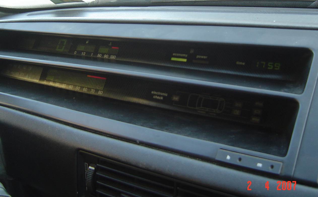

3.And at last of thes big problems is unsolved until thes days.

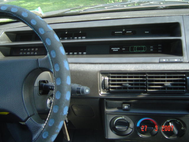

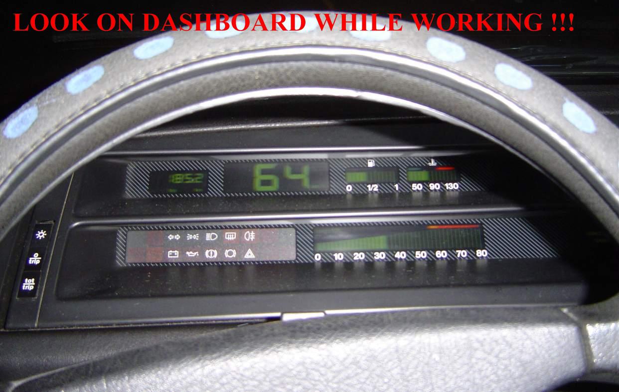

The problem start to appear and disappear on the digital dasfboard,
the digital numbers of sensors and indicators for kilometre (kmh) fuel, rpm ,temperature,clock...
nothing of this does not working .
Electrician could not solve the problem ,nor say is the problem in dashboard or in car ECU
or some wires or something other.
There are 3 buttons on left side of dash that are for:LIGHTING ,TRIP,TOTAL TRIP
and when you press the TRIP and TOTAL TRIP together the all indicators on the dash ar lighting for check,
now that doesnt working to.

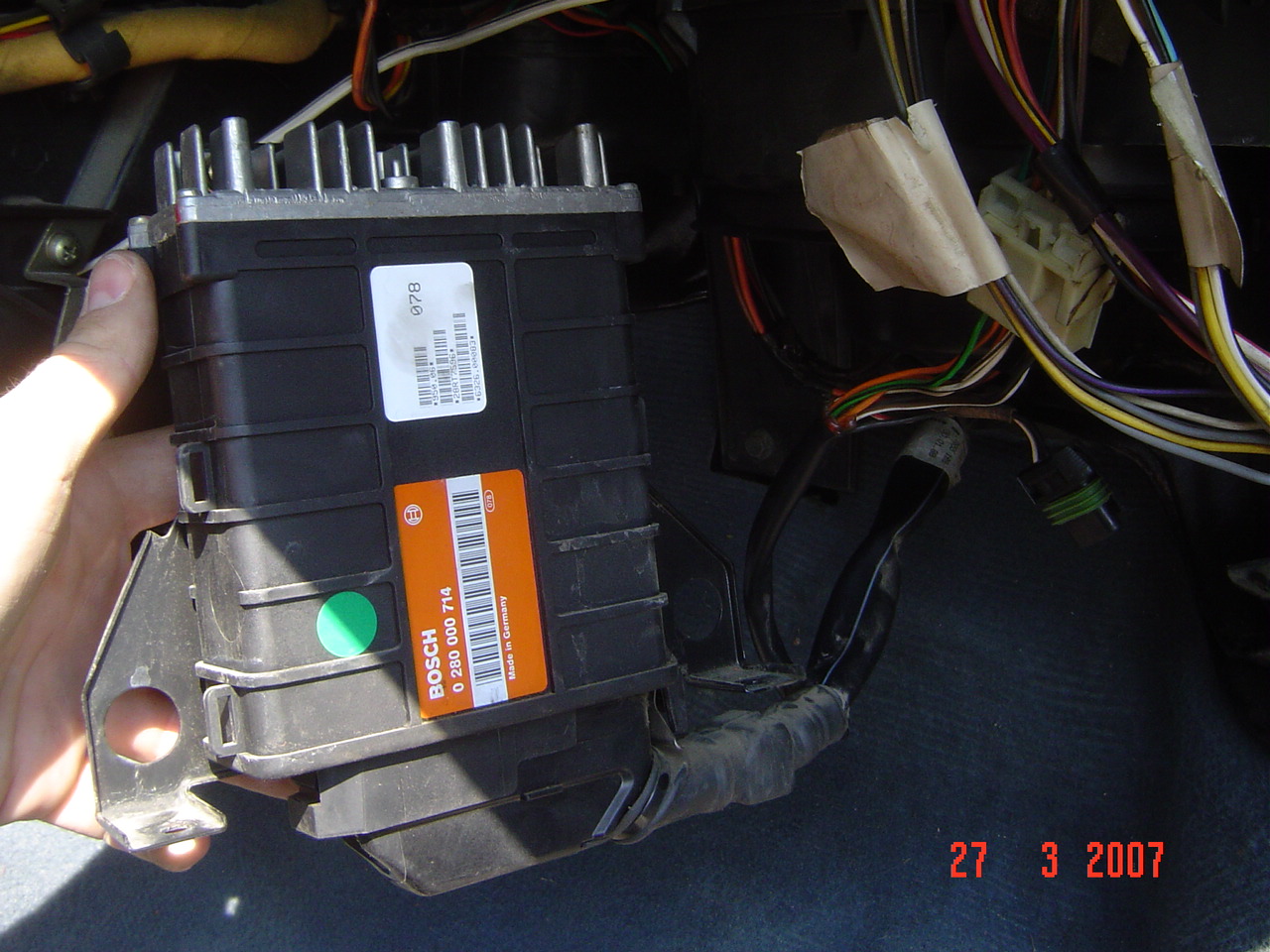

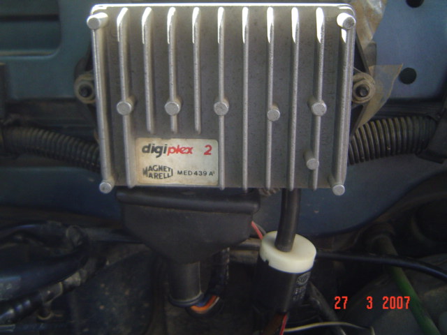

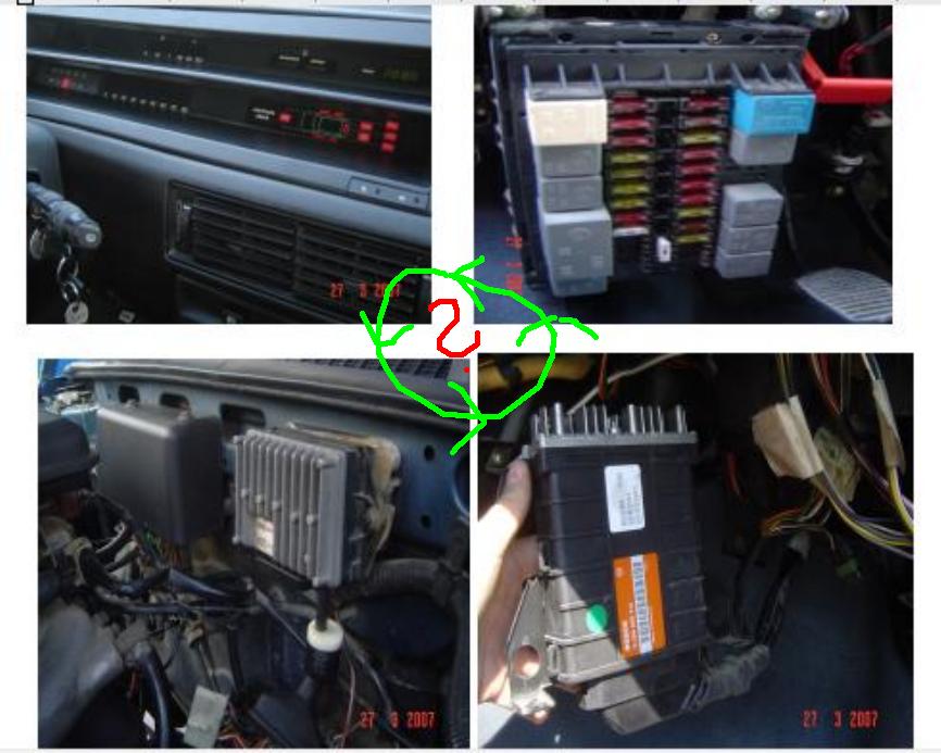

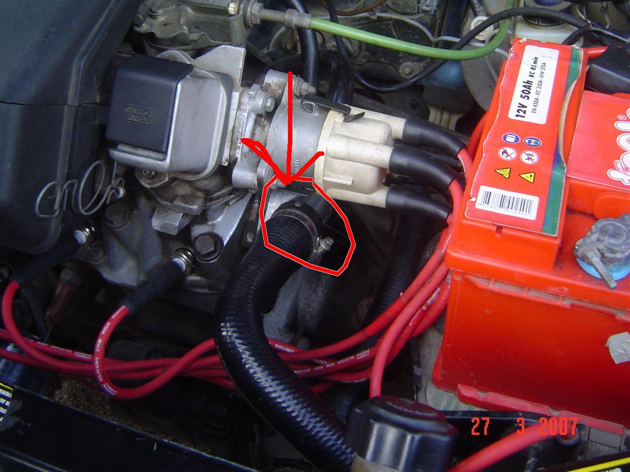

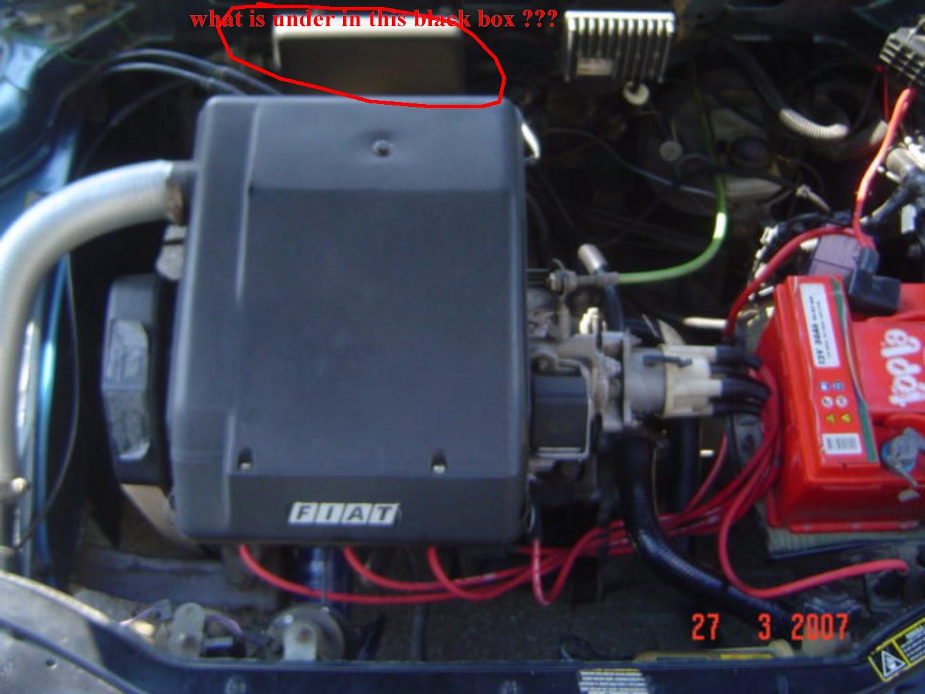

Another thing that I wolud like that all members of forum an you owners of Tipo's try to help is
to see what are this parts on my car,and where are they positioned and what is the role of them on car !!so look this pictures and write what do you know about parts,for what are they !so look this pictures and write what do you know about parts,for what are they !

the thing you've circled which is to the left of the battery and under the ignition module thing. is the thermostat.
Thank's Besbie this is now something ,you on fiat forum are realy fast
Others join please I am still interested what are the other parts on above pictures:worship: (y)

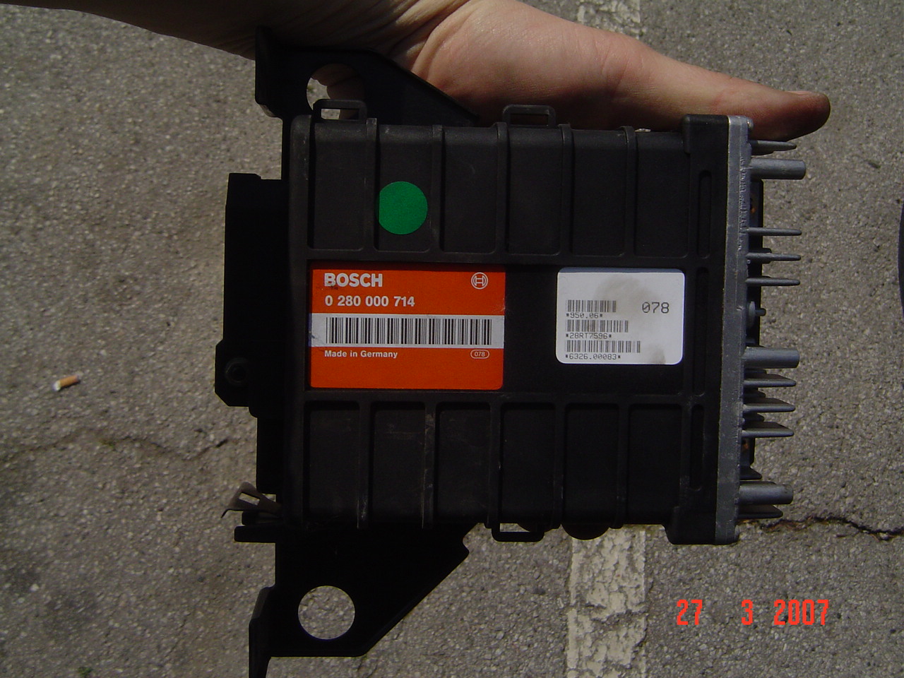

The "Digiplex 2" box in the engine compartment is ignition management module. It is used to set advance according to engine load and it also controls ignition coil.
The "Bosch" box under the dashboard is ECU, also incorrectly called "computer". It is responsible for managing Bosch Mono Jetronic injection system. It receives various data about the engine status (engine temperature, incoming air temperature, throttle position etc.) and adjusts the amount of the fuel injected accordingly.
I must say,it is unbelievable how fast are members on this forum to help
or just discuss about things and questions that I posted
,thanks Rampage94 and (CZ)enda !!!
All pictures that I posted are with intention to get conclusion what is
the role of each part in car and could it be the reason in some of them with problems that I had .?
So I wan't to get conclusion wher is the real malfunction of my not working DASHBOARD ???
Could it real error be in dashboard electronic system (chip's and other part's inside) or
the problem is in some other car unit that have connection with dash?

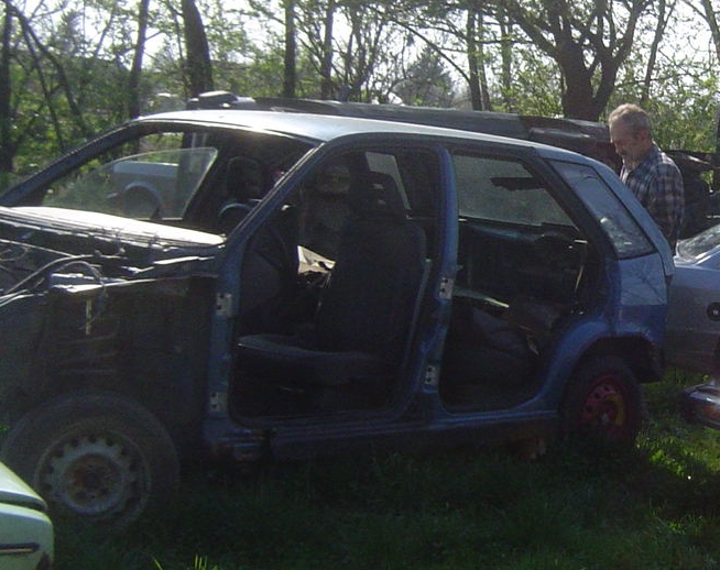

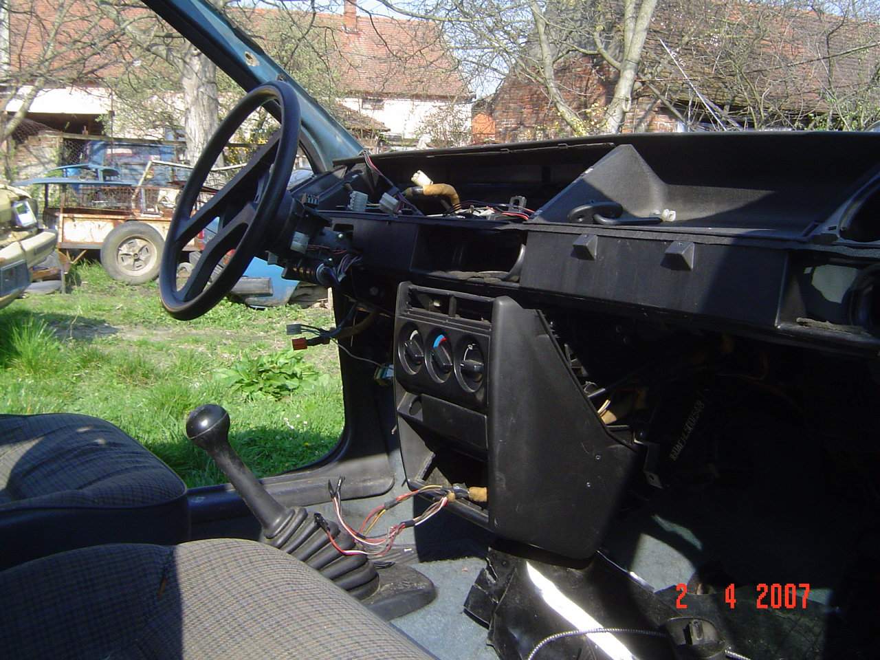

And here I am again,so the problem is now solved,after all the mehanics
said that the problem is certainly in dash ,we simply went on the old
cars landfill and we agreed with the owner of crashed Tipo for a cheap
price ( of 35 EURO) ,and now everybody happy,dash working for now !!!
The good thing is that the old kilometers went gone with the old DASH and
now we have with new one less than before !!
Thanks everybody, once again we successfully solved Tipo electronic problem !
