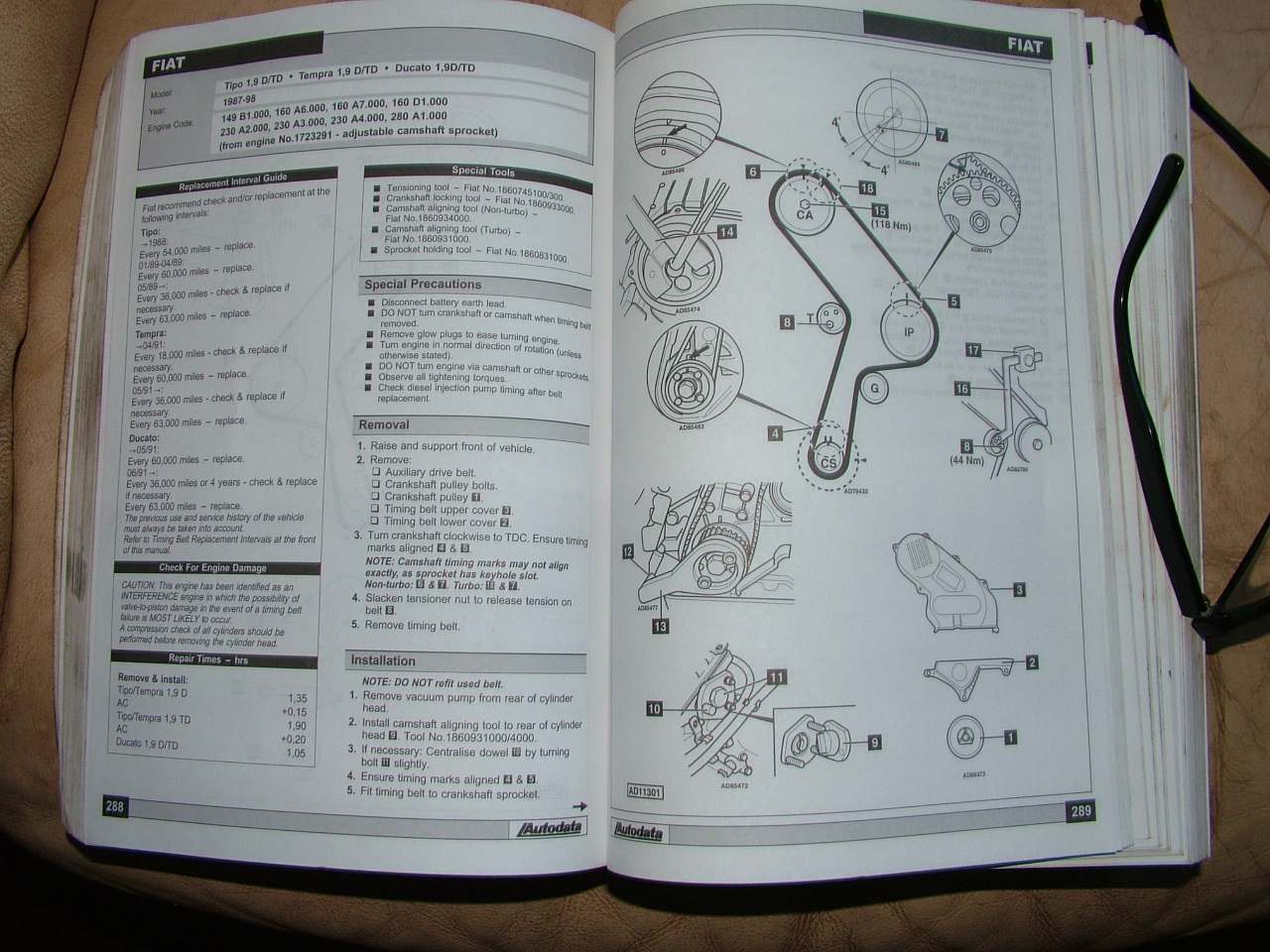

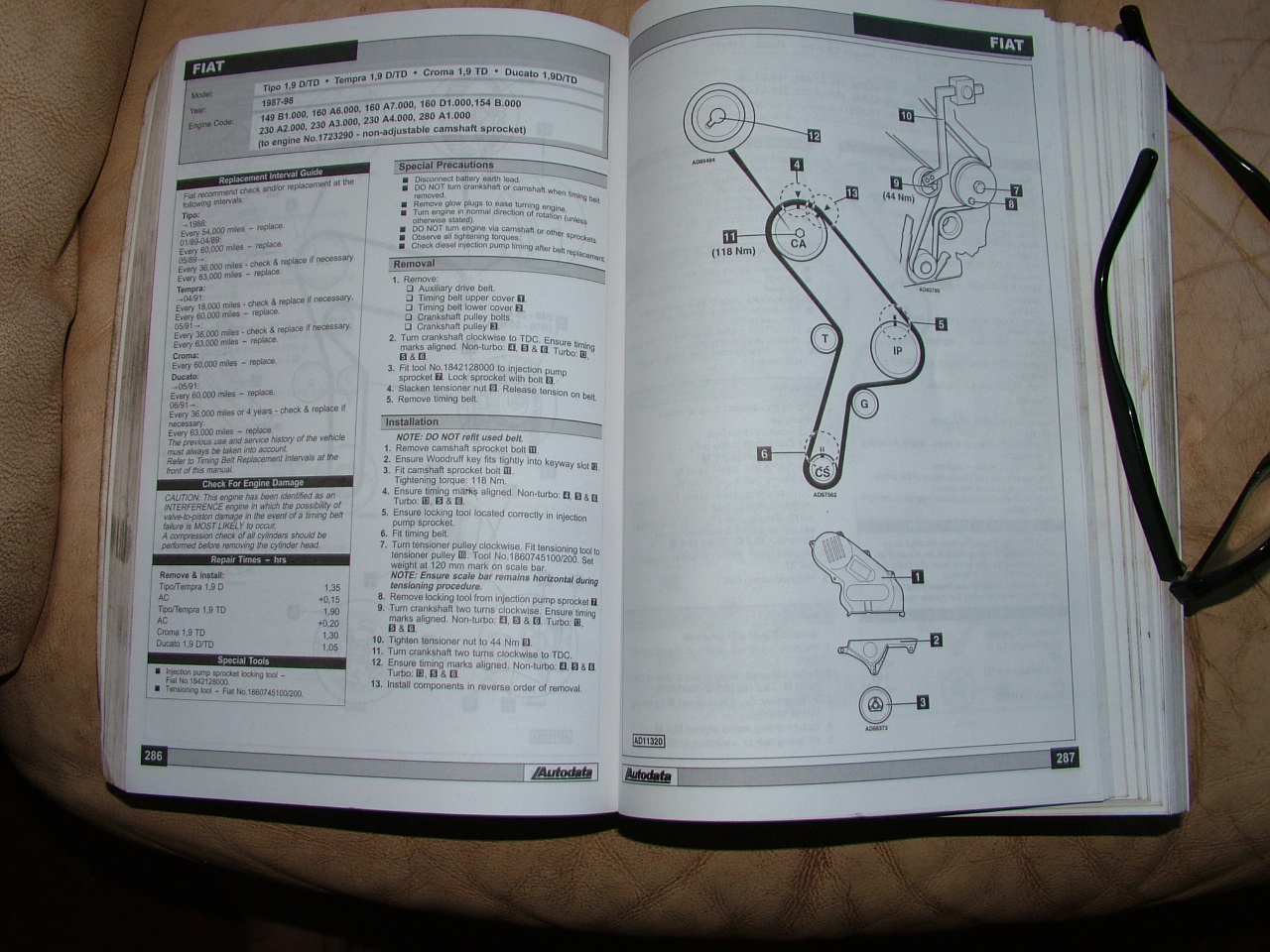

Hi, could somebody post a picture of the timing marks for a fiat ducato 1.9td engine please, I have looked everywhere but no joy
Model
Fiat ducato 1.9td
Year
1997
230A2000 05464008
I have put two lots down , note both for your engine Series but one for adjustable camshaft sprocket so read carefully.
pages 286 287 are for the none adjustable and 288-291 are for the adjustable sprocket.

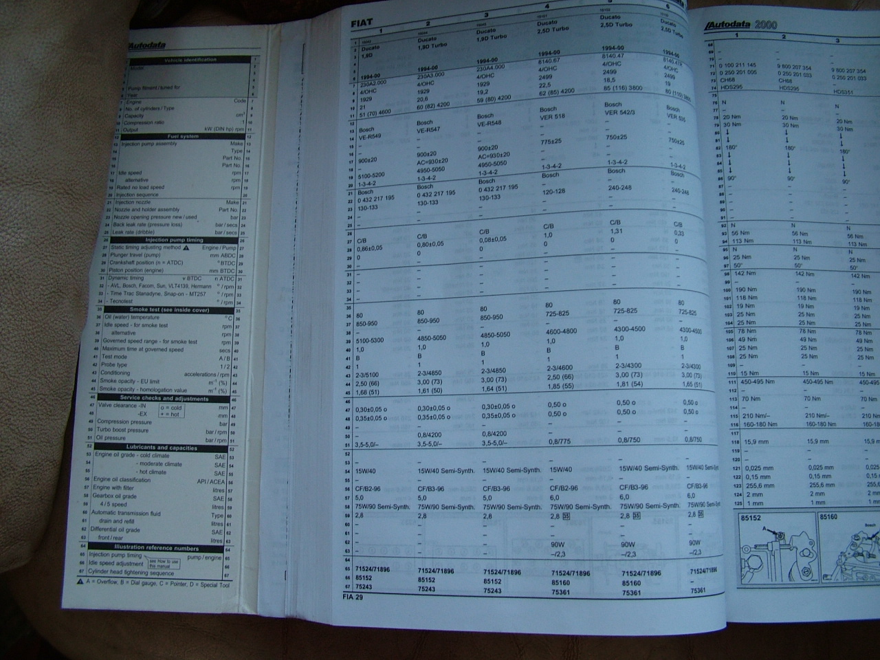

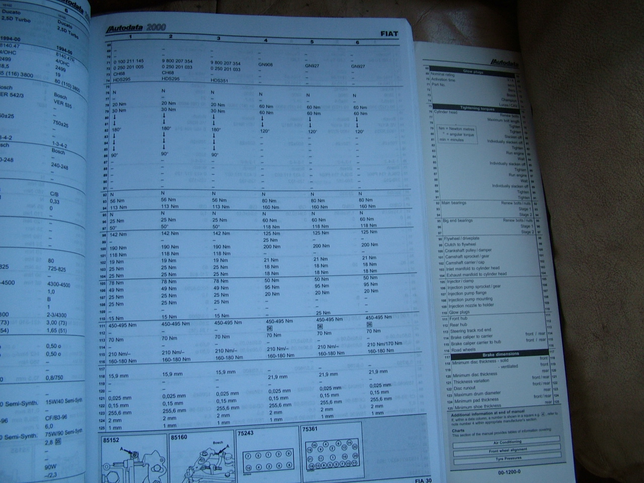

Hi m8, do you happen to know the cylinder head tighting sequence and torght settings for a 1.9td
The torque settings are in the left hand columns of details for your vehicle I think, on the right hand page.
In general terms head tightening sequence starts with the centre pair and gradually radiates outwards as a rough guide.
