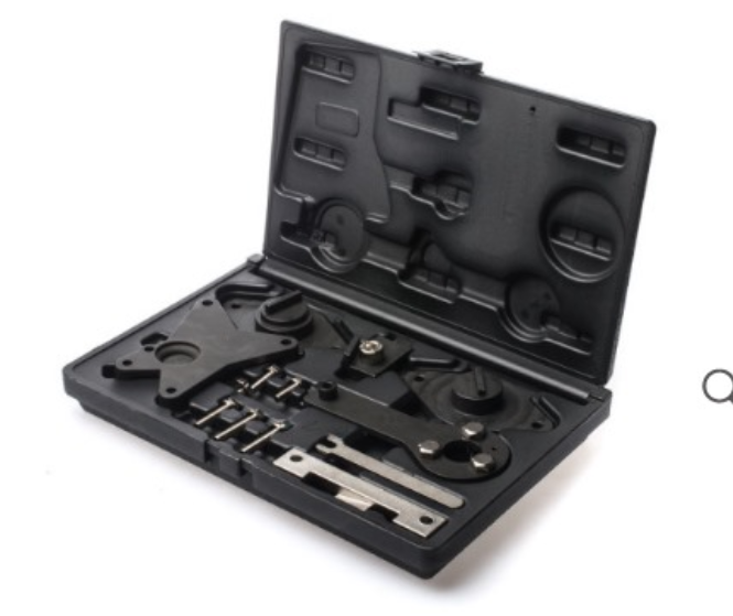

I guess these are the tools:
As long as hes happy to do it a second time free of charge if he F**ks it up your alright!
