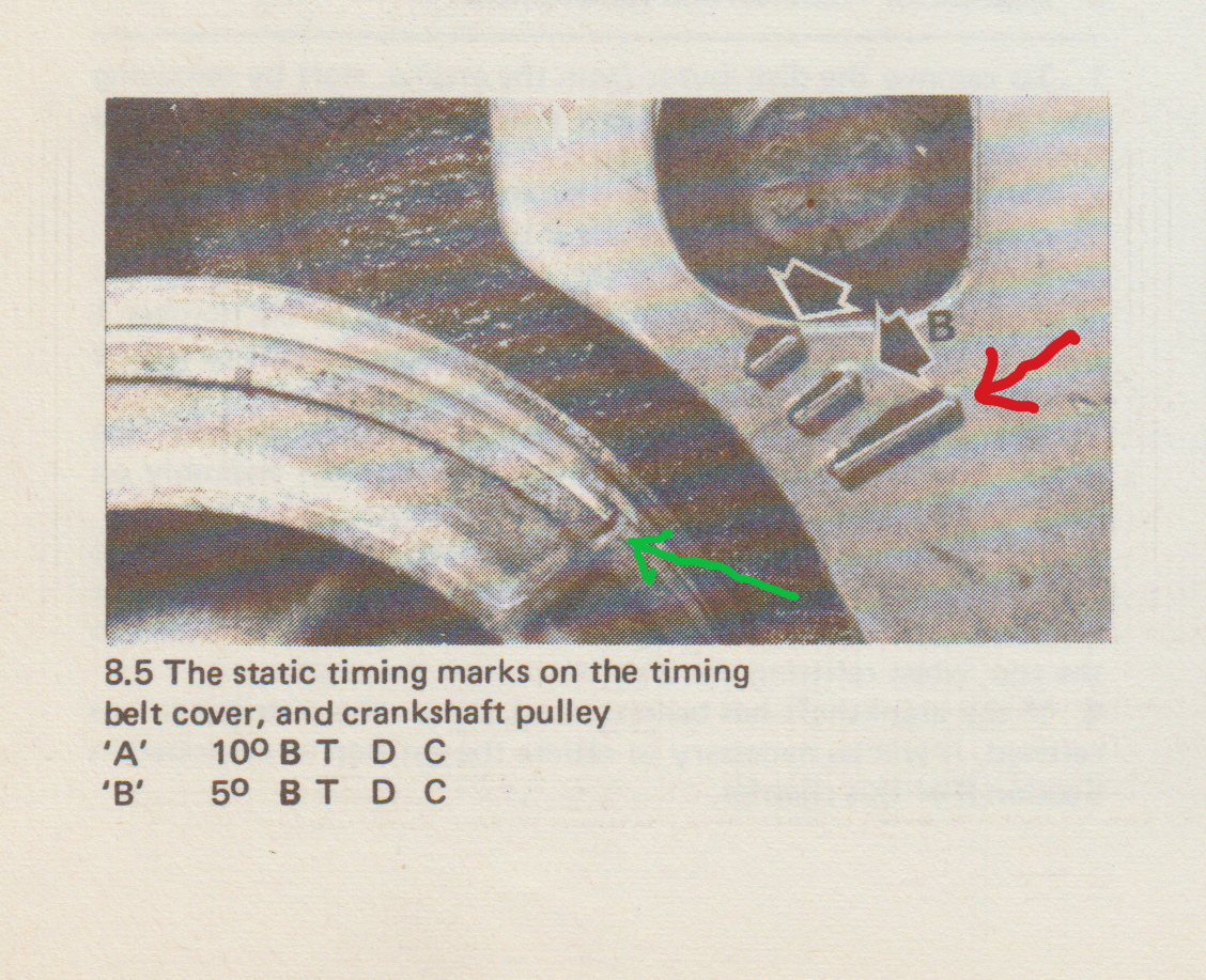

Yes, I understand what you say/mean however WHICH one of the (3) is the ZERO mark on the Crank pulley The BIGGEST mark ?
PLEASE someone help me out. I'm going NUTS...
All of the 124 Twin Cam engines I've seen have only one timing mark on the crank pulley (there's a raised line on the casting pointing to a small notch on the pulley rim, it looks like a saw cut, (see green arrow in the pic) and 3 timing marks (10, 5, 0 degrees) on the timing belt cover. So in the following pic, the ZERO mark (top dead centre) is the BIGGEST (longest) mark on the timing belt cover (indicated by the red arrow)
OMG THANK YOU Soooo Much. First Thank all of you who welcomed me as A comer. I finally figged my password thingy. Does anyone have any recommendations for sealants or gasket compound to install cambox gaskets ? ? ? Thx. Mr Ken
