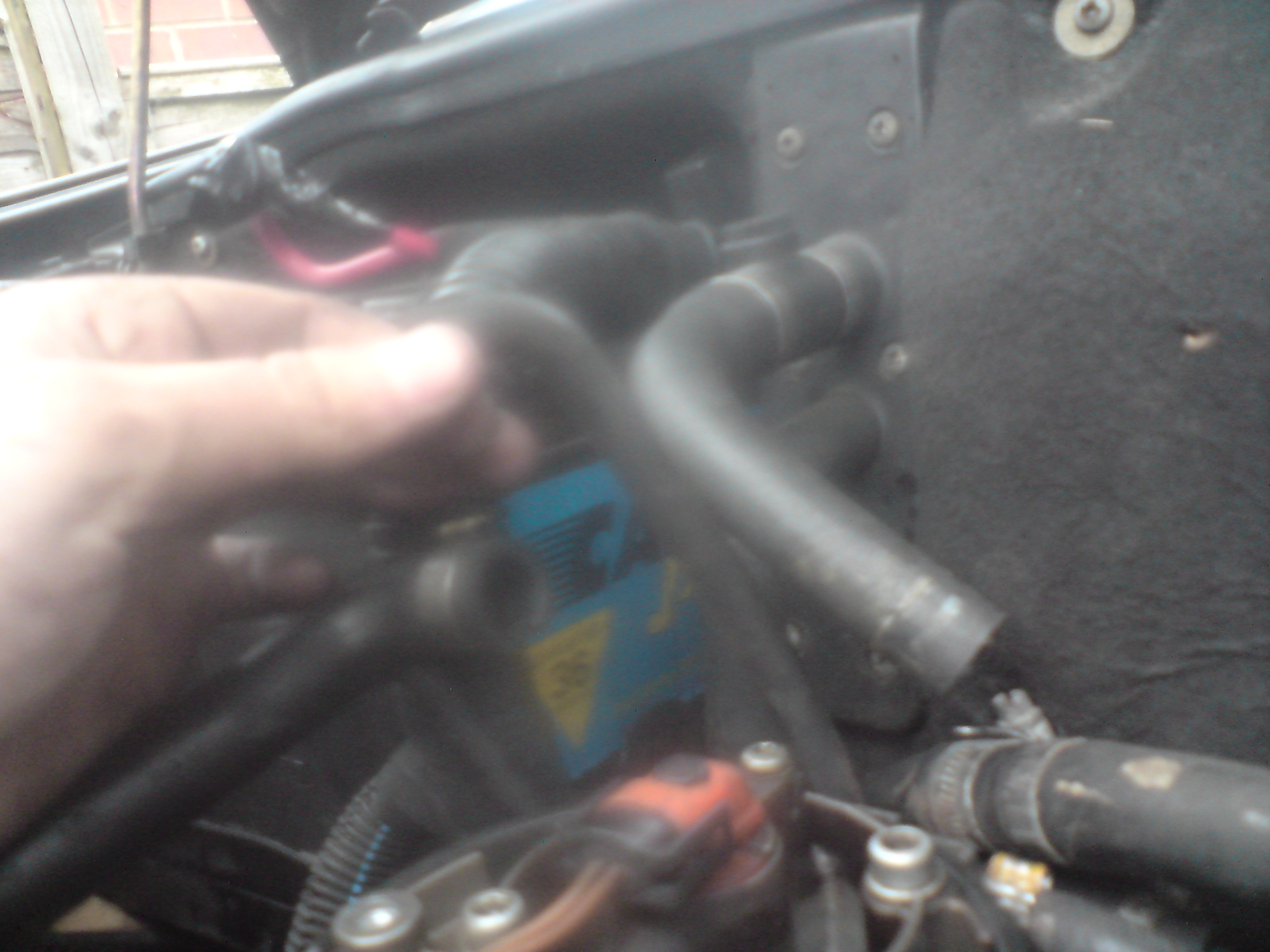

Well 32mm TB has been fitted after some problems (see other thread) and its still idling high.
Levemir's suggestion of vacuum pipe makes sense as I've found a pipe (see below) and have nothing to connect it to/don't know where it goes.
So where does it attach to? You can also see in that photo the other problem I have discovered. (see other thread PLLLLLEEEEAAASSSSE)
