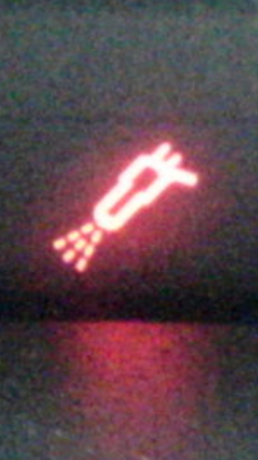

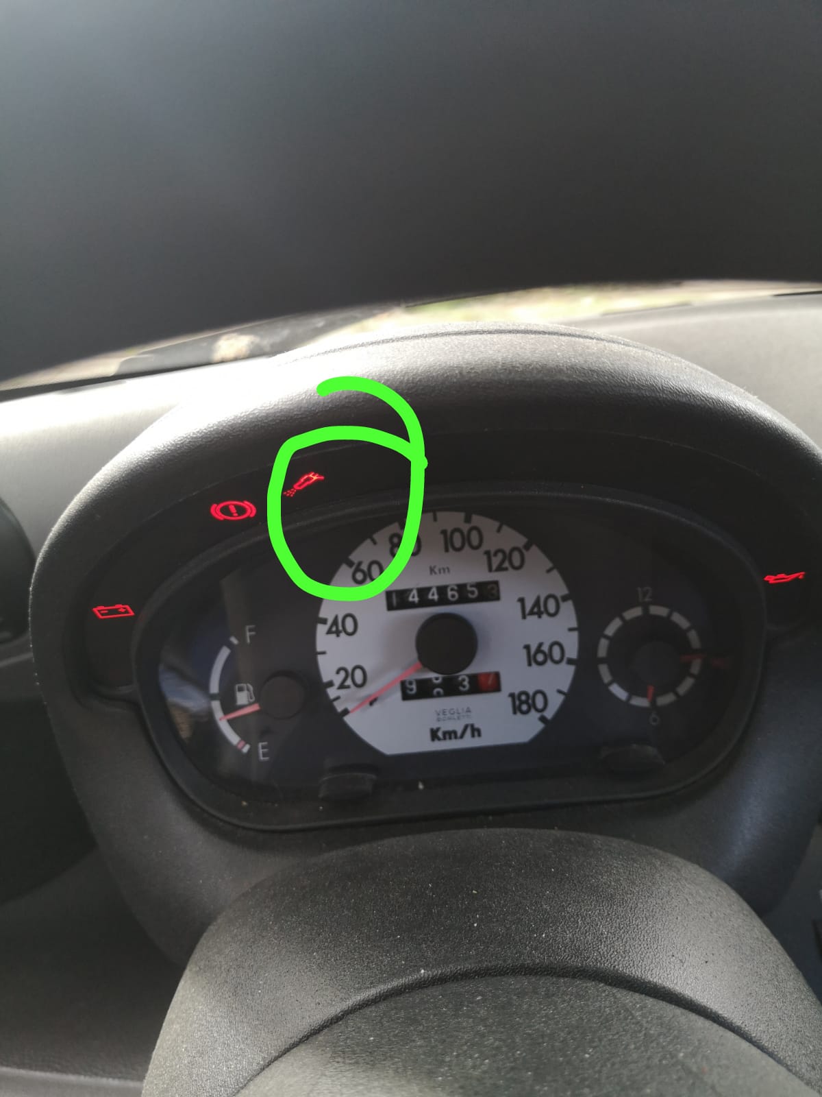

A few months ago, this weird light came on (also attached a few jpg's of this) and the engine lost all power. I immediately stopped the car. Was able to ignite the engine, but it would shut off the moment I tried to actually press the gas pedal and rev it. It also made a strange, deeper sound, and it felt like it was vibrating harder. I ended up pushing her home (luckily this occured when we were like 200 meters away from there) while the wife steered her.
I couldn't find anything about this light anywhere. Not even in the manual. I found maybe 1 or 2 topics on the entire internet about it. Wrote down the stuff mentioned in there for my garage to check. We eventually had it taken away to our garage. They checked everything and also replaced almost everything. There was new stuff with the brakes, something was replaced within the starting motor thing, all kinds of filters were cleaned, electric cables replaced, the battery was replaced and more. To my surprise, they admitted they had done a lousy job checking her the last few times, which led to so many parts being crap. They apologized for that and gave us a big discount.

Hi.. :)
Looks like it signifies 'injection'
But that is often just a broad term for 'running properly.. or not when the light comes on'
1st thing.. does it run ok when the light shows.. or seem a little 'wrong'
Any error like this SHOULD store an error code.. so an OBD code reader can be a good guide here

Hello Charlie, and thank you so much for replying.
So right now the light comes on every now and then and turns back off after a few seconds. Absolutely nothing felt off when this happened most of these times, until that part at the highway exit, when it slowed down significantly.
We're now usually going to this random garage that's closest to home. Do I need to bring it to an actual Fiat dealer, or should I buy one of those OBD code readers to try this myself?
For now, it looked like driving at higher speeds makes it worse, as things returned to normal after I started driving slower.

The injector light I think was an early example of an engine management light. Might suggest a problem with the injector(s), or might just be reporting a problem with oxygen sensors. Fault could well be a failing oxygen sensor.
Not sure about this model, but might have one or two oxy sensors, I'd expect two.
