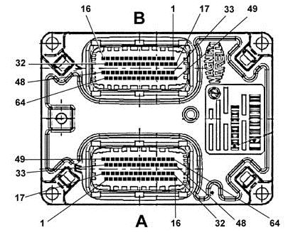

and heres the ECU Pinouts locations,
theres a discrepency in the info i have where the wiring diagram denotes Pin 43 at the ECU... BUT... the 'pinout' locations i have denotes Pin 42 (pinout shows pin 43 as 'not used') so it could be either Pin 42/43 that's connected to Pin 4 at the throttle body.
you need to look at all the continuities between
  • ECU Plug A Pin 2 > Pin 2 Throttle Body
  • ECU Plug A Pin 3 > Pin 1 Throttle Body
  • ECU Plug A Pin 15 > Pin 5 Throttle Body
  • ECU Plug A Pin 40 > Pin 6 Throttle Body
  • ECU Plug A Pin 42/43 > Pin 4 Throttle Body
  • ECU Plug A Pin 46 > Pin 3 Throttle Body
the ECU pinouts are as follows
Pin 2 = Acc Pedal Sensor Supply (Track 1) {5v}
Pin 3 = Acc Pedal Sensor Supply (Track 2) {5v}
Pin 15 = Acc Pedal Sensor Ground (Track 2)
Pin 40 = Accelerator pedal potentiometer signal (Track 2)
Pin 42/43 = Accelerator pedal potentiometer signal (Track 1)
Pin 46 = Acc Pedal Sensor Ground (Track 1)
If your continuity checks come back ok... Check for 5v signal between Pins 2 & 5 and Pins 1 & 3.
Between Pins 6 & 5 and Pins 4 &3 you should see anything below 5v, varying with throttle input

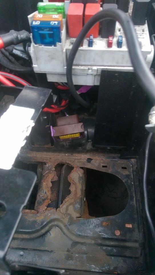

Something else to bear in mind here is that the wiring runs through the D4 connector, which is notorious for causing issues. It is located under the battery tray and is a black (iirc) rectangular connector that is approximately 30mmx60mm. My first port of call would be to disconnect and check this plug for any signs of, even slight, water/dirt ingress. Maybe spray with some electrical cleaner and reconnect. Recheck fault status before carrying out wiring checks.

Quick question! Just taken off the battery to give it a boost and found this unconnected effort??
Thoughts?
