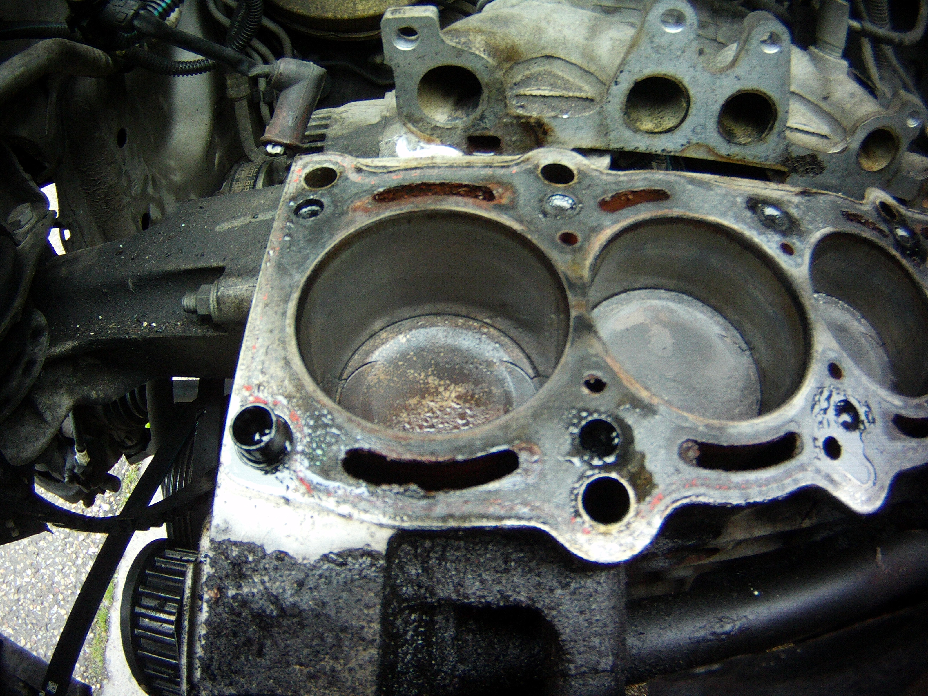

And it was HEAD-GASKET and/or thermostat, both had gone, by the looks of the gasket that went first and with no or little water the thermostat next.

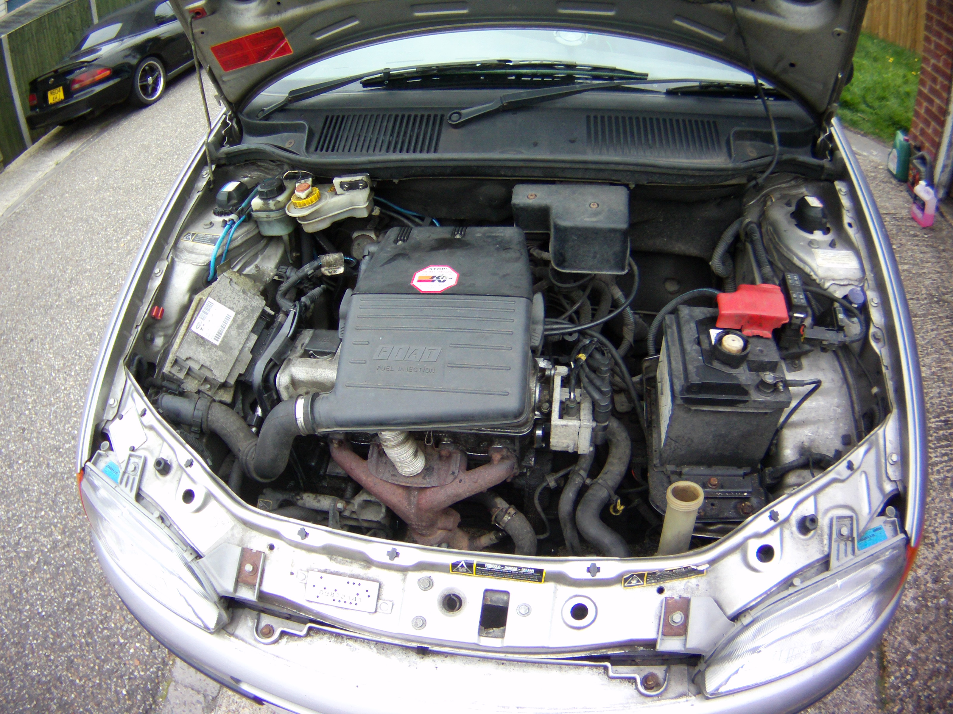

1. Starting stripping down the engine.

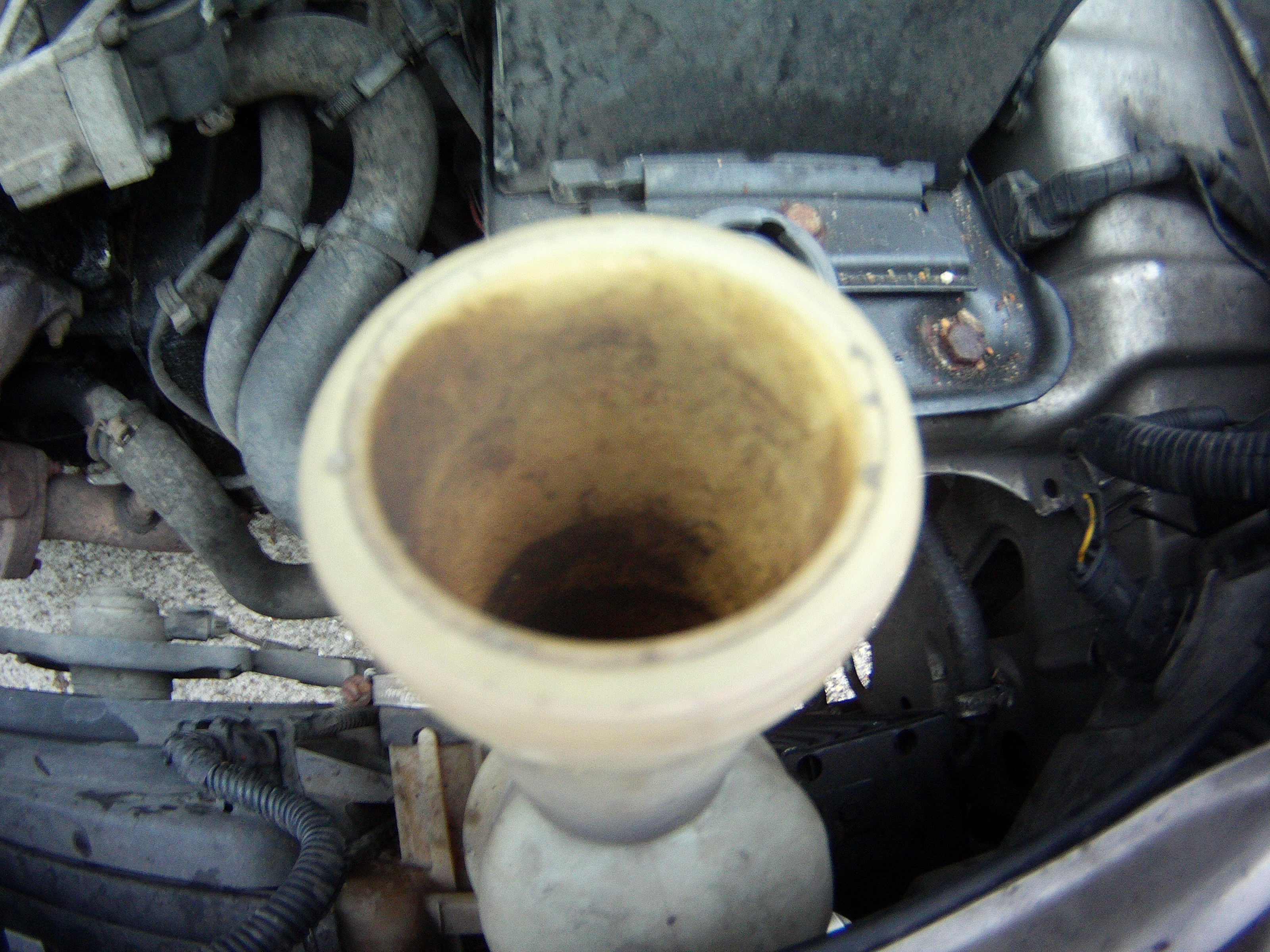

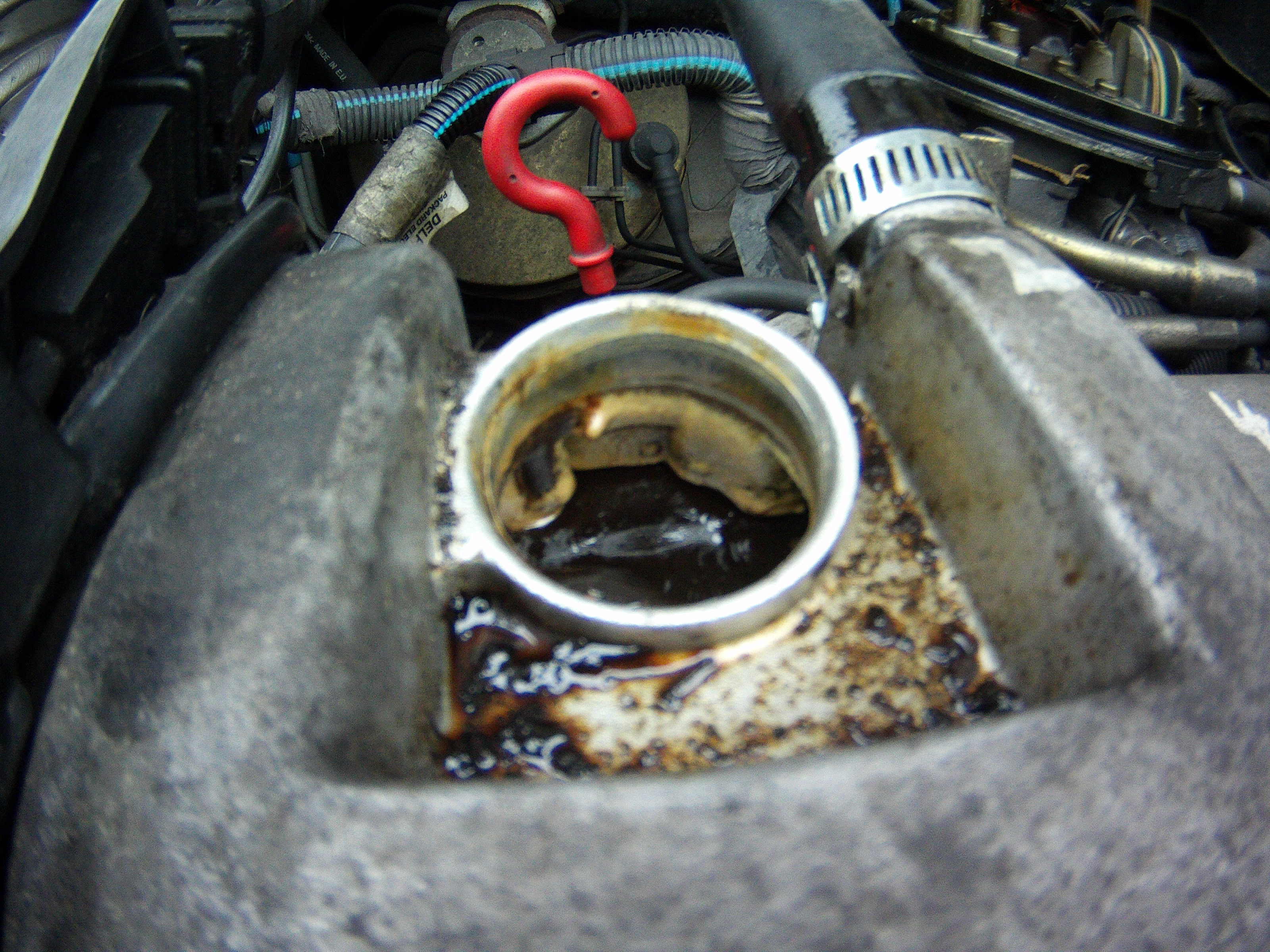

2. Evidence in the oil filler.
3. Evidence in the expansion bottle filler.
4. Evidence in the chamber.
5. The culprit!

yep, and I known why, tap water was used with the anti-frezze, not deionized or distilled water, causing the head gasket to corroide.
