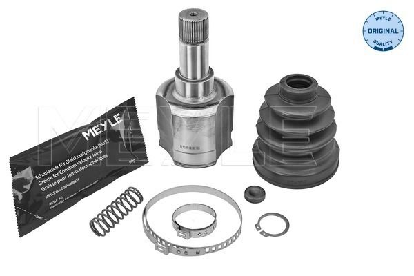

So I found out what the problem is:
The inner axle joint is supposed to have a spring in it that keeps pressure on the cup to keep it in the transmission.
When my truck was loaded on the tow truck, they ripped the boot on the inner axle. When the guys who replaced the transmission went to replace the boot before installing the axle, apparently the spring fell out without them noticing...
Here's what it's supposed to look like installed:
I would have thought this would have been the first thing to pop into the head of the guy who replaced the transmission, but... oh, well.
