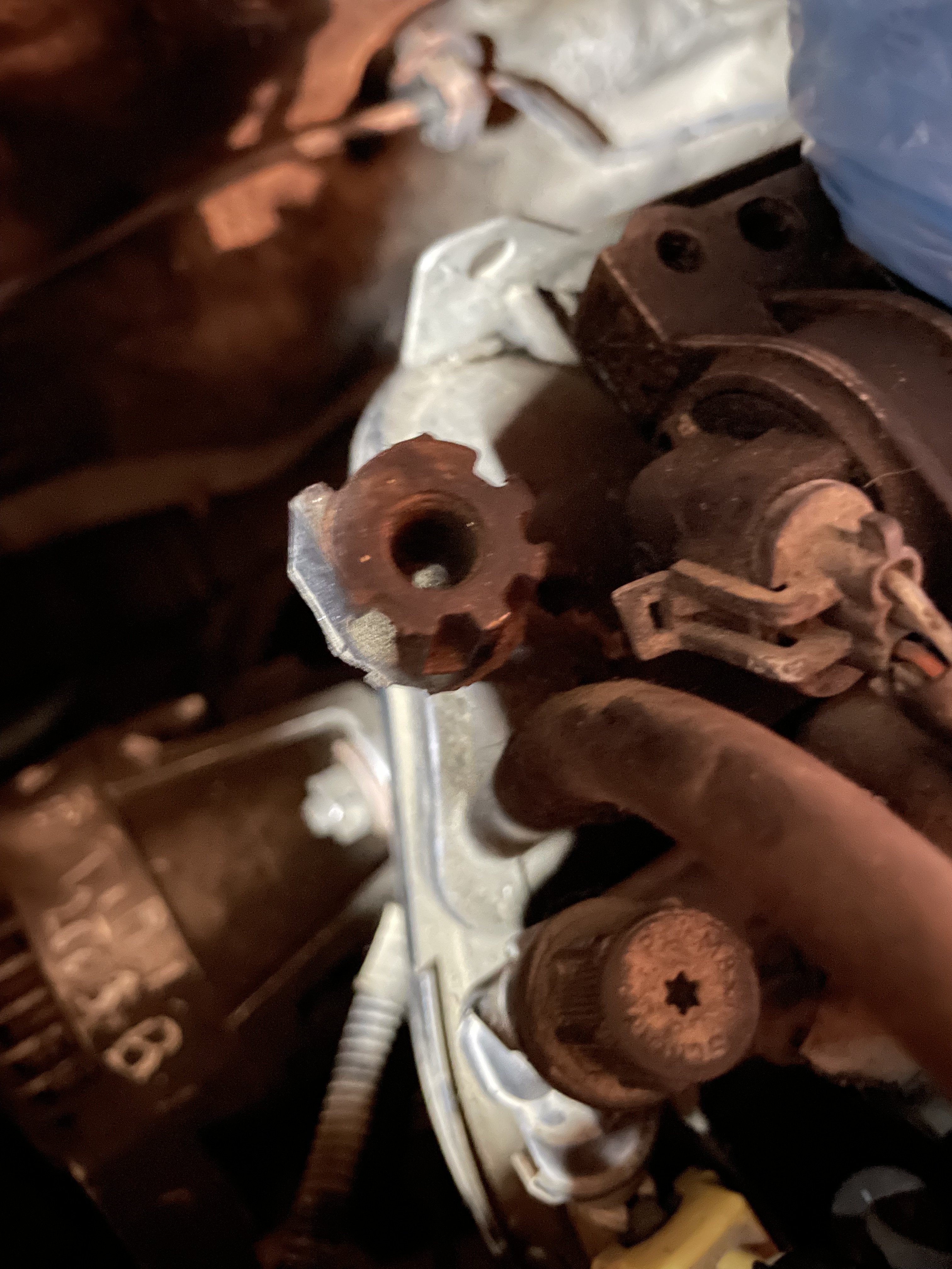

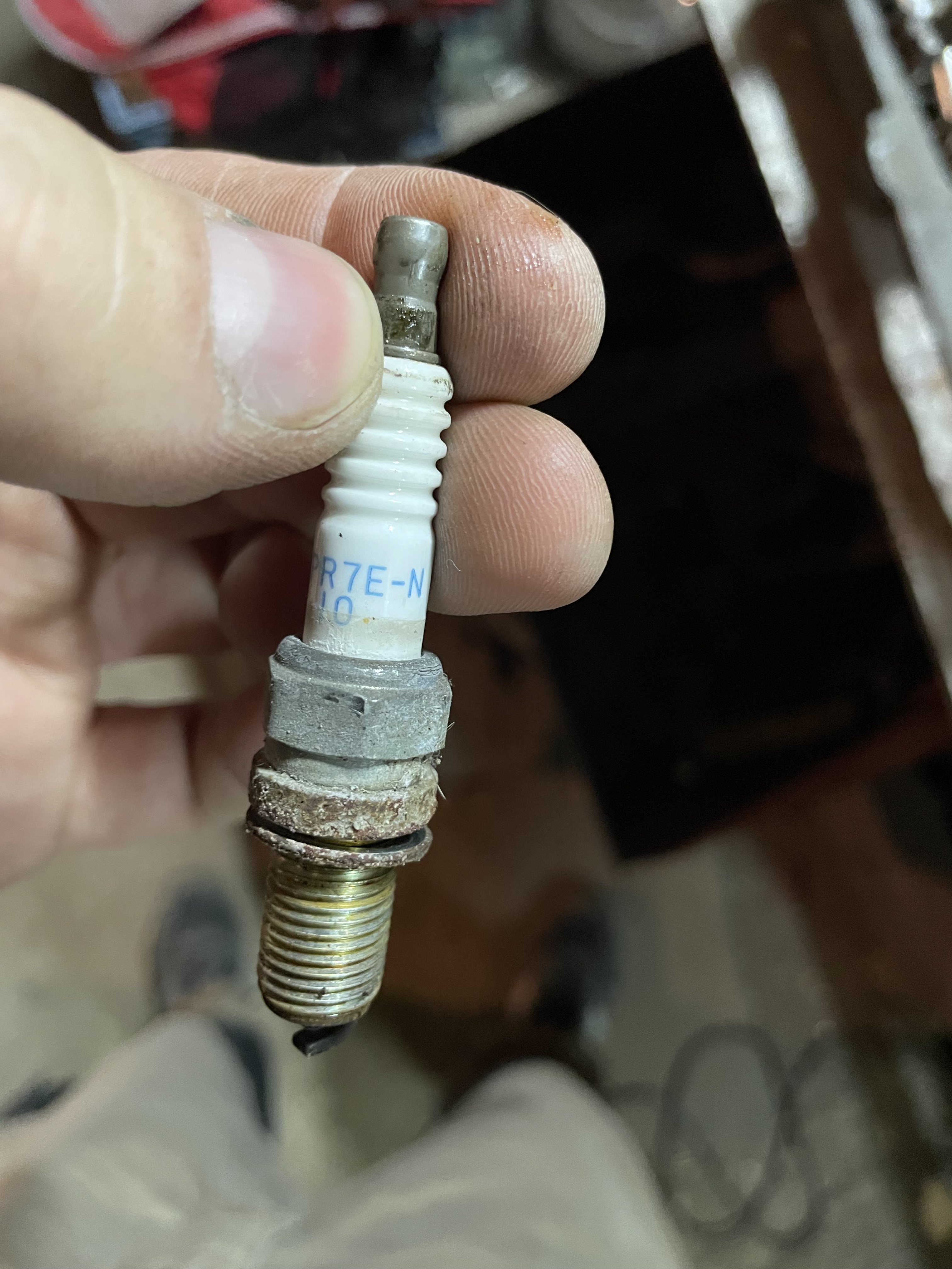

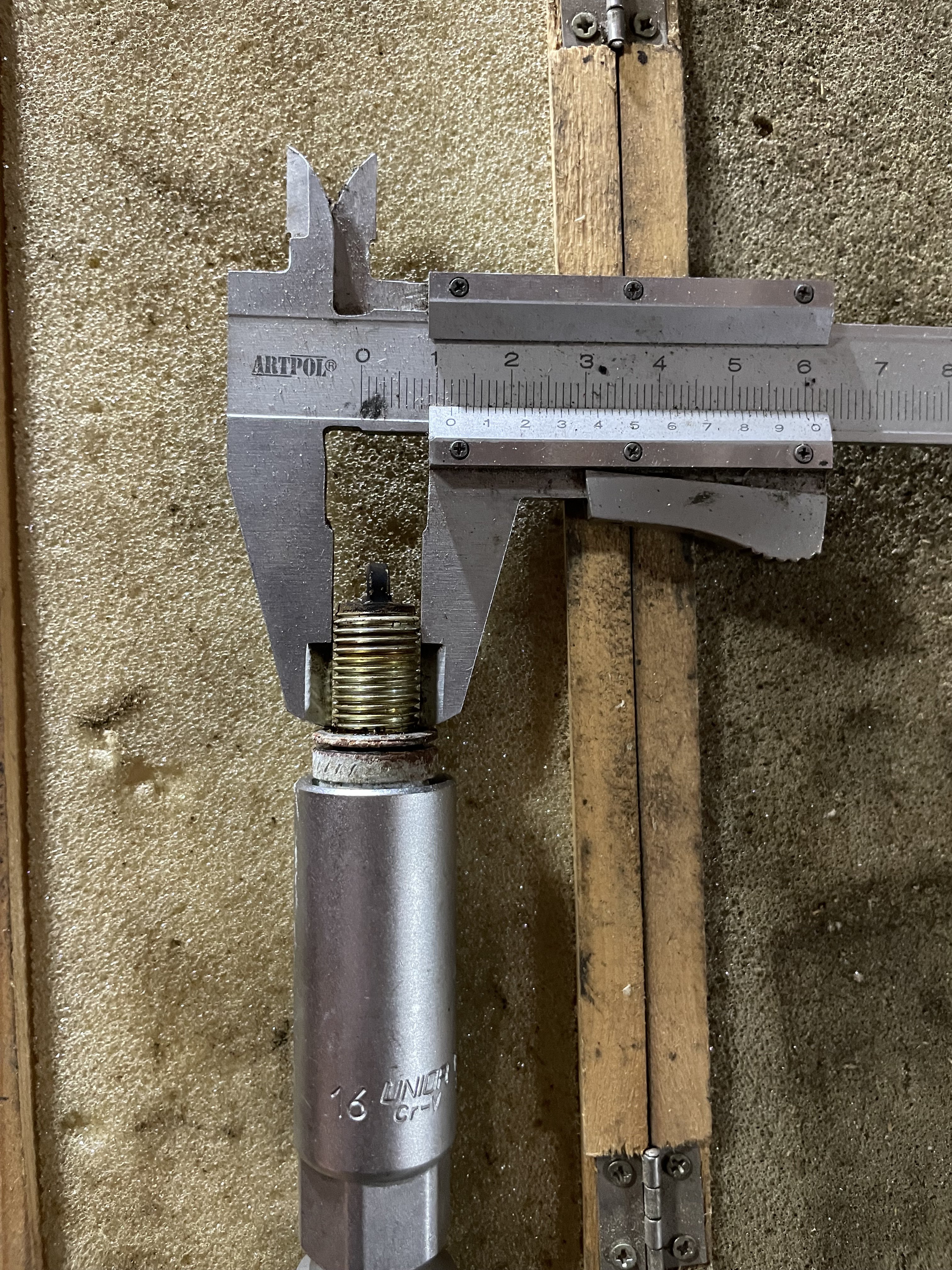

I unplugged the spark plugs and unscrewed ine to check it an look into replacing them all.

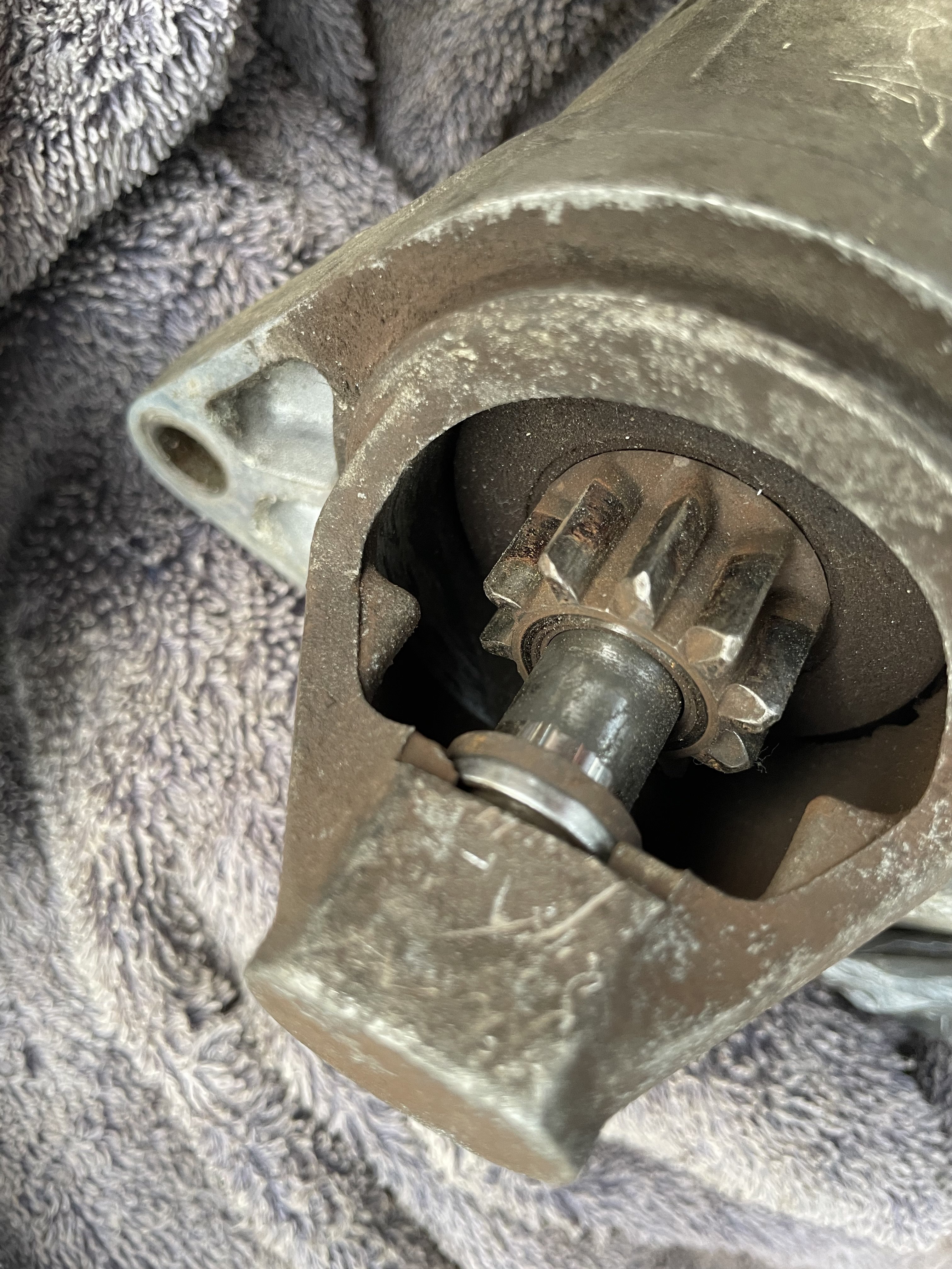

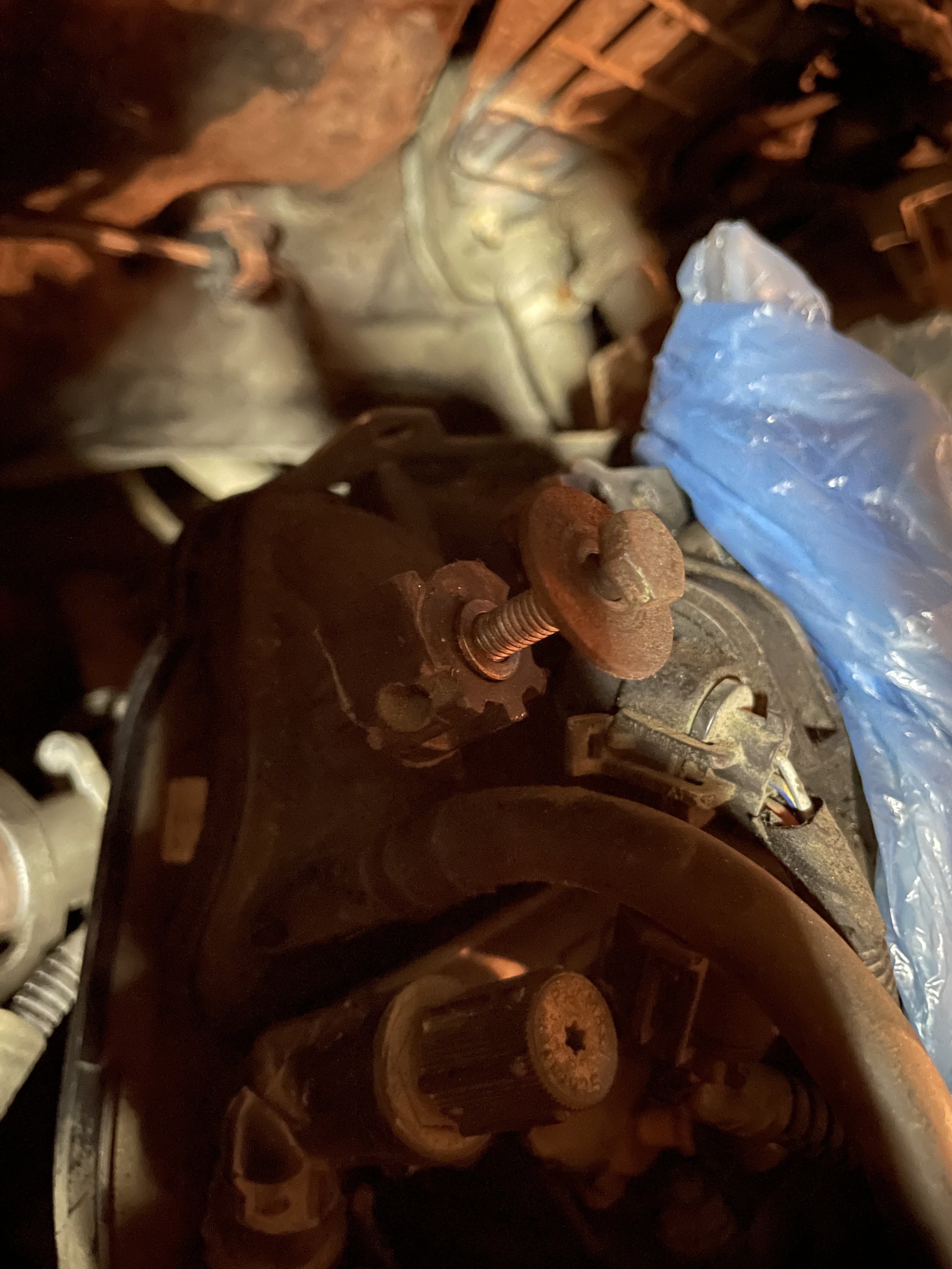

Afterwards I removed the starter motor (with great pain due to the bad position), and I’ll take it tomorrow to be refurbished.
Fingers crossed it will start easyer

Replaced the spark plugs today - I thought it would be easier.

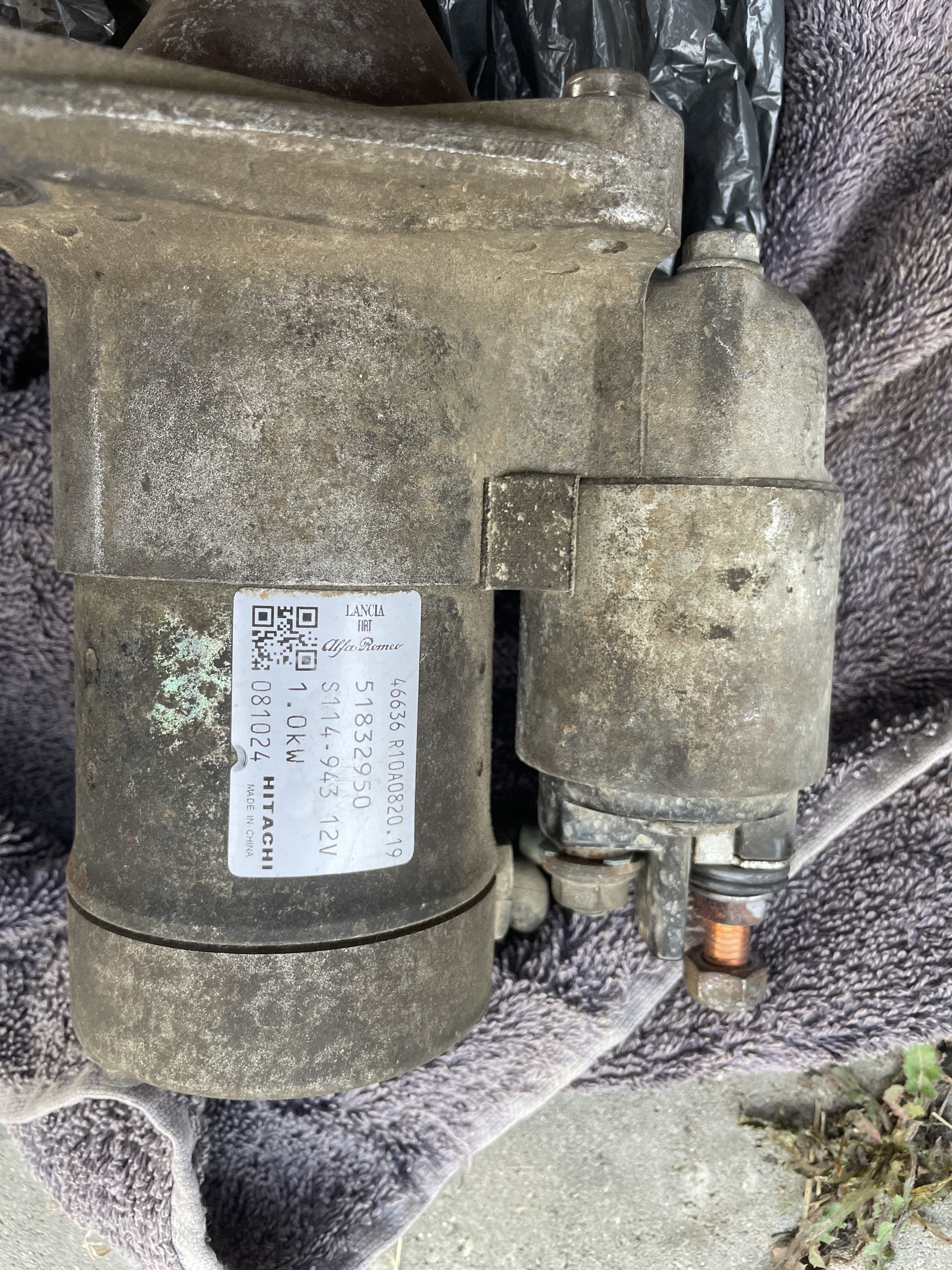

Also, took the starter motor in today to fix it BUT to my surprise, it was too far gone.
No wonder it turned so slow.
New starter motor in. Messed up a bit and had to reposition the ground in it’s proper spot. Reassembled everything back again.
Now it starts right away. Happy how it turned out. It’s my first time working on a car and every little bit brings me joy. 😎

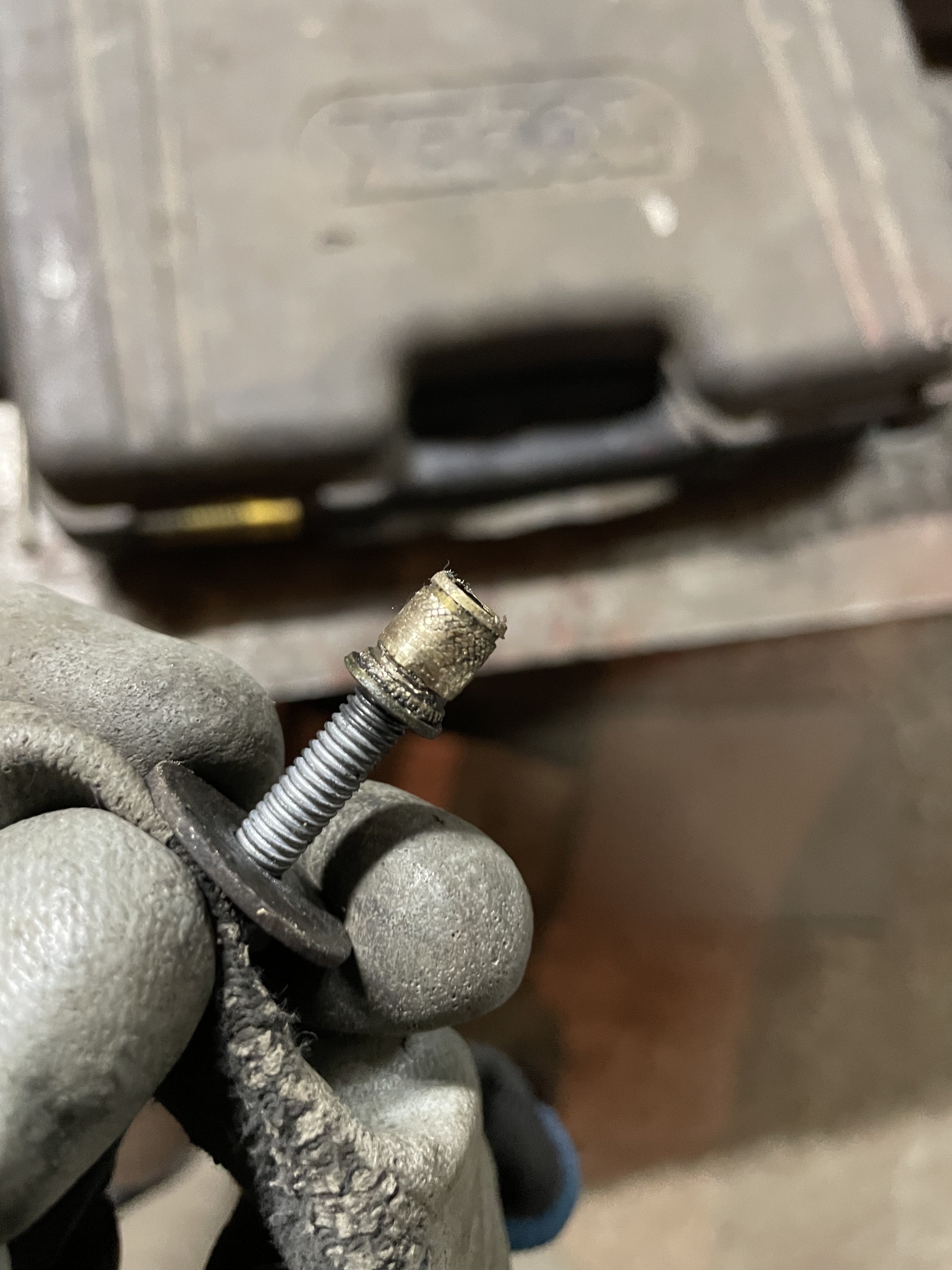

One more thing left under the bonnet: fix this nut that should hold the airbox, so I don’t drive around with parts held together with zip ties 😅

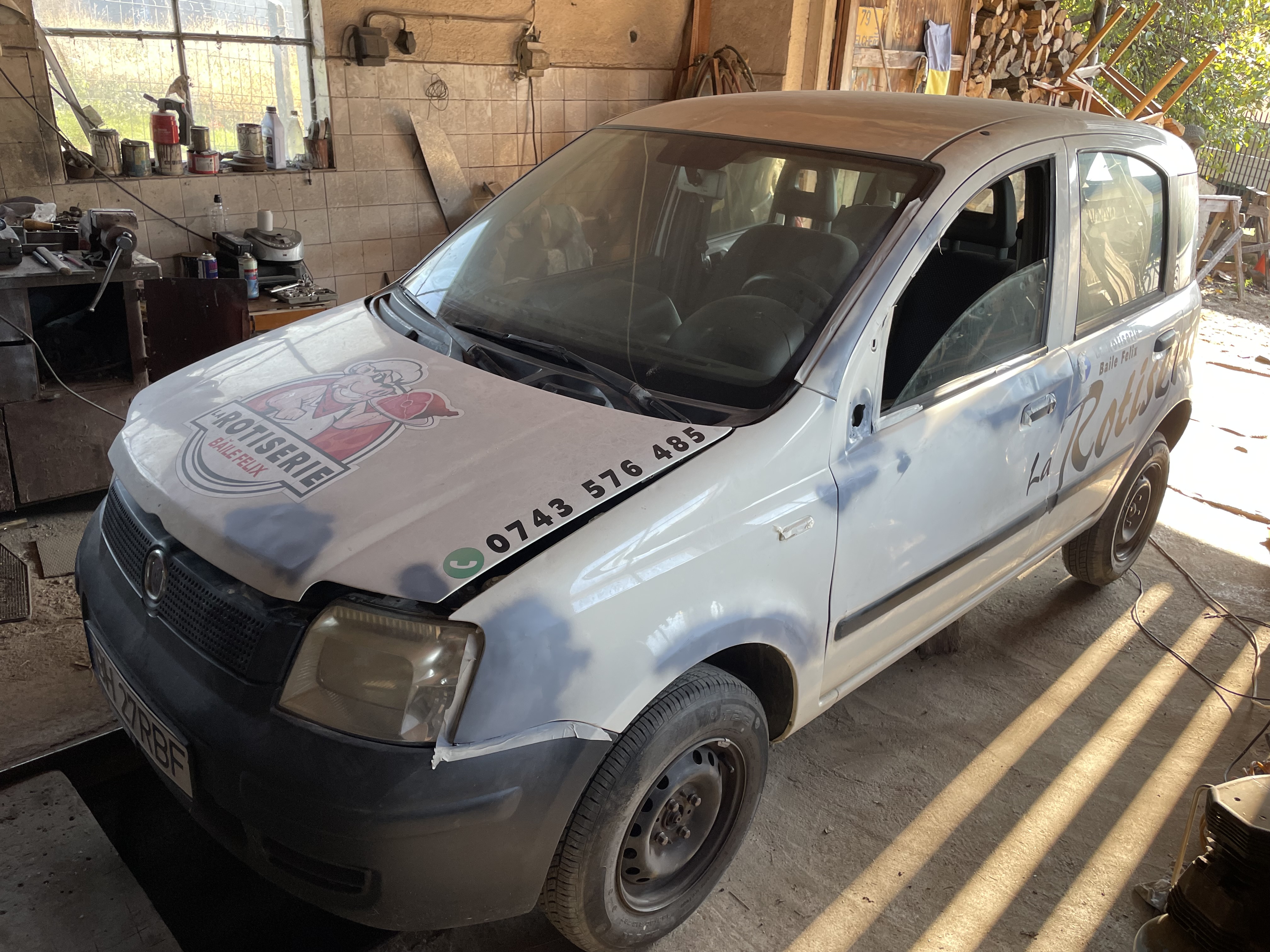

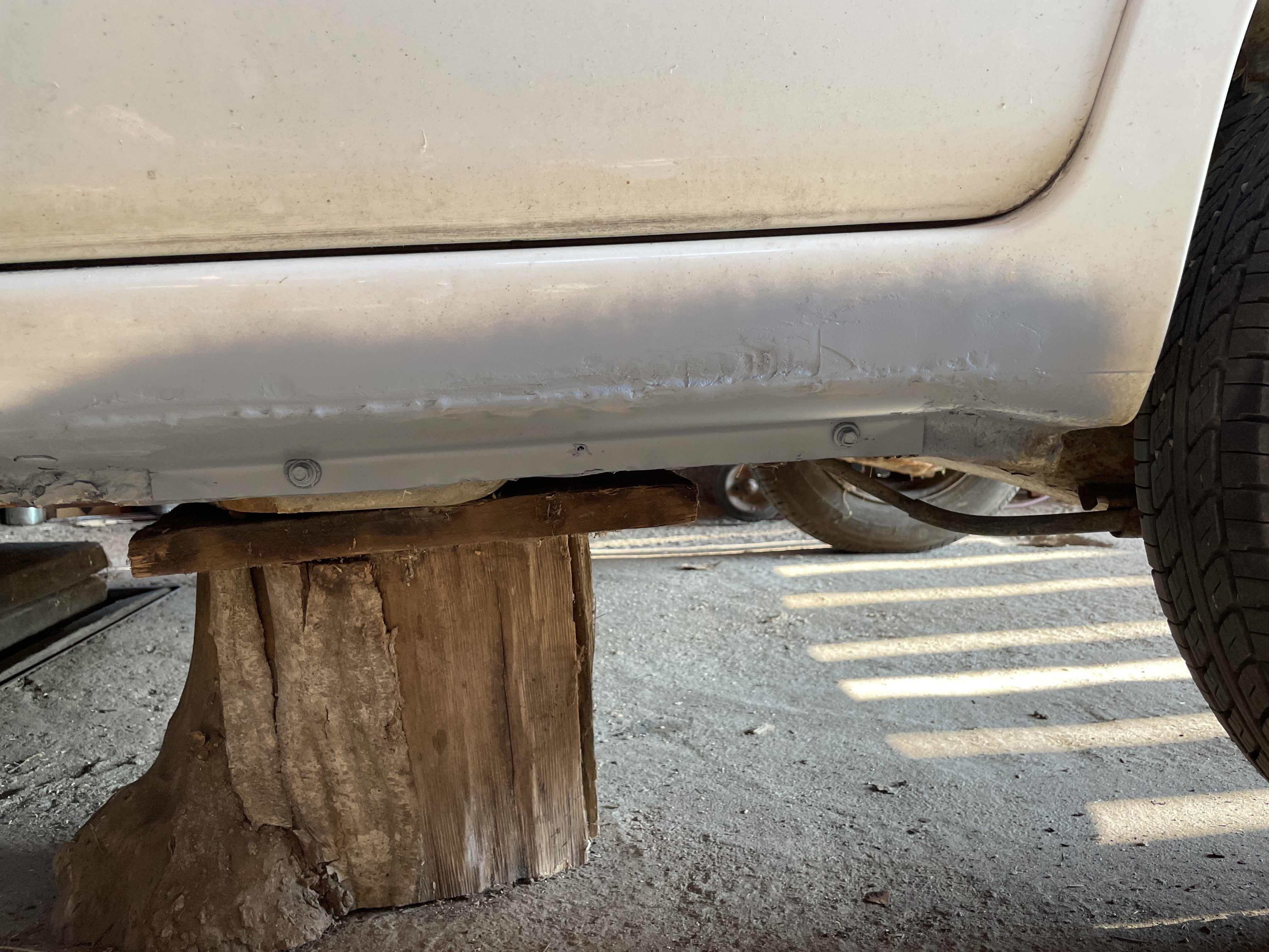

Dad said he fixed de rotten spot in front of the left back wheel. Not to bad…
Some spray pain incoming.

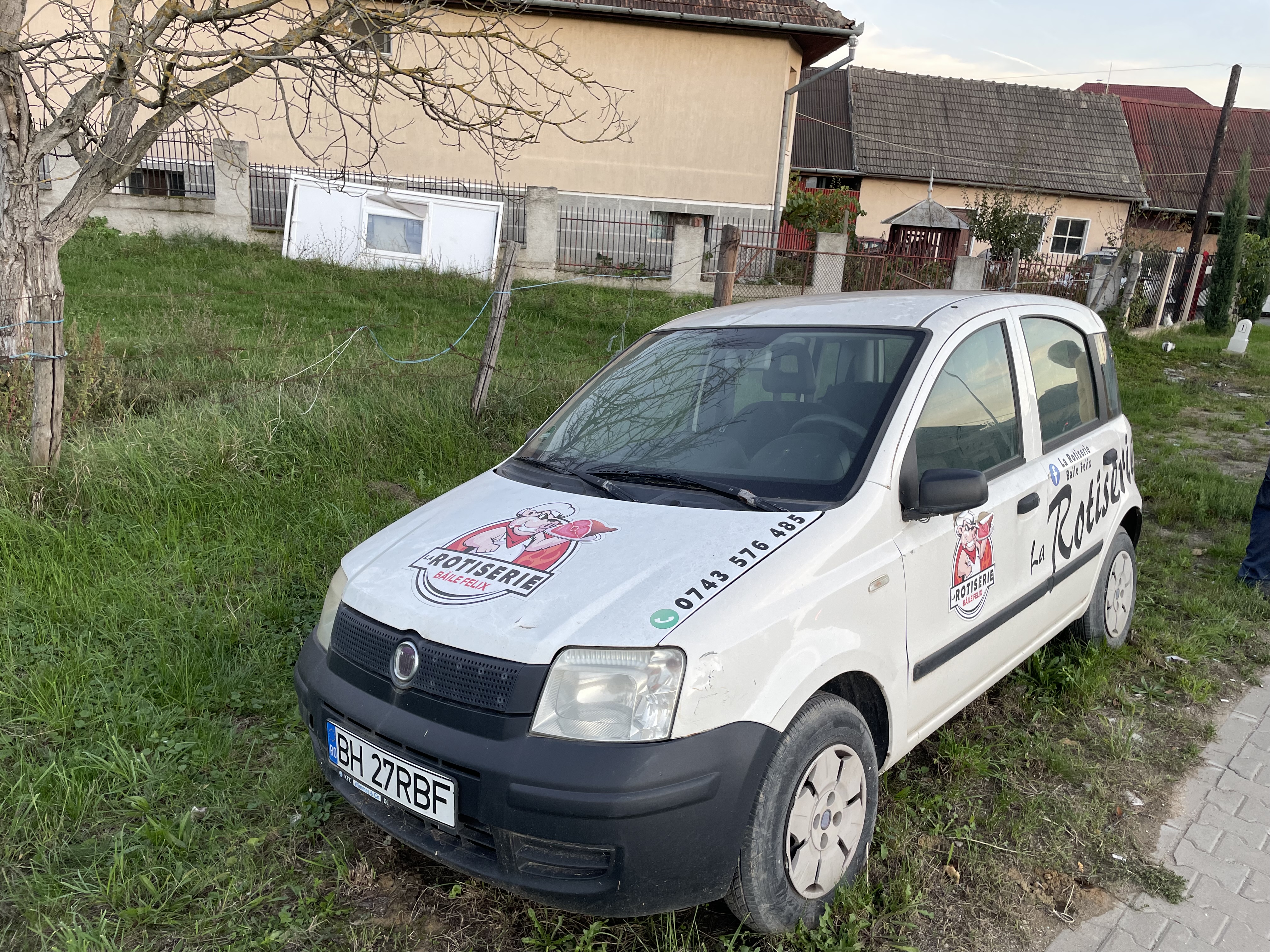

Marshmallow has been through a lot, and while it’s not that pretty to look at, it’s exactly what I was looking for: cheap, accesibile, easy to maintain.
Soon on the road 😎

I think it looks great :)
Interesting to see yours had rust in the rear sill. Some do some don't.
I pour a bit of old oil into the sills through the rubber bung in the rear wheel arch to protect it every oil change. It runs out through drain holes so put something down to catch the drops.
How is the rear axle? The spring pans are usually the first things to rust in the British Isles.
I also treat: engine oil sump pan, coolant return pipe in front of engine, and mud trap behind the front springs.
Had a quick trip by the garage today, and saw my dad finished the bodywork he started.
To my surprise, his painting skills and lack of attention to details is progressing yearly. A poor job overall. Almost worse than before he started but he’s my dad and I appreciate his work. Also, it’s just a cheap car and I’ll do some damage control on my own when I’ll get the time.
I stuck the airbox holder nut with some bicomponent glue a few days back, so I had the please to screw in the airbox.

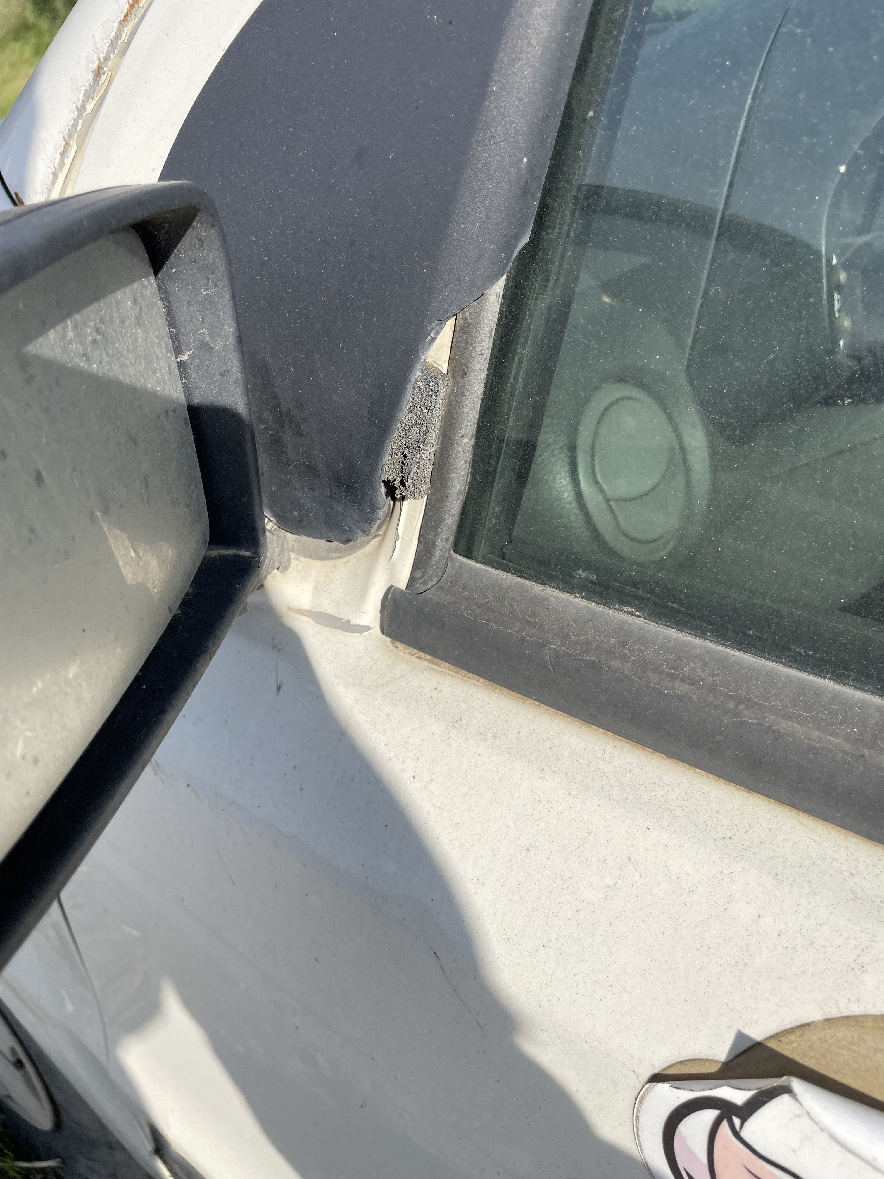

The left side mirror it’s back in it’s place and all I could do was give it a wash and a scrub.
There is actual mud inside the door rubbers, so I’ll be detailing those at a later date.

Hi there, thanks for the tips.
Everything underneath has surface rust, especially since it sit still for ±2years, and grass grew under and around it.
So I'm surprised I'm not Flinstone-ing around in it :)

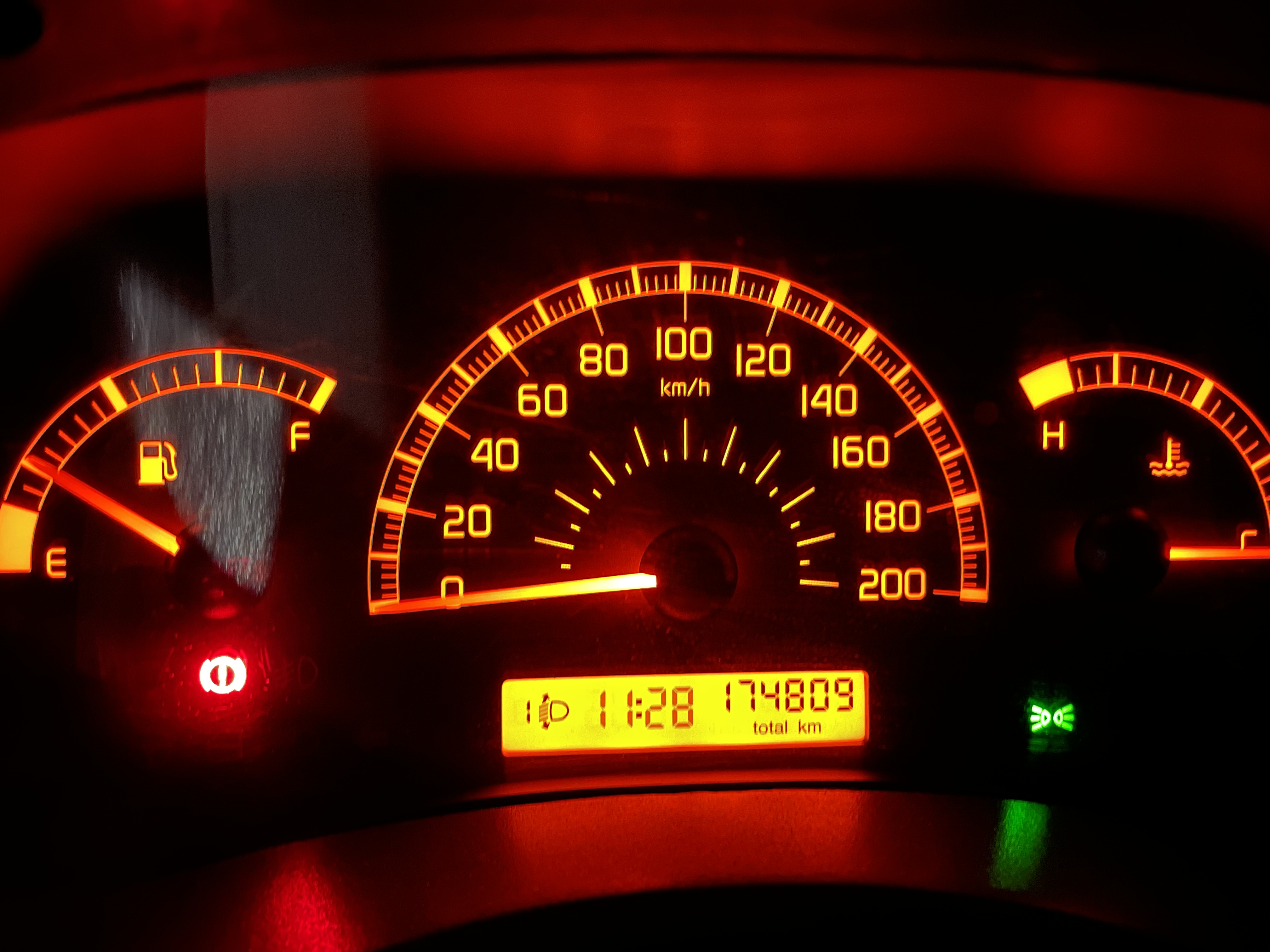

I just limped my way to the mandatory technical inspection (MOT in the UK, ITP in Romania), as it was my first time driving it. I was afraid not to hit anything until it was road-legal. Tomorrow, it will be officially road worthy.
As I stopped, a lot of oil smoke came from under the bonnet and it scared the crap out of me.
Oil had been dripping from somewhere right on the flexible bit of the exhaust, soaking it, so when it got hot... it smoked.
I'm curious to see how expensive that part is going to be: probably some O-ring from the gearbox, adding extra oil if needed, fixing some grinding noise from the front-right axle (or whatever it's called)... also, doing the geometry would be advised, I guess.
