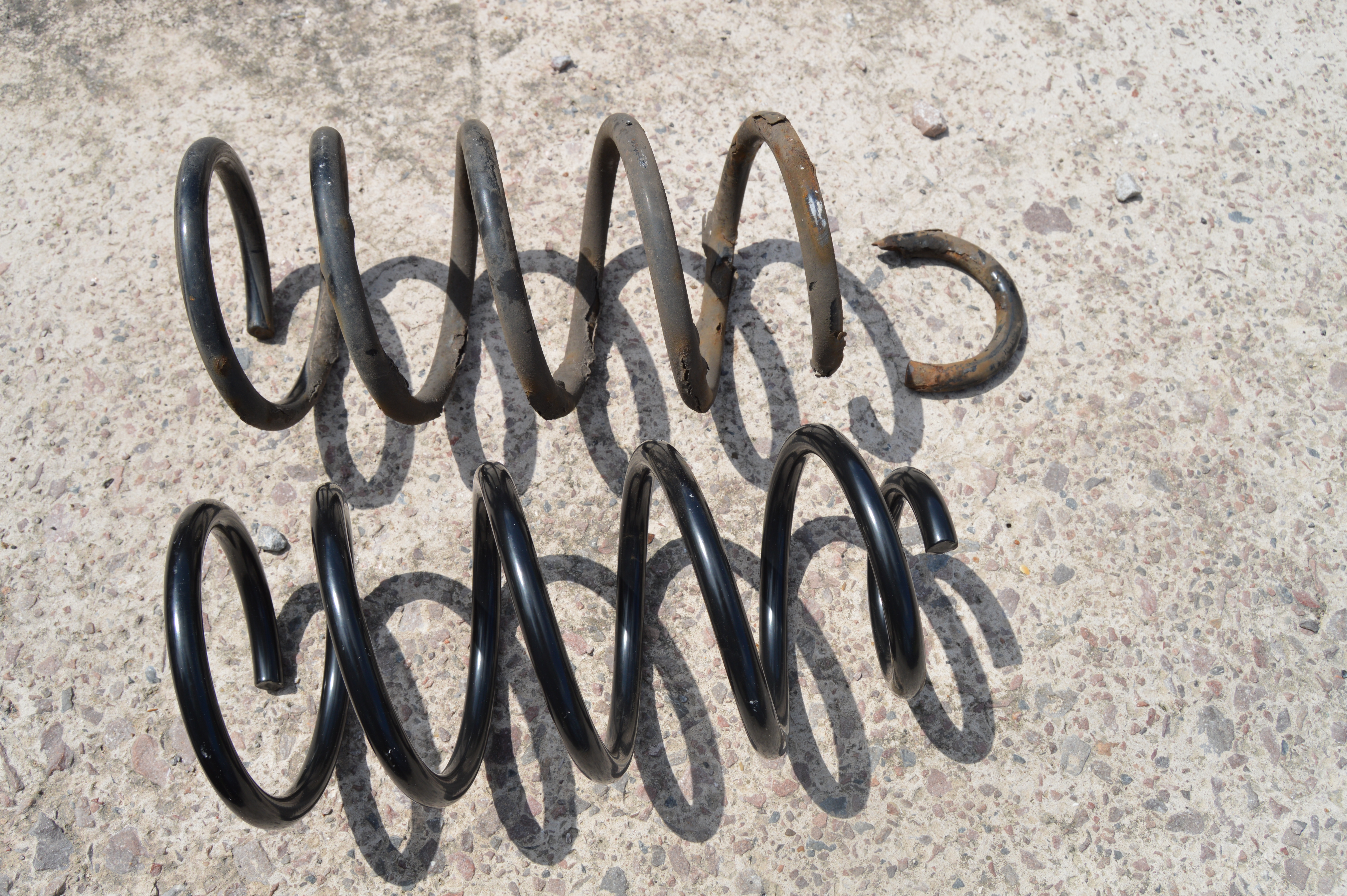

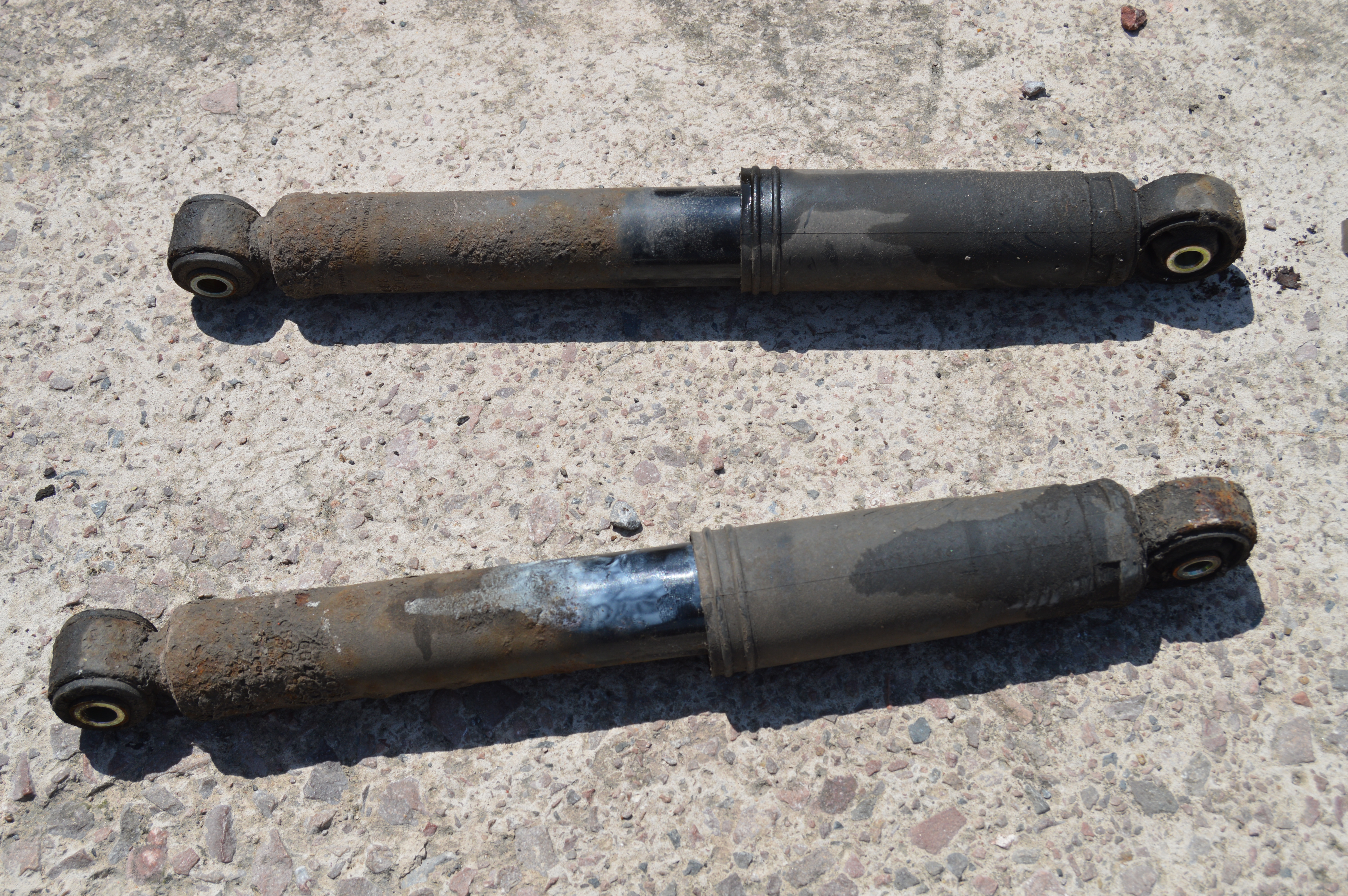

And now i get the Happy ending. 2 New shock Absorbers and 2 new rear springs fitted. I'm Glad i decided to get new springs and replace them at same time as Shocks...turned out the Drivers side spring was broken , but the break wasn't visible until the spring was removed (see attached Photo with the new spring alongside for comparison)...also Shocks were well and truly Knacked, lower one in the photo with the White on it is Drivers side.
New parts make a hell of a difference, either that or they've put a lot more bumps in the road :D
Good part is no more noise going over the bumpiest road i know of locally ( It has potholes, speed bumps and is generally not a great road surface LOL)
