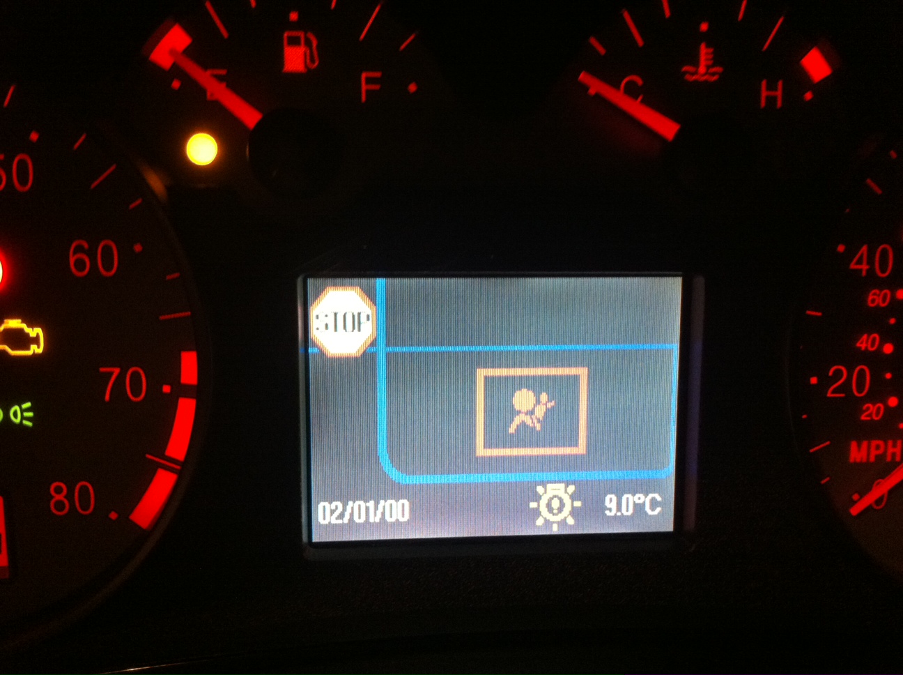

And also this is bugging me because I got the Abarth cluster and I get on the display (it is the colour lcd one) airbag system failure and can't get it not to show (if I press Menu, the text disappears but the large icon error is still there, and can't do anything, can't go in the menu, can't access anything).

LE: anyone knows how can I get rid of the warning off my lcd?? menu button doesn't work, and can't see anything on the lcd :cry: I will add a photo a bit later so you can all see what I'm on about.
LLE: as promised here are the photos (so basically first photo shows what appears on the lcd and second what happens if I press menu ie. just the text disappears):
