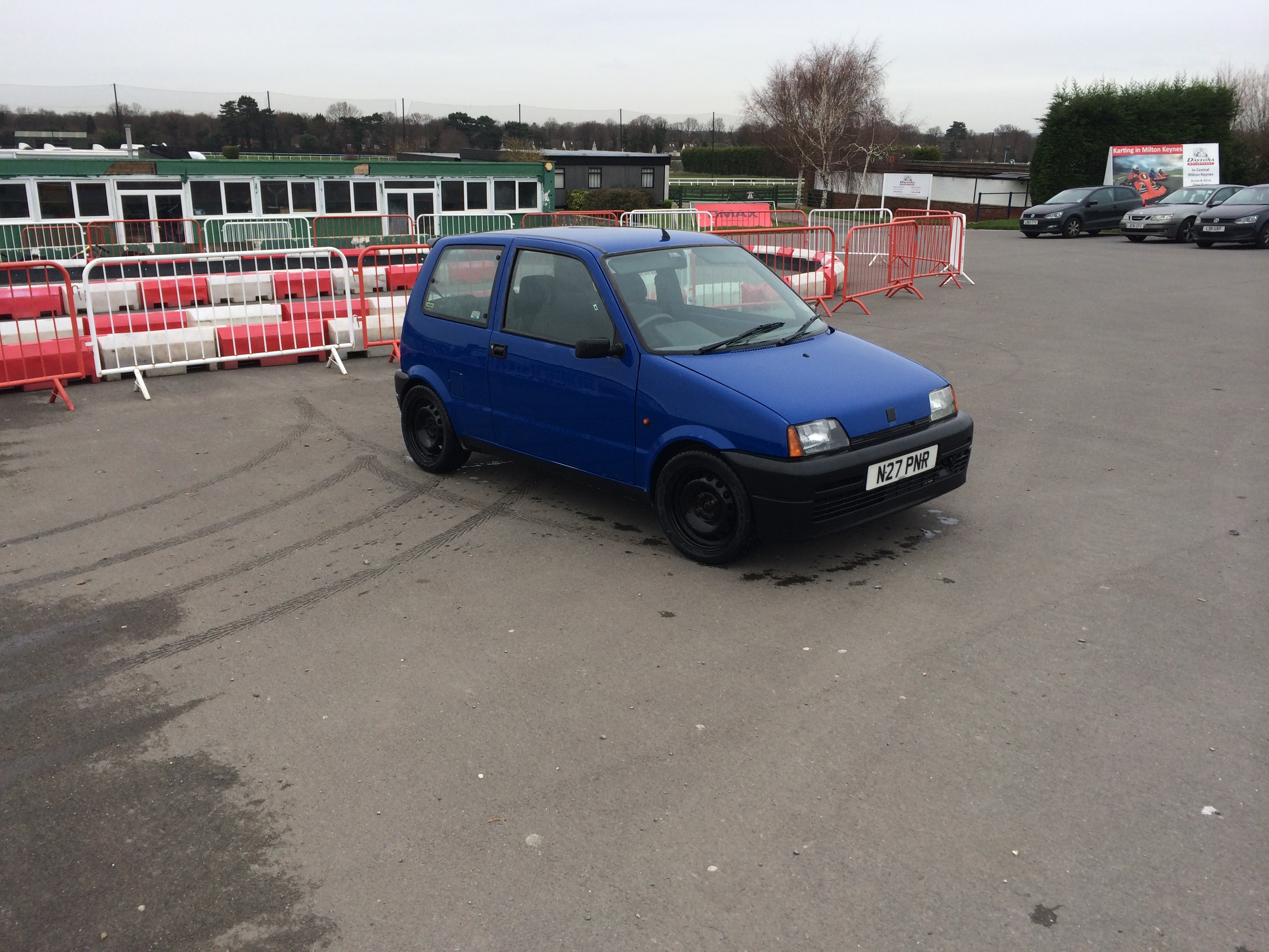

This is my fifth Cinq and all have met their maker under my ownership; written off, stolen or broken for parts. I don't expect this one to fair any better
I bought this Cinq S off a forum member and it already had sei sporting seats, center console and cinq sporting wheels and suspension. The kid had taken really good care of it, clean/polished etc and suspension wise it was like new. Its dirty in the pics but its winter so let me off
The bodywork is a little battle scarred but its totally solid with zero rot anywhere. The paint is hilariously soft even for a Fiat, it pretty much gets scratched by the wind! I live near/in London so ropey bodywork is an advantage tbh as its currently my daily.
I chucked the decent bits on it from my last cinq which was a dreadful ebay purchase that was broken for spares within a week of me owning it.

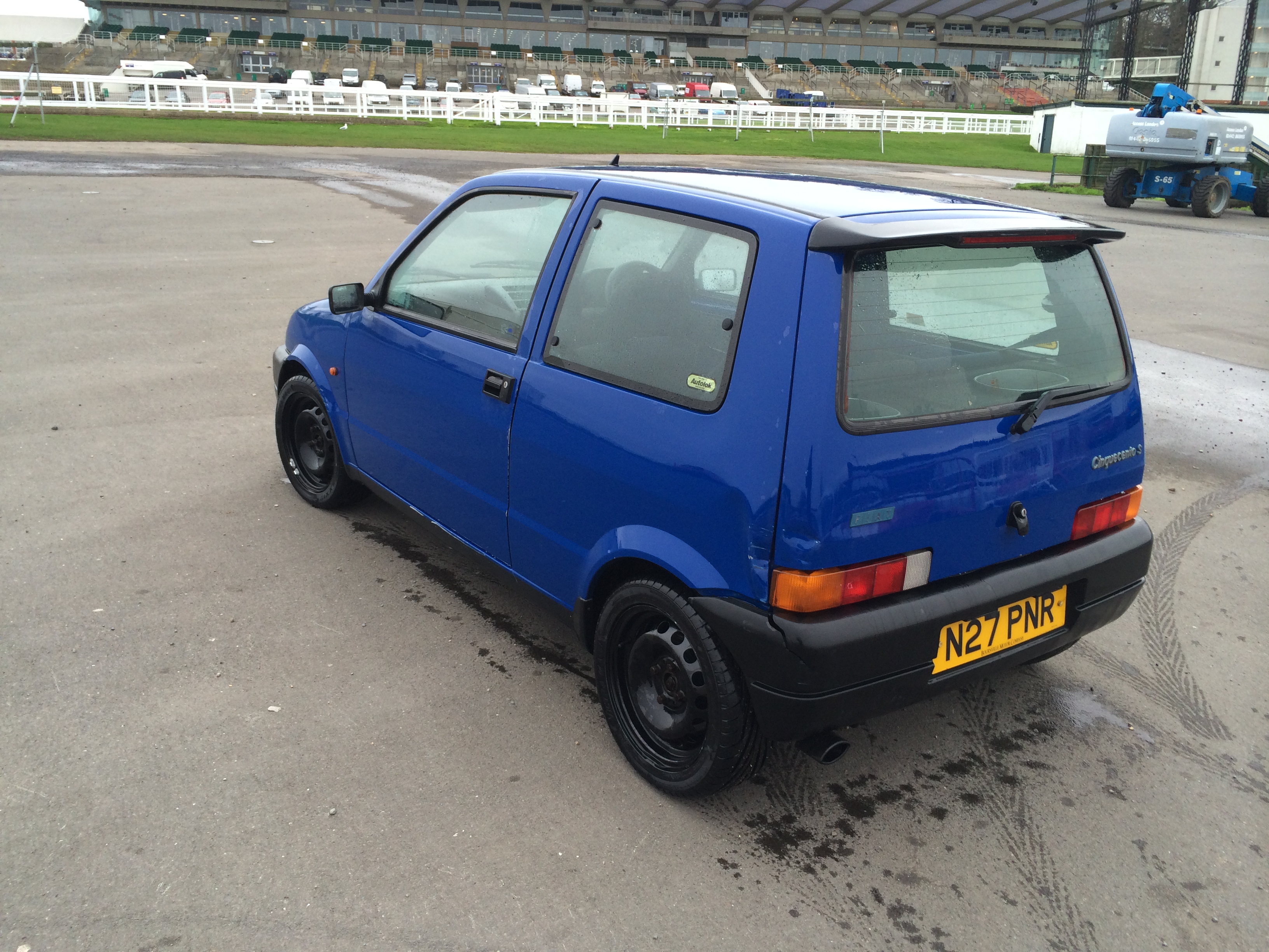

It now has a late P60 engine with the 866 cam, gmax lowering springs, some strongflex engine mounts, sporting clocks with mileage corrected and a standard sporting exhaust system. I've changed it back to orange indicators (from sporting stuff) and will be taking the spoiler off the back when I get motivated.
I fitted a sporting front ARB to it which has highlighted that the nankangs its on are dogs**t! Understeer is now the only handling trait it has, I suspect the springs are too stiff and not helping as well.

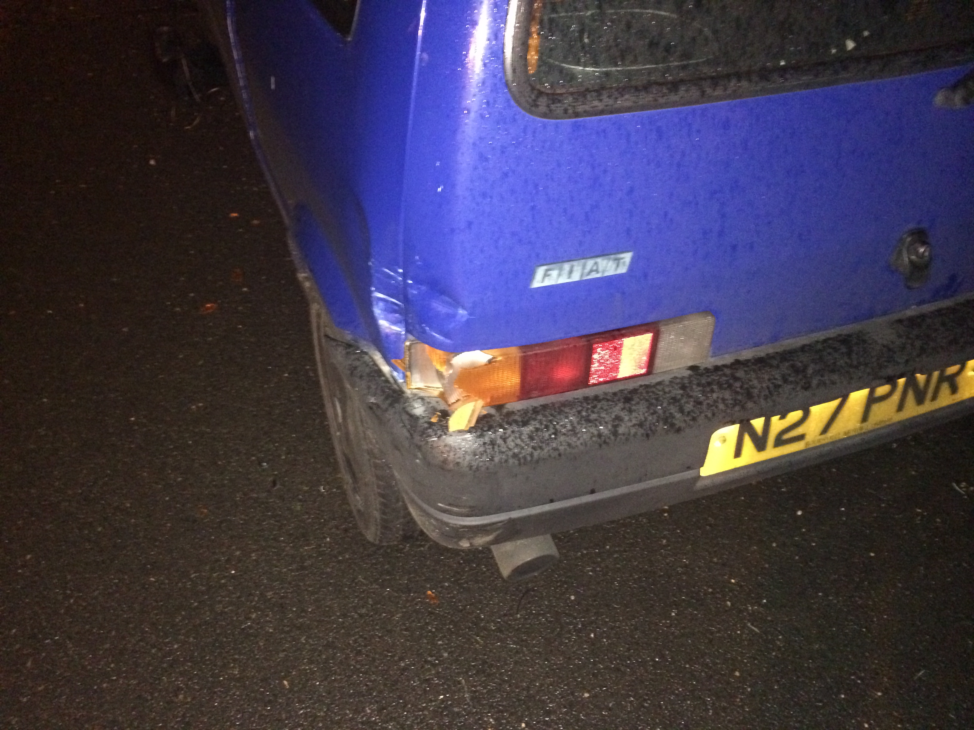

Poor little car's life has been cut shorter than I'd imagined.
A woman backed into it in her fiat 500, its gone to the insurance company but I will be amazed if they decide to fix it.
Bit gutted really, was just about ready to start fitting all the bits I'd been collecting for it, now will have to wait and see what happens and probably going shopping for a new shell.

Yeah I have the car back. Damage is only cosmetic.
Thing is that rear panel is pretty badly kinked. The body is certainly not the straightest anywhere else in terms of panels and the paints not great either.
May be more cost effective to start with a new shell and get a better end result.
Not really sure yet. For the time being a new rear lamps going on.
Annoying more than anything, still plenty of options
to be fair, my cinq turbo had damage almost the same on the drivers side - was never an issue for mot's and the like and most people on here never knew cause there just is any photo's from that angle.. So i doubt its imperative that its sorted right away.
I guess though the best plan of action would be to go in search of rust elsewhere, the usual places mainly. If its all still solid then i would defo keep it - if not, and it pains me to say it, might be easier for you to cut your losses and get another one - problem here is actually finding a really nice shelled cinq in the first place.
