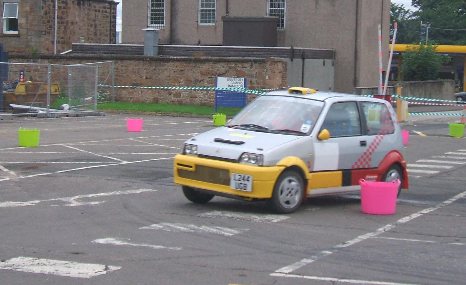

While every one else has been enjoying themselves in Stamford, I have been out doing an autotest in the Cinq.
2nd in class, doesn't seem too bad for a first time out, and not too many items on the inevitable 'to do' list.

9/10 for techy internet geeky skill...dropped one as there is no sound ;)
Looks great fun though and that thing looks like it is skating on rails! Theres not much body roll which I'd expect quite a lot of on a rally car, or do you have adjustable suspension?
I can just imagine all the squeals from the tyres sliding and spinning :D
Kristian
That would be the Leda coil overs on the front, with adjustable spring pans and Leda rears, yup.
The video wasn't mine, I was driving, it was taken on a standard digtal stills camera by eldest daughter.
I was using standard Cinq tyres on the front with 155/70 13 M and S rears, pumped up to 40 psi.
Cheers
D

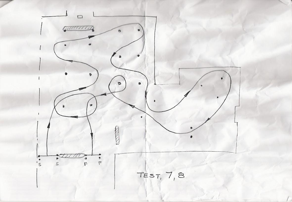

Brilliant :D One question though, how do you know where you're going?! Looks like a maze of green and pink bucket things :D
Well thats what it is. We are given a map of the layout before hand, I'll maybe go and scan one. We walk the test a couple of times first then drive it. No practising is allowed, although we do each test three times with only the best two times to count.
