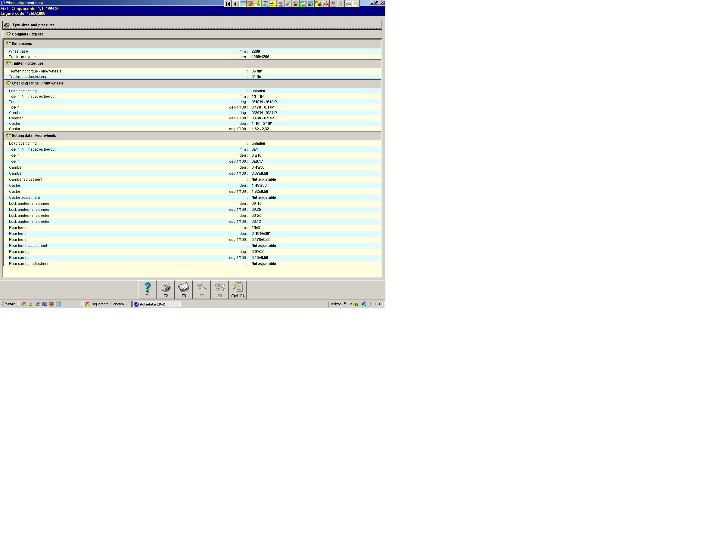

No more fluid loss, but I haven't used the car much.
Tracking done by 'mark one eyeball' method. Seems much more stable and is pulling in the right direction.
Autotest tyres fitted, better post my entry form off tonight.
