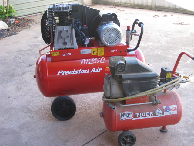

thepottleflump - here are some comparison pics of my new and old compressors. The new one is about twice the size (height and length-wise) and has two cylinders side-by-side, with belt drive.
After a day or so, the regulator of the new compressor started to leak. :( I was a bit upset at the thought of taking it back to the shop - such an inconvenience - however this is New Zealand and at the National Agricultural Fieldays, I bumped into the guy that sold it to me! I asked him what to do (warranty etc.) He said take the regulator off, clean it out, and if there's still a problem, bring back just the regulator for a replacement (y) Turned out that the top housing (under the red knob) had a burr on the plastic that wasn't sealing against a seal. I sanded it off, put it back together, and it's perfect :)

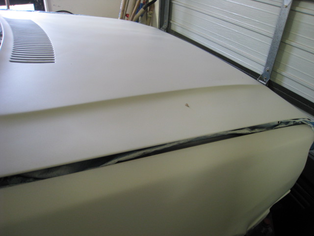

Meanwhile here's an update ;) Lots of filling and sanding of the bonnet - the air-powered D/A sander is MAGIC - just so much faster and seems to give a good even finish, like using a block. The filler I use is a special smooth type ("glazing putty", with blue hardener) and I think I've been using it too thinly, as I'm onto about the fourth application now for some of the dents!
Front-right wing also proving slow due to quite large and shallow dents. I used a block of wood the other night to push some of them out, then put on several coats of primer, so hopefully a fairly fine grit (180) on the D/A sander will show me where I need more filler.

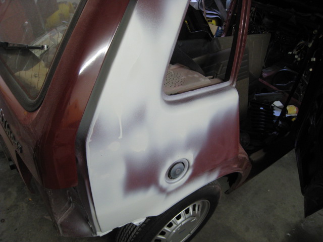

By this time it was now dark, so I put some primer on the various repairs basically blind (just sprayed where I thought it should be) - the finish was surprisingly smooth and I can imagine, with a nice thin topcoat, it will be easy to get a glass-like finish.

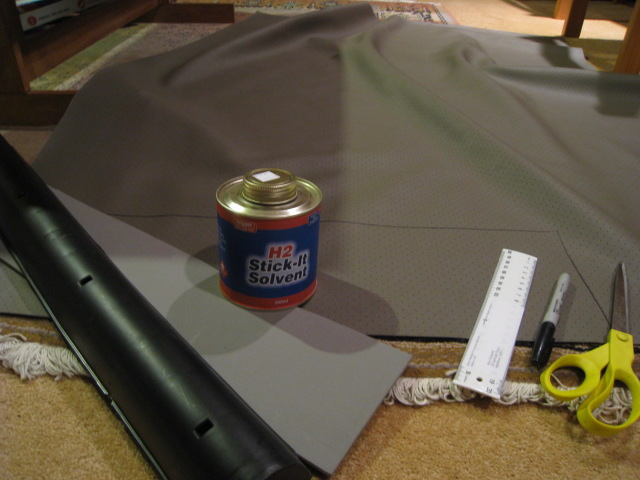

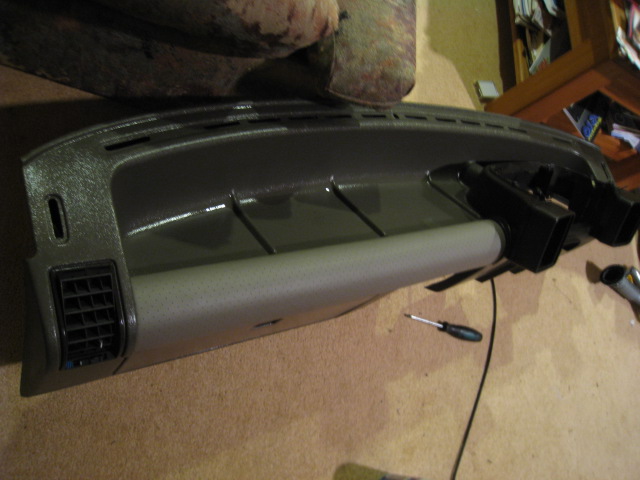

As a side-project, I decided to re-cover the infamous Uno dash roll (from the NZ sun, always split apart with holes, except on the early Uno 70S with the grey interior that has better-quality vinyl!) It's simple to remove: four screws hold the black plastic former to the dash, but it's very difficult to reach the screws with the dashboard in the car. I think it's easier to remove the dashboard... which came out pretty easily once I used a screwdriver from underneath to push out the clips in the top corners - thanks Chas - and once I remembered the screw in the glovebox...
The material came from a general-junk shop named 'David's Emporium' - they have a large selection of surplus fabrics and vinyls. Discounting hot pink and lipstick red, and narrowing it down to brown, I had a choice between a bright reddish-brown, reddish-brown crocodile skin, metallic bronze (but without a texture), or matt, textured, light-brown/grey with holes. The last two were difficult to choose between, so I bought both (only a few dollars after all). In the end the light-brown-with-holes material seemed more tasteful.
The original roll doesn't use glue; the vinyl is fitted in a closed sleeve that includes the foam. Instead I glued closed-cell foam to the hard plastic former, up to the ridges, and then glued the fabric-backed vinyl to the foam just to be certain. I think it's important to get the right hardness of foam - needs to be pretty firm to retain its shape properly.
The foam shop had accidentally sold me the cleanup solvent rather than the glue itself, so another trip back was necessary. This sort of running around wastes time & petrol, and is a good example of why you should keep a stock of various glues and materials at all times, ready for impromptu projects :)
Next on the agenda is to finish repairing dents and priming all the panels. It's raining this week, and I have work to do, so there probably won't be much progress in the next few days! The right-rear quarter is nearly finished now. The bonnet still doesn't look good, but I think much of the patches will flat out within the primer.

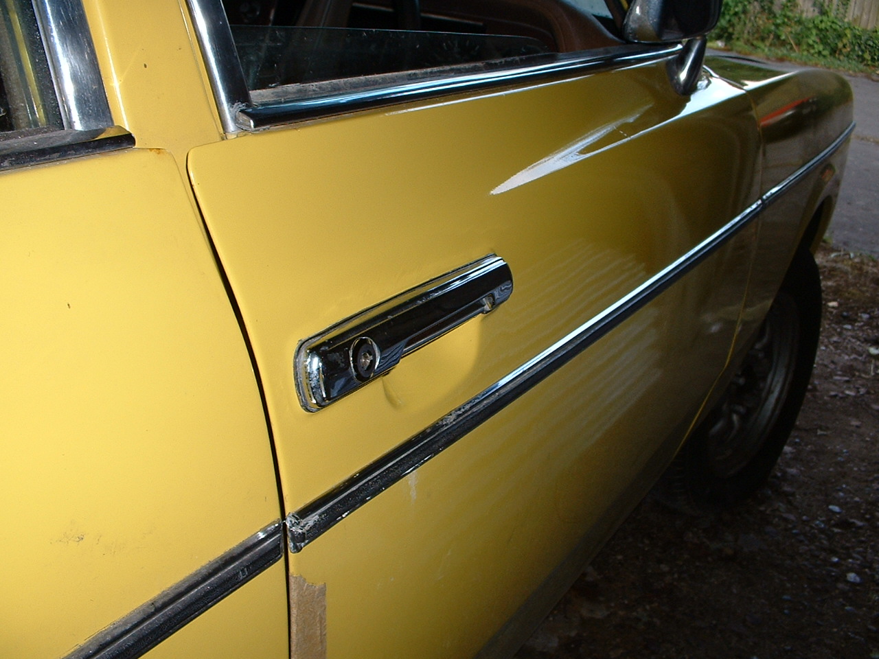

As an aside, this is what I've been working on today:
It hasn't moved or started since approximately February 1998. Yes, that's over ten years ago! I feel old and embarrassed that it's been sitting there that long :eek:
Opening up the bonnet that was virtually seized through lack of use (thank god for WD40), this is the engine that hasn't turned in a decade. To give you a clue, this is NOT the original engine for the car, and the car was never meant to have one this size :devil:
After much fiddling around and cleaning of corroded connectors, freeing off belts and stuff (alternator and water pump seized) plus judicious use of 'Easi start' it coughed and spluttered a few times. I tried jumping it from the Uno's battery as well but still not much more than some promising kicks. Then after giving a few more goes it roared into life and settled to a deep rumbling tickover. The Kraken Wakes!!! To be honest I couldn't believe it. I thought the engine would've been siezed solid after sitting in a damp lock - up for over ten years but there it was rumbling away in front of me. Joy!
Problem now is that the brakes are absolutely siezed solid and I can't get the car to move. Even sticking it in drive (it's an auto) and giving it some stick wouldn't move any of the wheels, and we are talking around 140bhp here by the way.
So as long as the underside hasn't rotted away then I may have a non Uno shaped project on my hands. If it goes ahead then I'll make up a thread in the non - Fiat section of the forum, but until then I'll keep you Uno boys and girls guessing as to what it is.

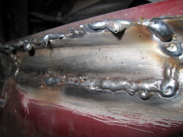

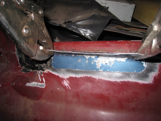

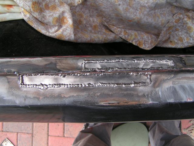

I forgot to mention that last exciting spot of welding (is there any other kind...) Yes it really was - I have shielding gas now, so I've had to re-learn how to weld and now I reckon I can weld nearly as well as James can :cool:
I like to crank the power pretty high (to get a continuous arc rather than splat-splat-splat) and wire feed right up, which helps to fill holes and avoids the wire melting back up into the torch. Of course there isn't a dial for the power - there are just two switches: 1 and 2, and MIN and MAX, so I like 1 & MAX - it's an Italian welder, can you tell...
Then I make a big blob that penetrates into the surrounding metal. You can see in the pics below that this worked pretty well at the right end, and somewhat less well where it blew through elsewhere and had to be blobbed-over. But that's a strong repair, even after grinding. I welded to the edge of the existing lip that the rubber seal presses over. The welding to the edge isn't continuous (the edge kept melting away) but it's more frequent than the original spot-welds.
Note that I decided to put the patch behind the hole. James put the smaller patch on top (left of the tapped hole). On top is probably neater but behind is probably stronger and can always be covered up with filler without interfering with the fit of the bumper. As a matter of policy, I always etch-prime before I apply filler. I have never had a problem with filler coming off, but I have seen many other jobs where steel rusts under filler.
-Alex

This is the last bit of welding I did 2 or 3 weeks ago in the same place as you. Your welding looks reasonable on the bottom but a bit blobby on the top bit. Welding thin bodywork isn't that easy, bit like foil, and I found the best technique to do short "pulses" of welding. Anyone can do a nice bit of welding on clean bit of 3mm sheet metal on a bench, it's welding thin panels lying upside down on the drive that's bloody difficult as you obviously know :) That piece in my picture is butt welded, just a thin skim of filler to try and hide. I always primer before applying filler like you. Not very good with filler, tend to loose patience trying to get it perfect.
What sort of gas have you been using? I had a load of Co2 which I was getting on quite well with but recently swtich to a light Argon/Co2 mix and now need to readjusted my technique accordingly. Sounds funny but found you need to use your ears as much as anything to get that nice sizzle. Spitting or popping is normally dirty metal, wire speed too high and the wire burning back, maybe not enough power? My welder has 6 settings, 130Amp, for bodywork I never go above 3. Also I'm using 0.6mm wire which I find better for the thin stuff. I tend to set the power and then twiddle the wire speed knob to get the right sound.

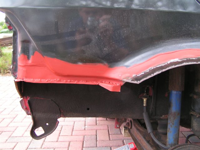

I was quite pleased with this welding. Repairing the rear offside arch which was mostly missing. Anyone need any welding done?
Hi thepottleflump,
That's very nice welding - and you're right, much neater than mine - however I think you have welded from above, under a side window, which is possibly easier than the rear tailgate lip :) I find the moment I have to weld upwards (the top edge), that's when it goes wrong.
The gas mix I have is CO2/Argon/Oxygen, it seems odd to have oxygen in there! But it definitely works better than when there was no gas at all.
I shall try adjusting the wire feed more precisely next time - good idea.

Welding upwards you tend to need a little more power, knock it up a notch. Yes welding from above is so easy with MIG, welding half blind lying on the floor is much harder.
The big bottle I just bought also has a very small amount of Oxygen in it, so I'm guessing that's normal. Can't remember the exact mix but it's mostly Co2, a bit of Argon, and a tiny bit oxygen. I only ever did a tiny bit of gasless but yeah for bodywork it should be significantly better.
