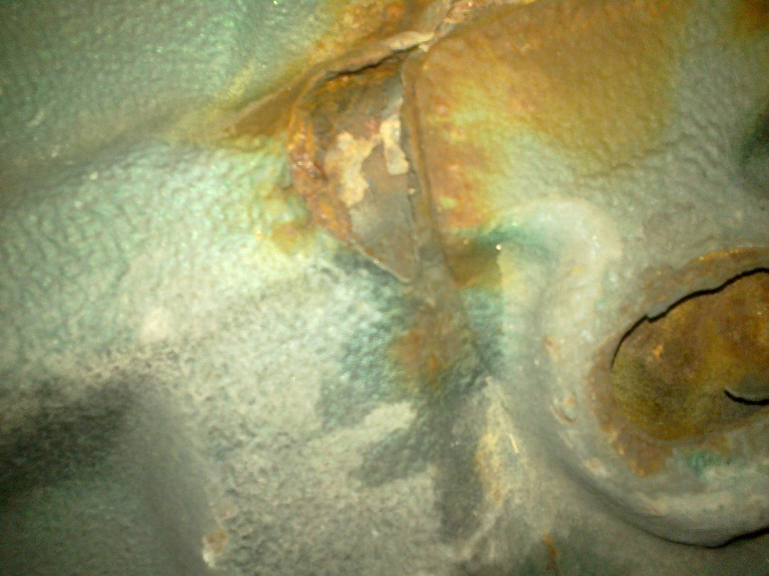

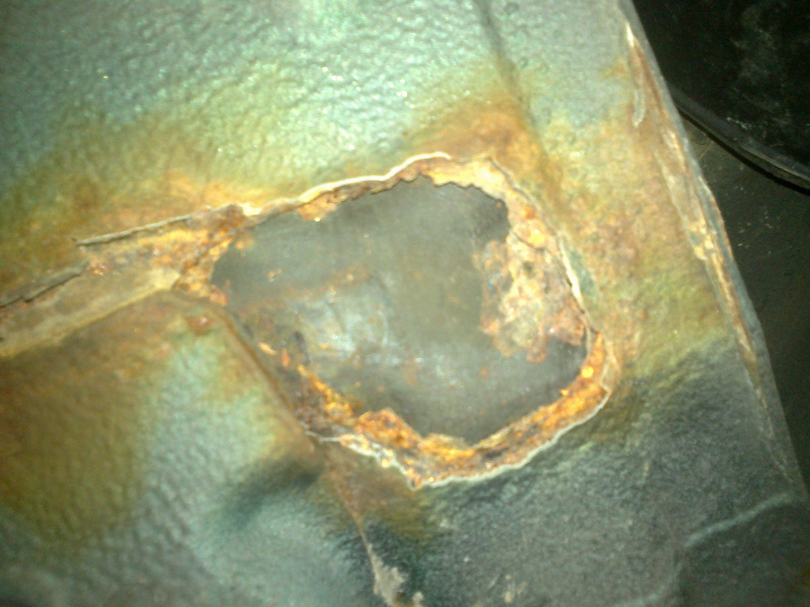

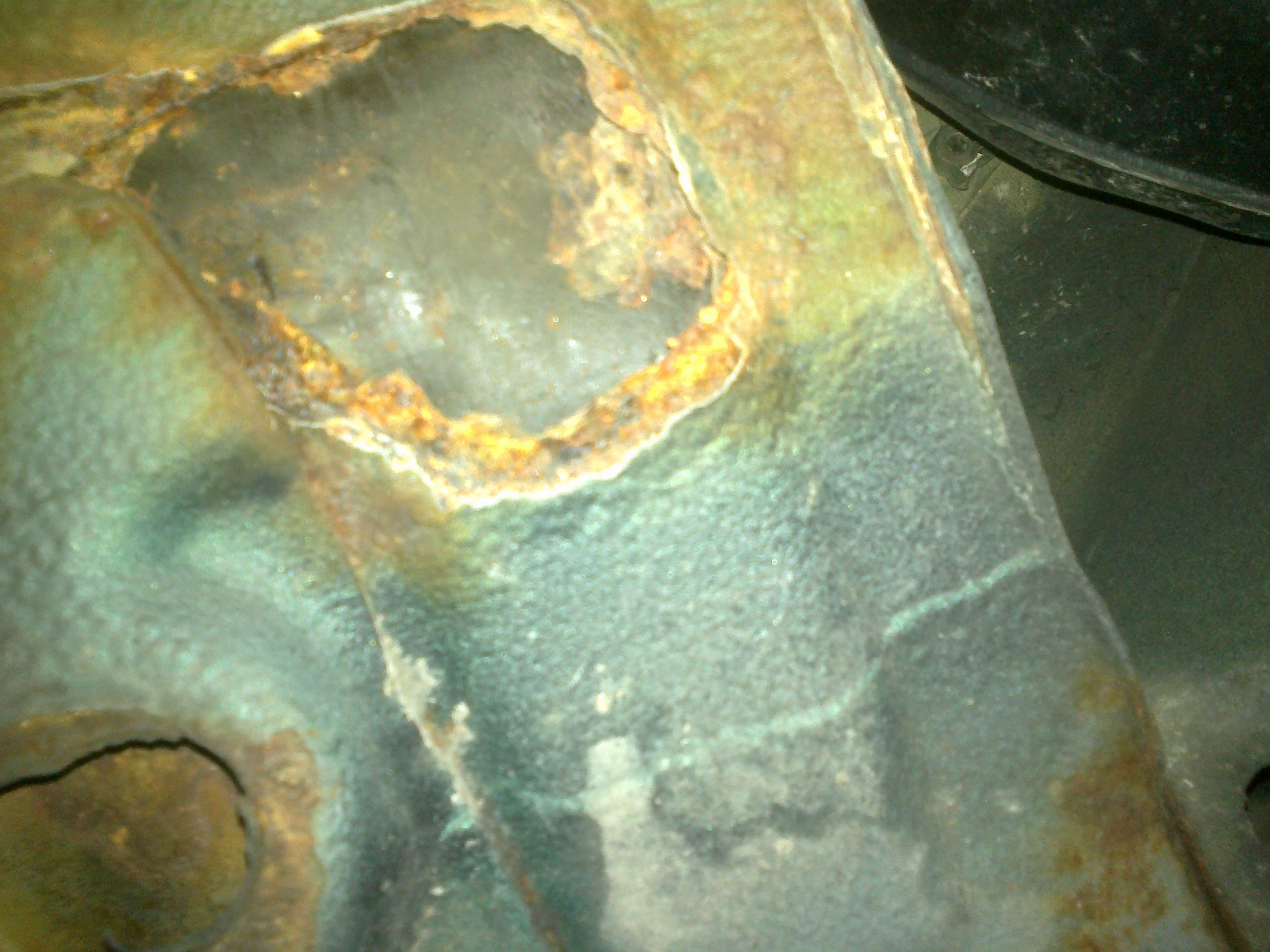

found a hole caused by rust, u can poke right through it and hit where your legs go when u sit in the back, took it to a free mot and the guy said he would fail me, he advised to weld some plate over it
mot fail, while other rust buckets are driving with no worries

how much work am i looking at here if i prepare everything for the guy to weld a plate on it?
That's subjective. A 10p sized hole in my mate's Micra ended up being the size of an A5 piece of paper by the time I cleaned all the rust out.
That cost him twelve beers instead of eight. ;)
