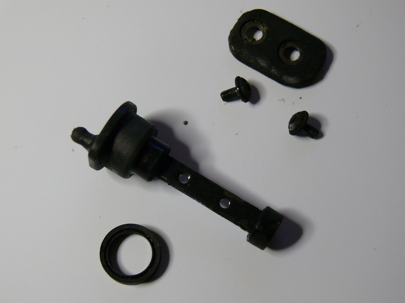

Another month another problem this time the notorius swirl flaps.
Can anyone tell me if the rubber sell can be replaced?
I saw a video on youtube a guy change them but he didnt say if he change the rubber oring or the flaps themself

I searched on ebay but i find just for the rod.My problem is with the flaps they loose preasure and the oil and dirt make them stick.
I wanted to knkw if its posible to change the o ring without buying a new maniflod.

I made a PS to earlier message, but was too slow, You can get a metal part that replaces the plastic bush the o-ring fits.
example for a broken bush
http://www.ebay.co.uk/itm/221491566737 with instructions
http://www.x8r-instructions.co.uk/Va...structions.pdf
Robert G8RPI.

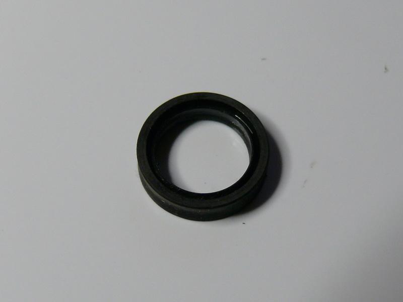

This are the o ring that im thinking can be replaced and solved the problem with the oil leak around them and the loss of preaiure around them.
And if its possible we dont have to buy the complete manifold just chande the o rings and solve the nototorius flaps

The third picture is not of a Croma swirl flap. Croma flaps do not (should not have) that screw mounted flap. This is typical of the flaps on some BMWs where the screws work loose and get ingested causing much damage.
The previous video shows that the Fiat Croma/GM ones are a solid moulded/integral units.
