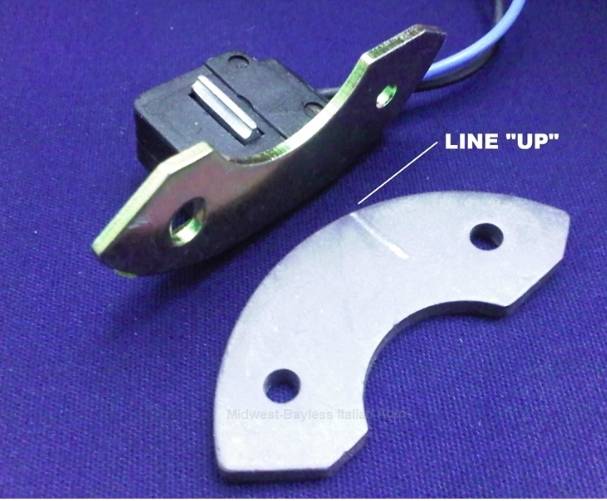

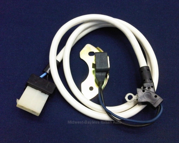

Here's some pics (from the Midwest-Bayless website) of a magnetic pick-up for the 124 Spider that show the correct installation, note the orientation of the 'base magnet'. . . .
