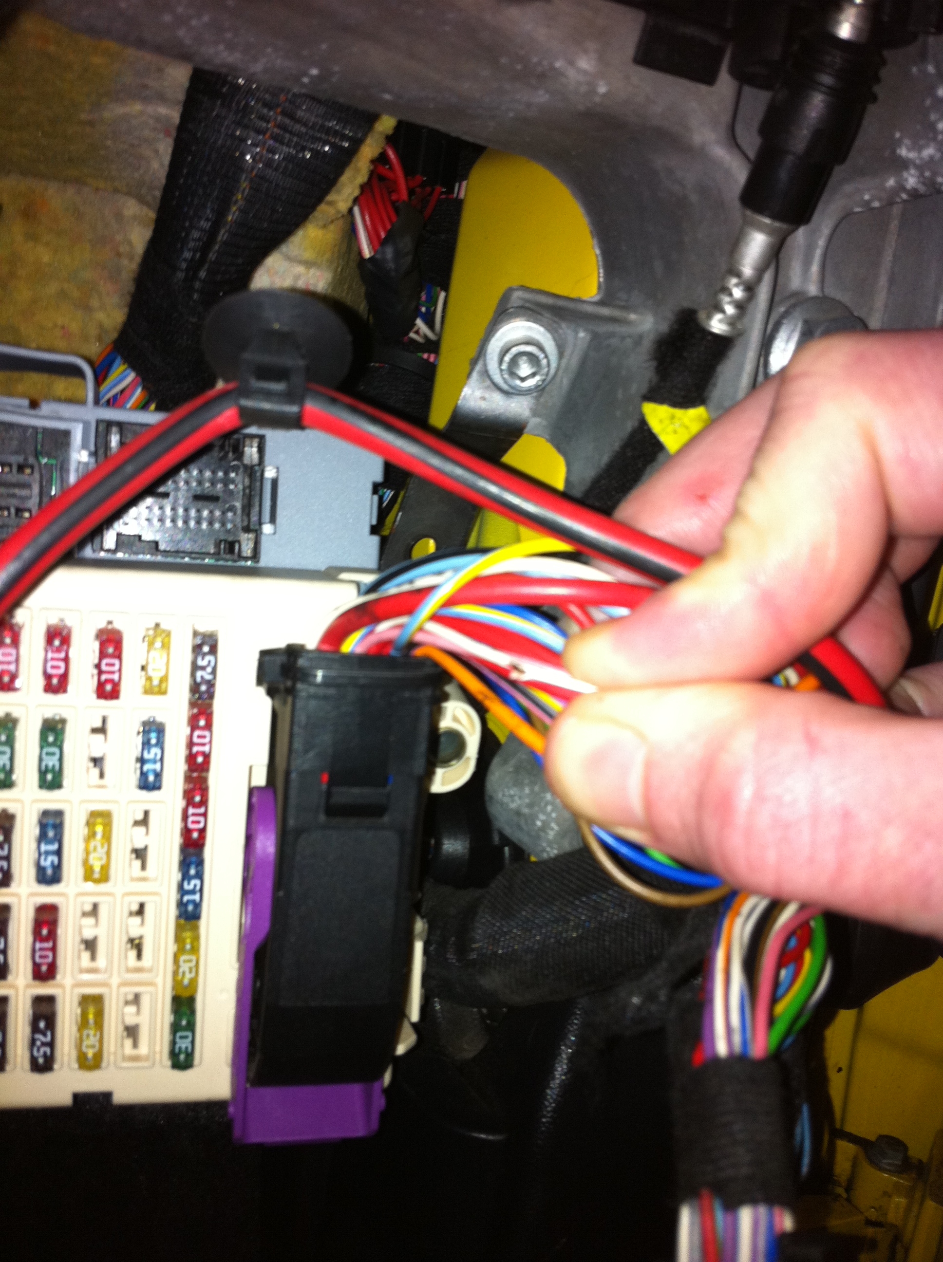

The relay in the rear fuse box, two wires slot in underneath that relay and they are black/green & light Blue/Yellow but can not locate these in the front of the cars fuse boxes

The fuses are both fine, the black/green wire should connect to point 86 of the relay

In relation to "both can lines" I meant one can line from each of the seats instead of both and the pink/White can lines were needed to be connected and these were connected to the fuse box under the steering wheel off the right connector of the three that are there and it's the only pink/White cable there.

The Light Blue/Yellow (Yellow/Blue in your list?) wire comes from ignition activated relay T12 via fuse F52, (both in the dashboard fuse box) and goes to terminal 85 of the large square relay T21 in the rear fuse box. Switching the ignition on activates relay T12 which in turn activates relay T21.
You say it should connect to pin 86. If it does connect to pin 86, then it's the earth wire for the square relay operating coil. It connects to the passenger side front earthing point C20 along with the 3 of the 4 black wires from the seat connectors.
As it's a permanent earth, you could connect it to any earthing point on the car. (The bolt that holds the rear earthing point next to the rear fuse box for example).
