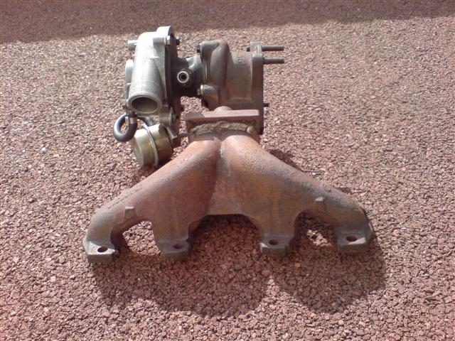

See the plan is a local enginerring firm is going to machine an adaptor plater to my standard manifold to add the wee t15 on there and same wth the downpipe.
Fingers , yh that looks ideal mate
ty again guys

instead of making up an adaptor, you will need to cut up the standard manifold and weld a plate on to the that. i've attached some pics of the manifold i had made up
