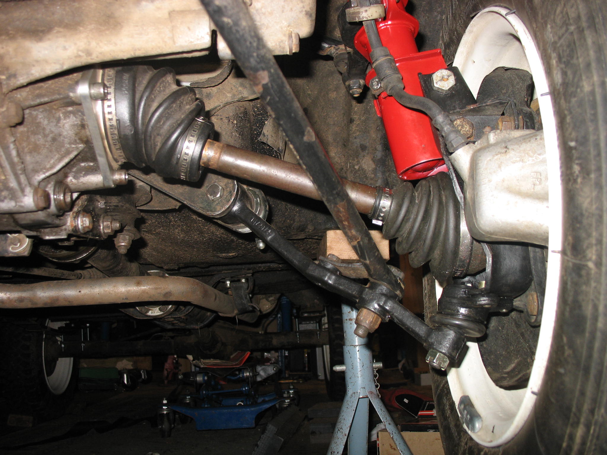

Example photo just to make it easier, please ignore my lower ball joint as it is custom one.

So what are the washers shown in the photo (kindly provided by Mr Kolza) for?
Are these to act as shims between hub carrier and shock absorber? Seems unlikely as there is very little clearance.

Those thick washers are for the M10 bolt that holds the lower arm to the body of the car, nothing to do with the upright I believe.
