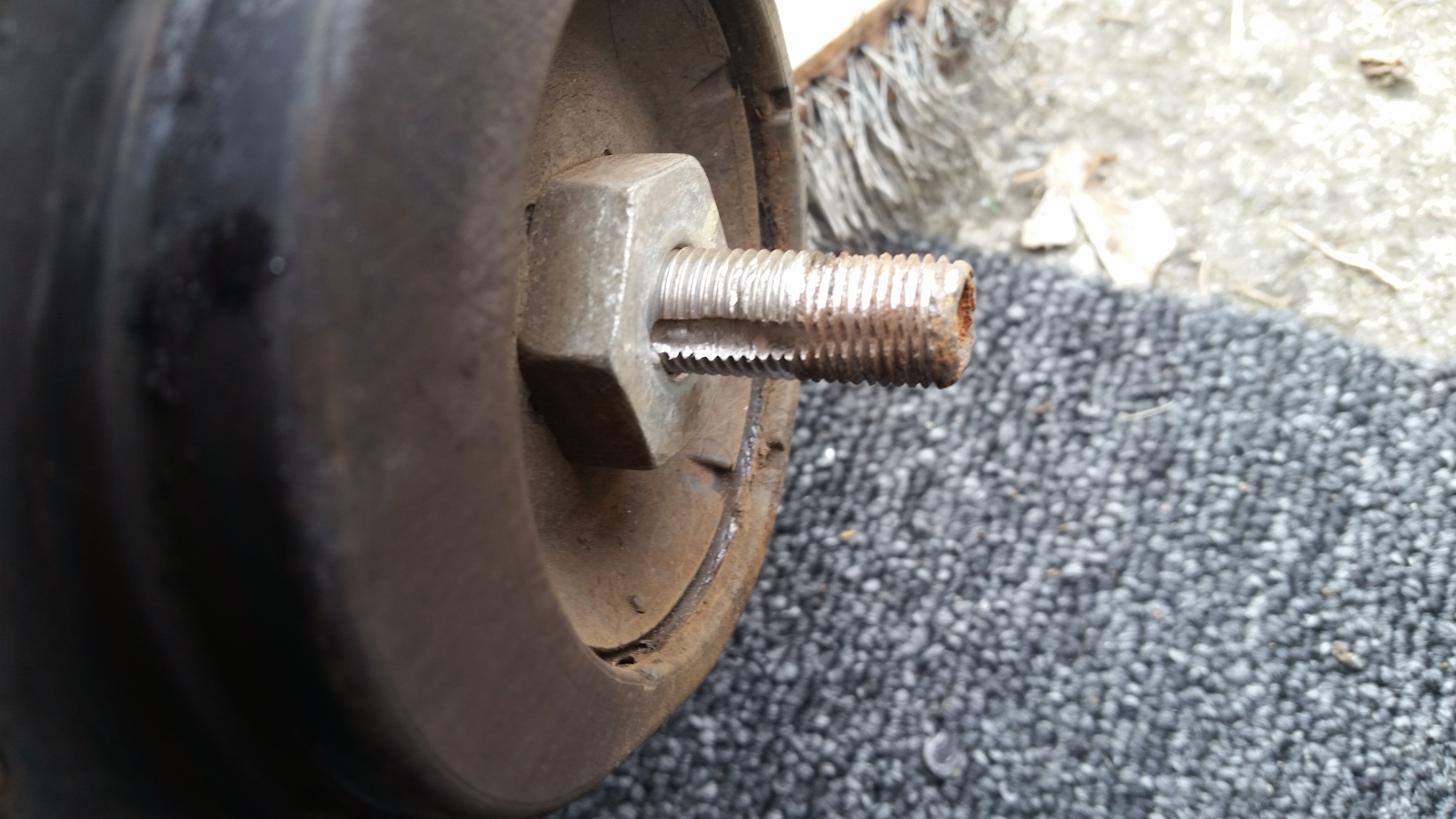

If it's any help this is the 27mm nut on our old strut, I reused the nut as the Nylock is for the top

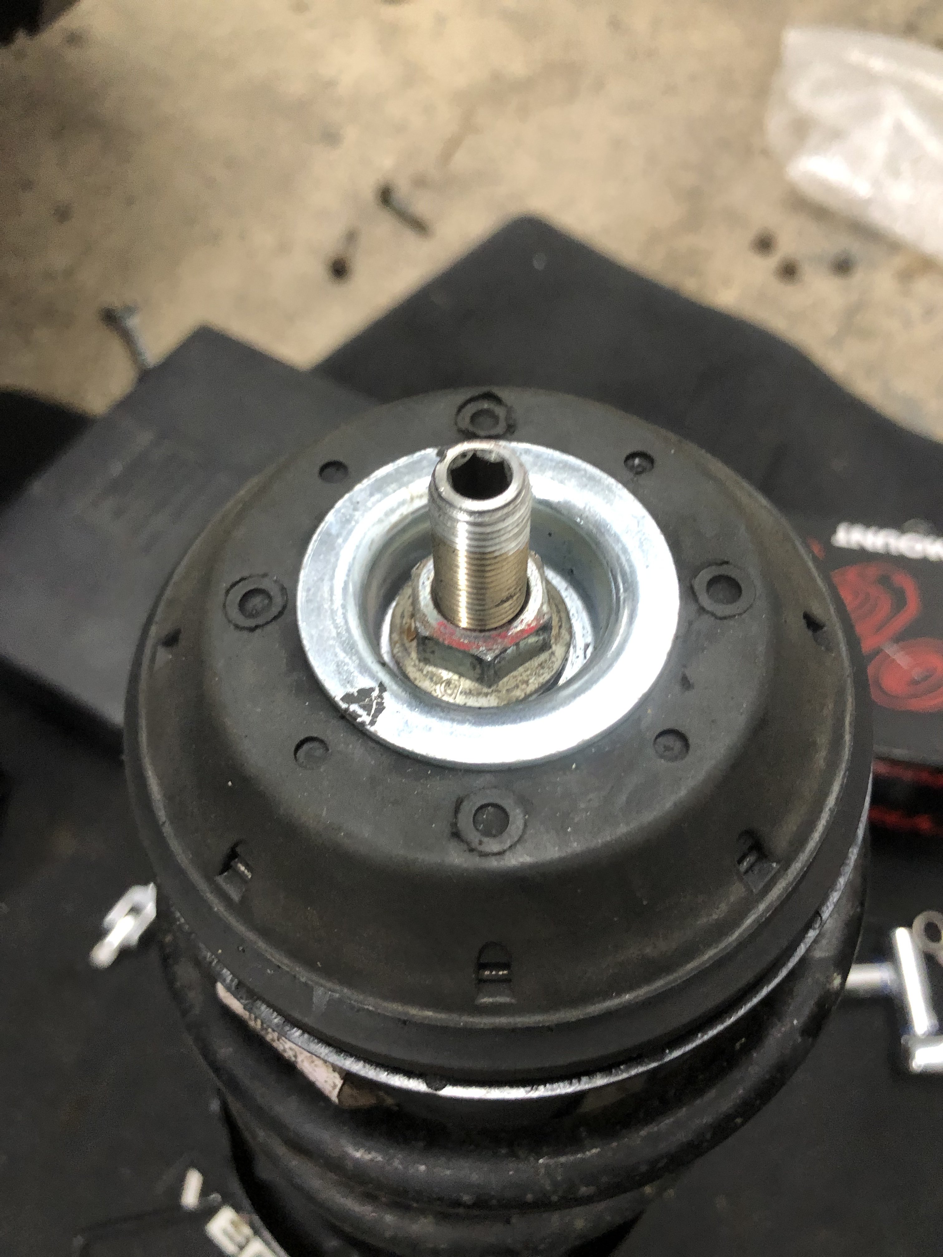

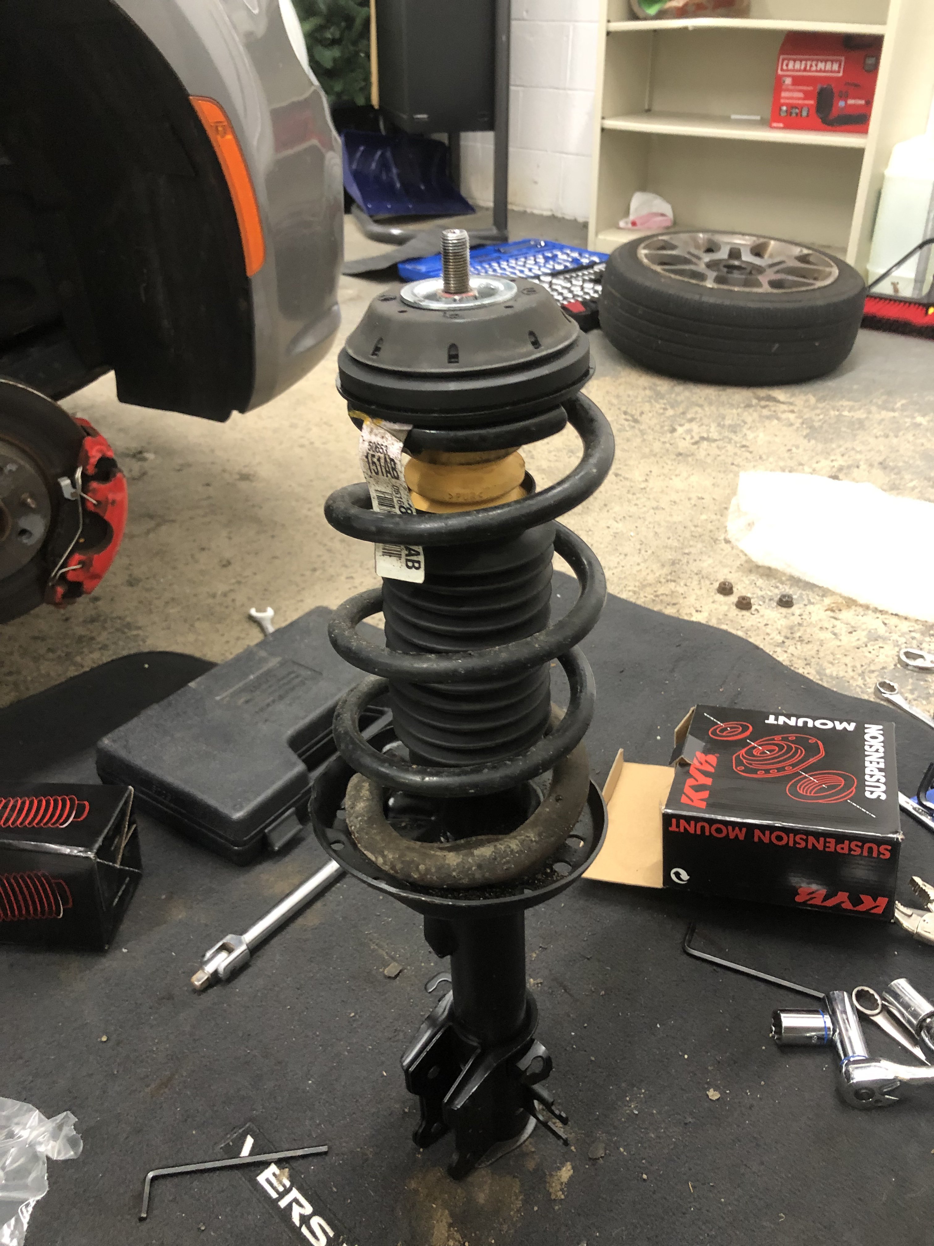

I disassembled the other side and I did forget a washer. The nut holding the strut together at the top is an 18mm. Of course now that I’ve replaced the struts and rear shocks, I have another issue. Not sure if this should be a separate thread but now when I’m driving I get a rhythmic thud that is consistent with speed from under the vehicle. I can’t pinpoint where it’s coming from. Everything is tight and when I jack the car up and spin the wheels individually, there is no noise. This little car just can’t let me have a victory. Lol

So on our older car the top rubber "bearing" is a different shape yours must be an updated design ours had no washer or plate but the bigger nut pressed directly on the top mount face, is the hole in the body large enough that the metal top plate doesn't come in contact with the metal of the car as it seems higher than the rubber face?
