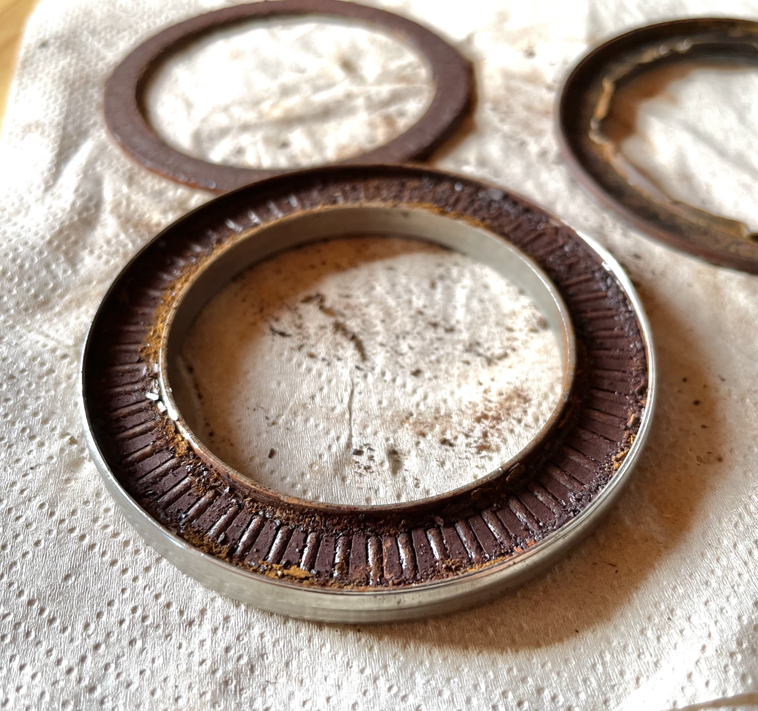

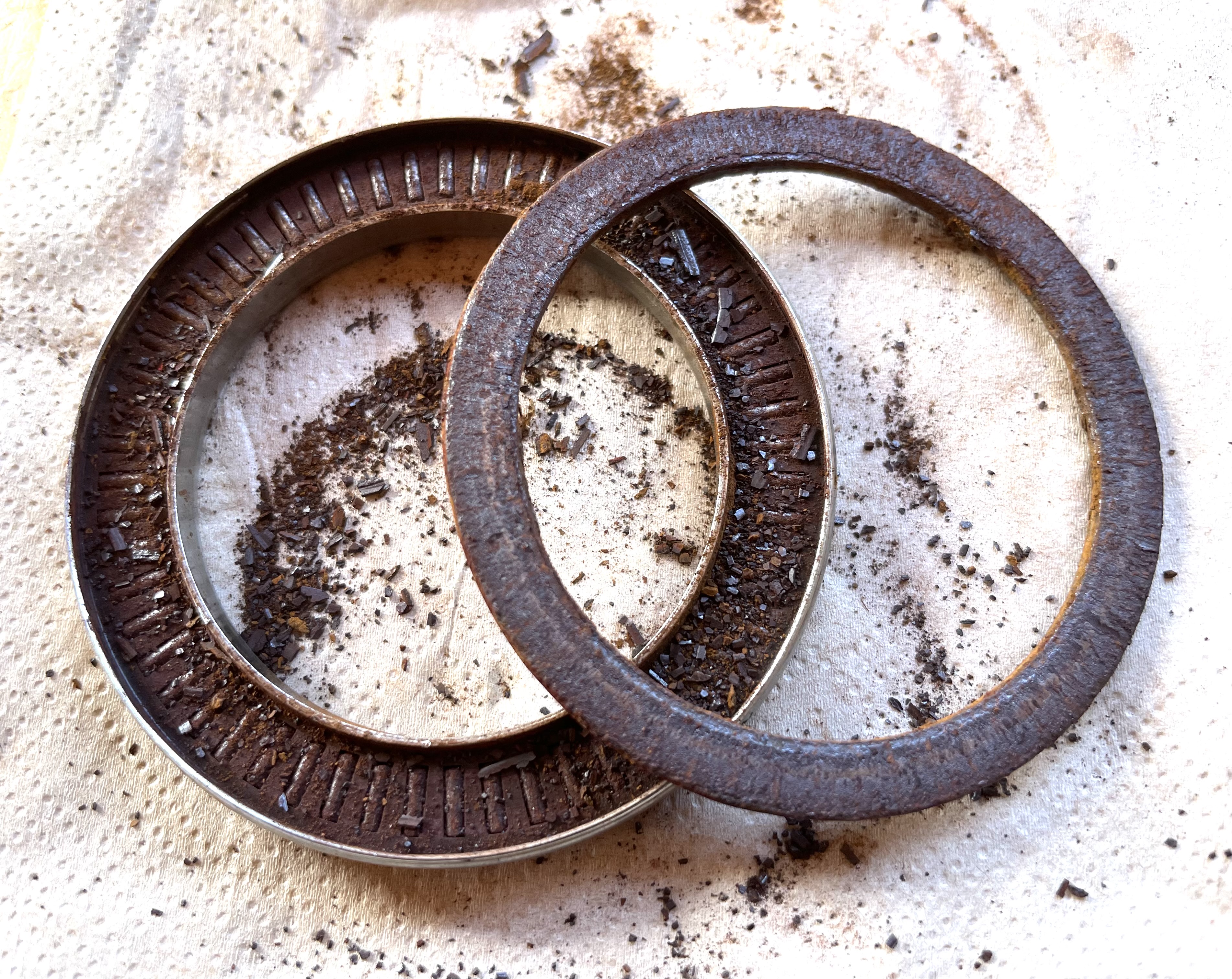

Got it done last week, they changed only the bearing. I took the old bearing apart and found it completely dry, no sign of any sort of lubricant in there.
Pins, race and retainer ring all in one piece but seized with rusty metal chips that look like they have spalled from the upper race.
View attachment 482062View attachment 482063
You can see why I put a dollop of extra grease in them when I fit those mounts.:)
