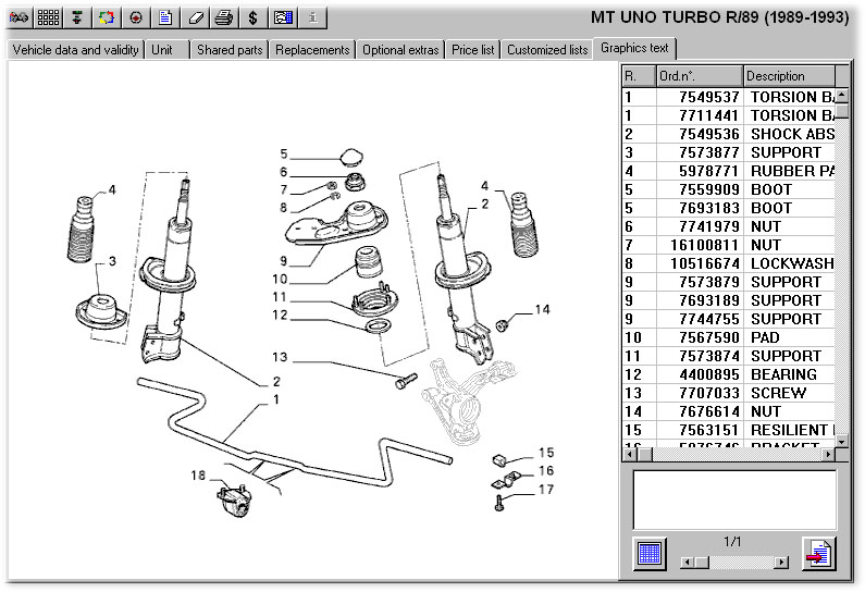

I already have an anti-roll bar but i wonder if it needs replacement after 8 years.
Louie Bee said:
;) I just had a look on my old FIAT eper.
The "Torsion Bar" as its listed – part 1 attached was priced at 68.37 inc. VAT – part number 7711441. - think this is the roll bar - it has some funny names for parts BTW.
The prices are a bit old. I’m not sure which other parts you’d need to fit it, or if still available, but gives a good idea for price to pay.
Kind Regards,
Louie what is this screen image ? Is it somekind of fiat parts database ? Or other program ?
It's nice and usefull if it's a parts database.
:eek: Sorry I'd missed your post.
See here for FIAT Eper CD rom info - contains all Uno parts and price - only £2 ;) Perhaps PM the member and ask ;) https://www.fiatforum.com/showthread.php?t=28941.
Chas - did you spot the bracket on my eallier attachmant - If you did - tell us the number (1 - 18) and I'll look it up for you (y)

Louie, I think that diagram only shows the lower (anti-roll bar) bracket and bush which I already have - it's number 18 by the way.
I have the parts disc, very simliar to yours except mine is all in Italian. Bit difficult to understand at times as I don't speak Italian! I couldn't find the Uno turbo suspension in it anywhere...
The part I'm after might well be in the track control arm section. It's the bracket that holds the track control arm onto the subframe, the one nearest the floor pan (rearmost). It should be a sort of 'L' shape.
Any chance you could look it up for me?
