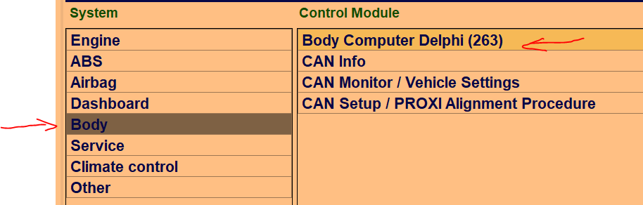

First you have to choose the correct model.
Then choose the system and control module:

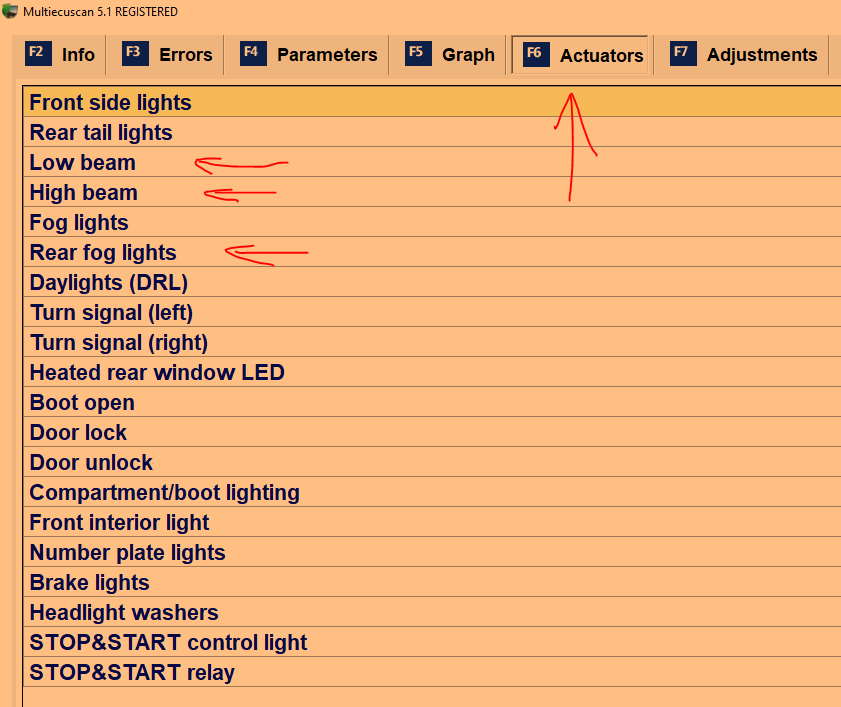

Then in the Actuators tab you can test all lights and other systems managed by the body module:

Tried on MultiEcuScan to activate headlights via actuator tab but didn't work this error is showing. Guessing it's either a bcm fault or a loose wire somewhere
