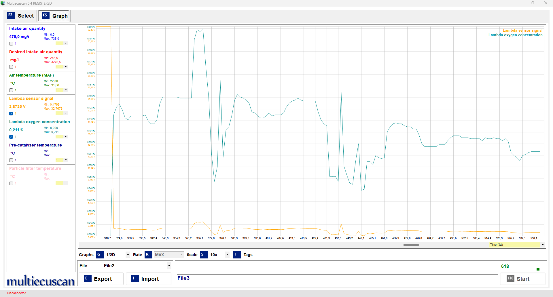

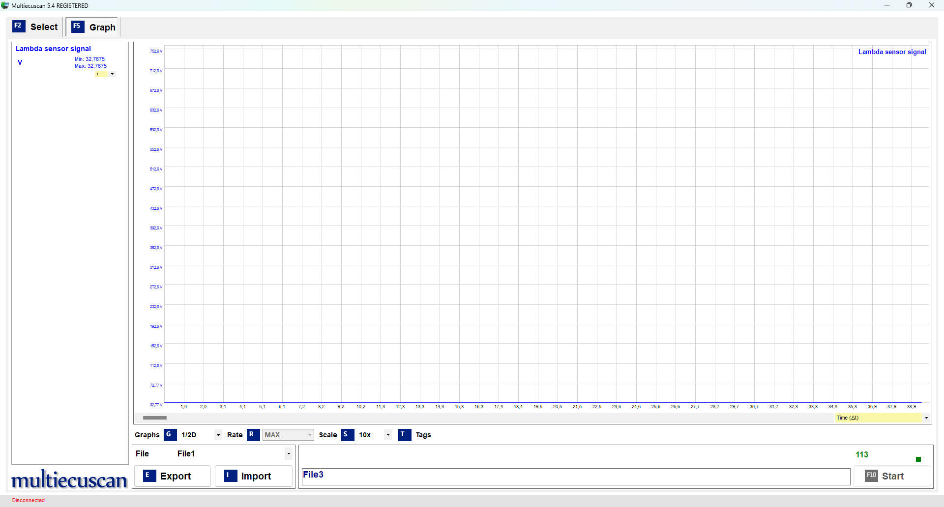

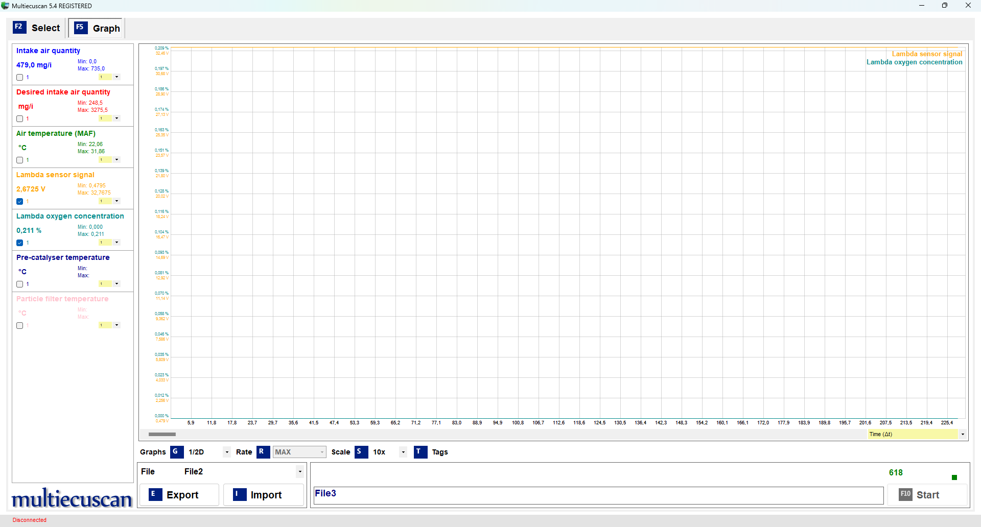

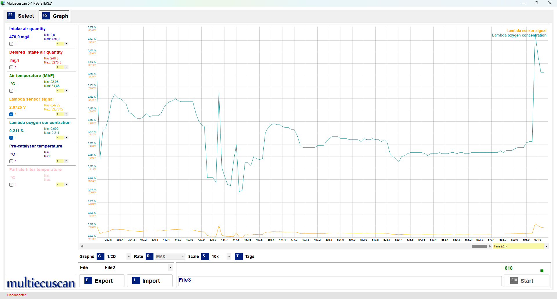

Sorry for the delay, I had a rude shift last night. Here are the screen capture. I don't know what start the lambda but it don't seem to measure before a certain event happened. Same name as before,
Lambda.png : test at idle with the instability present; Lambda2-X.png : test while driving, no instability present at idle (test start with temperature gage at 1/4 of its max value)

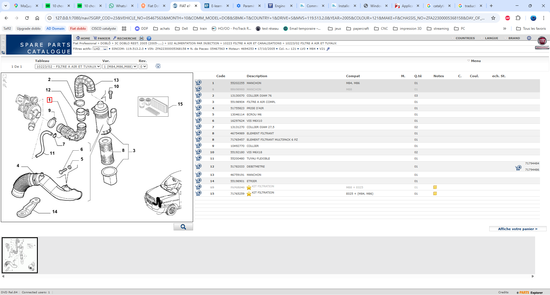

It shouldn't be a failing turbo, my dad checked it when we have change a rubber pipe in the intake (see picture from ePER) and it had no play at all or signs of failure. And my engine don't burn/loose oil/mix it with water, my oil level is still perfect from last oil change (08/2025, no oil refill) and when I change it it have the good color/consistency. Coolant is still at a good level, don't had decrease level from the last 2 years and don't had change color/consistency. I have a power stearing oil leak but it came from the stearing rack

The graph you did... I don't know what that is, but surely must be something else than catalyser lambda's voltage. Voltage is too high for that.
Anyway... I asked for a graph because I had the exact problem like yours. Idle RPM would drop when engine was warming up. I noticed first that it was related to electrical consumers and issue got better after cleaning the ground lines, but eventually came back. I identified the real cause was the O2 sensor (lambda) after cat and putting another lambda sensor fixed it. Engine runs well now.

According to ePER, MES and what I have been able to see and understand on my car, I only have one lambda sensor which is located directly on the catalytic converter (before the honeycomb patern filter). For me the incoherent value is just that the sensor isn't powered yet or that no readings are done on it. I had a similar result on the temperature sensor in the MAF when it was unpluged (I had a -40°C with no variations)

The voltage you recorded puzzles me. From what I know, lambda sensors typical range can be
Narrowband measuring 0-1 V. That's what I have and I think yours should be the same
Wideband measuring 0–5 V (usually ~2.5 V center).
Your reading is way off to those ranges.
So the cause might be lambda sensor on yours, too. It's just very unclear for now, data you collected. Needs more investigation and a graph made on different car for comparison would help.

The reading is out of range up until the 2nd picture of the second graph (Lambda2-2.png) where the lambda tension (in yellow) drop from 32V to 1,7~2V. The part where the lambda is out of range can just correspond to the delay before the lambda value is read. According to eLEARN (the online version when it was available), I should have a heating element inside the lambda, I can add it to the list of check I must do on my doblo
