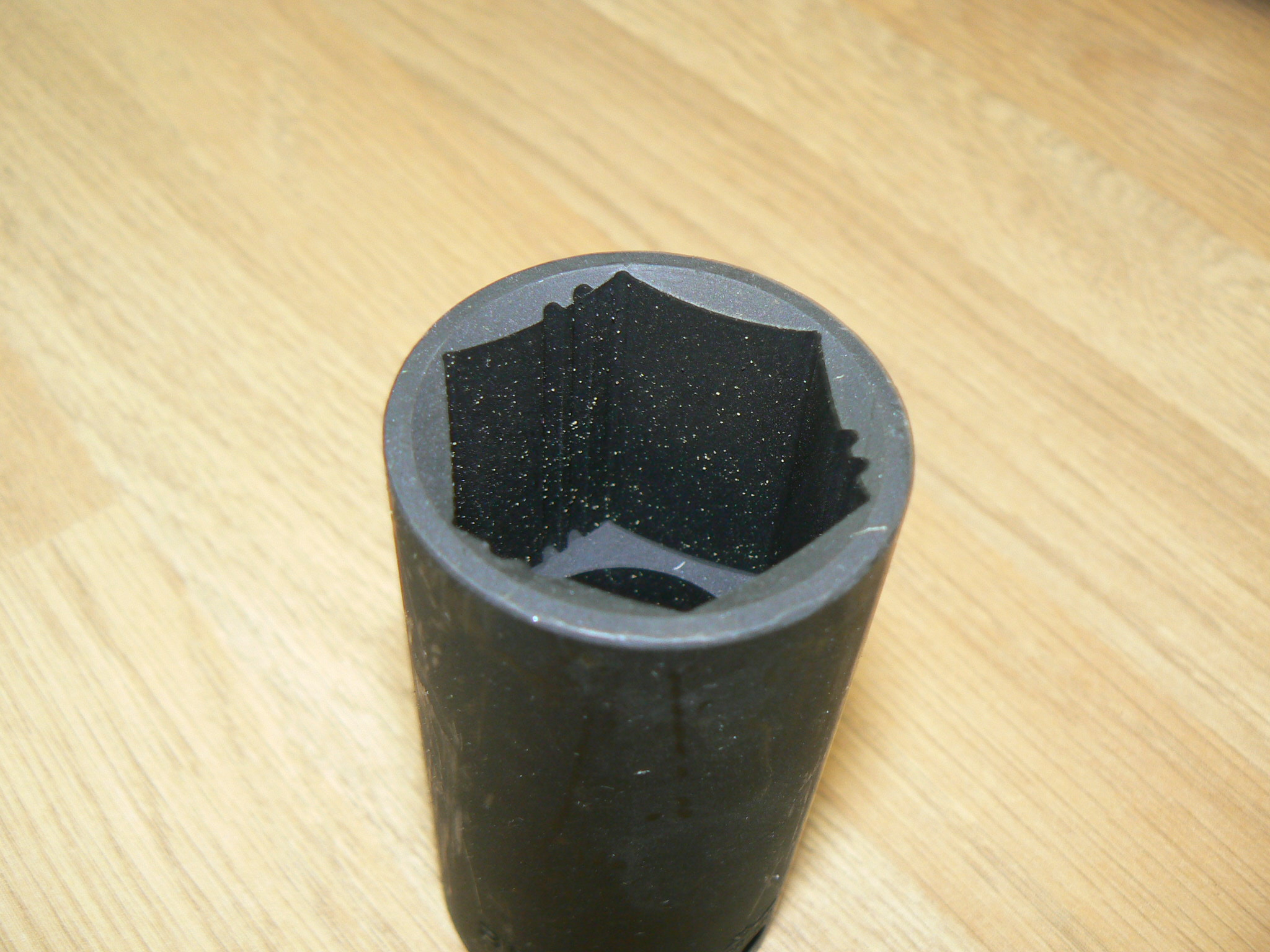

Just a wee "heads up" on the subject of solutions when tackling damaged hex heads. Some time ago, when I bought "Hooligan" - my very powerful pneumatic impact wrench - I realized that I needed to buy a decent set of deep impact sockets because my standard bright chrome ones were unlikely to withstand the forces.
I came across "Lock On" sockets which I'd never before heard of and as there wasn't much of a price difference between them and just standard single hex ones I decided to go with the Lock On ones - not really believing they would actually make all that much difference when it really came down to it. At the end of the day I bought Bergen Xi-On branded ones as I've got some Bergen stuff already and it seems to be good.
The big feature of all these Lock On types is that they have grooves milled into the inside of every second face. Here's a close up of one of the Bergens:
The idea is that, as long as there is a vestige of a flat left on the hex you are trying to drive, it will dig in and raise an edge it can bite into. I really was very sceptical about this but it really does work. Here's a video which pretty much demonstrates what I've experienced with mine (although he bought the Sealey branded product. Same thing different brand name) If this subject really interests you do watch the video right through (it's a bit long winded at the start as he rather goes "off on one" about an adaptable socket before getting on to the Lock On sockets):
https://www.youtube.com/watch?v=iJMTD_OR3RQ
When used on undamaged fixings they don't seem to leave any marks on the hexs, just work like a normal single hex socket.
