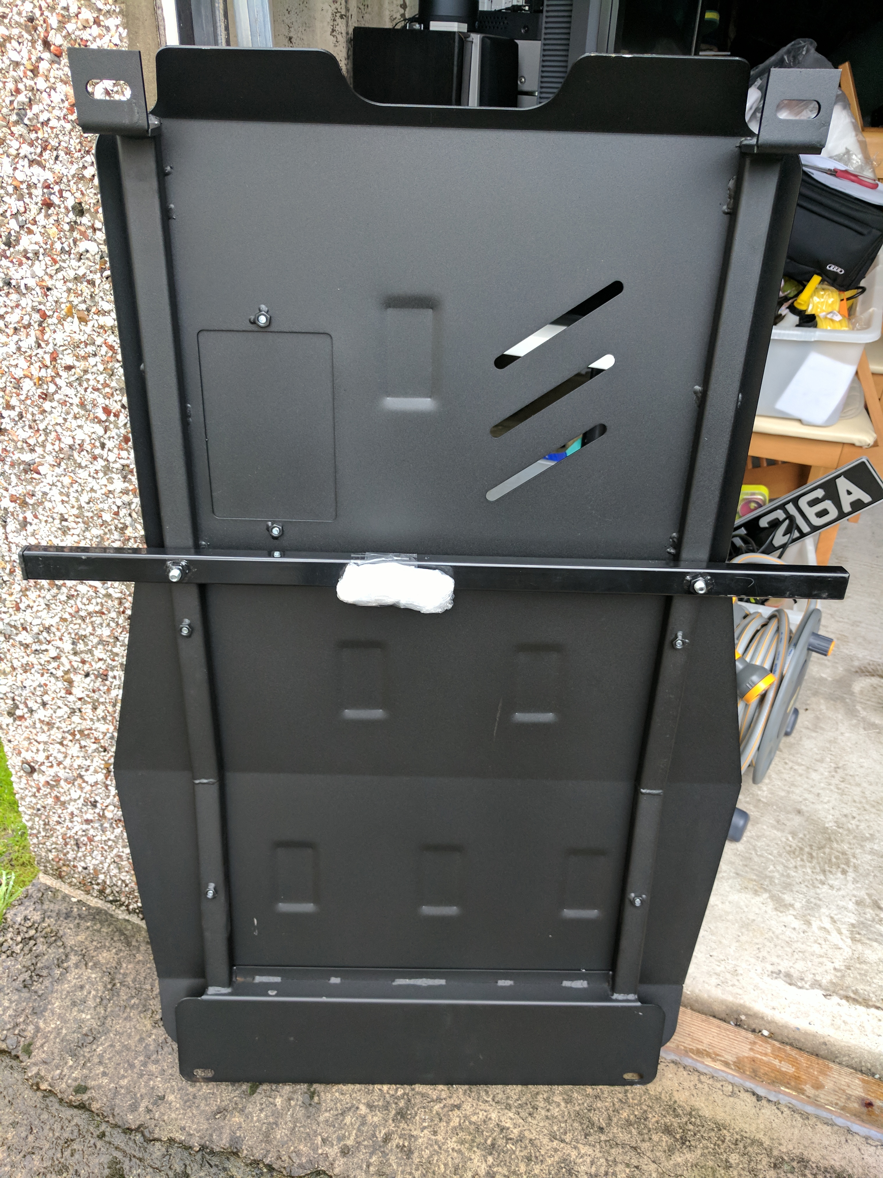

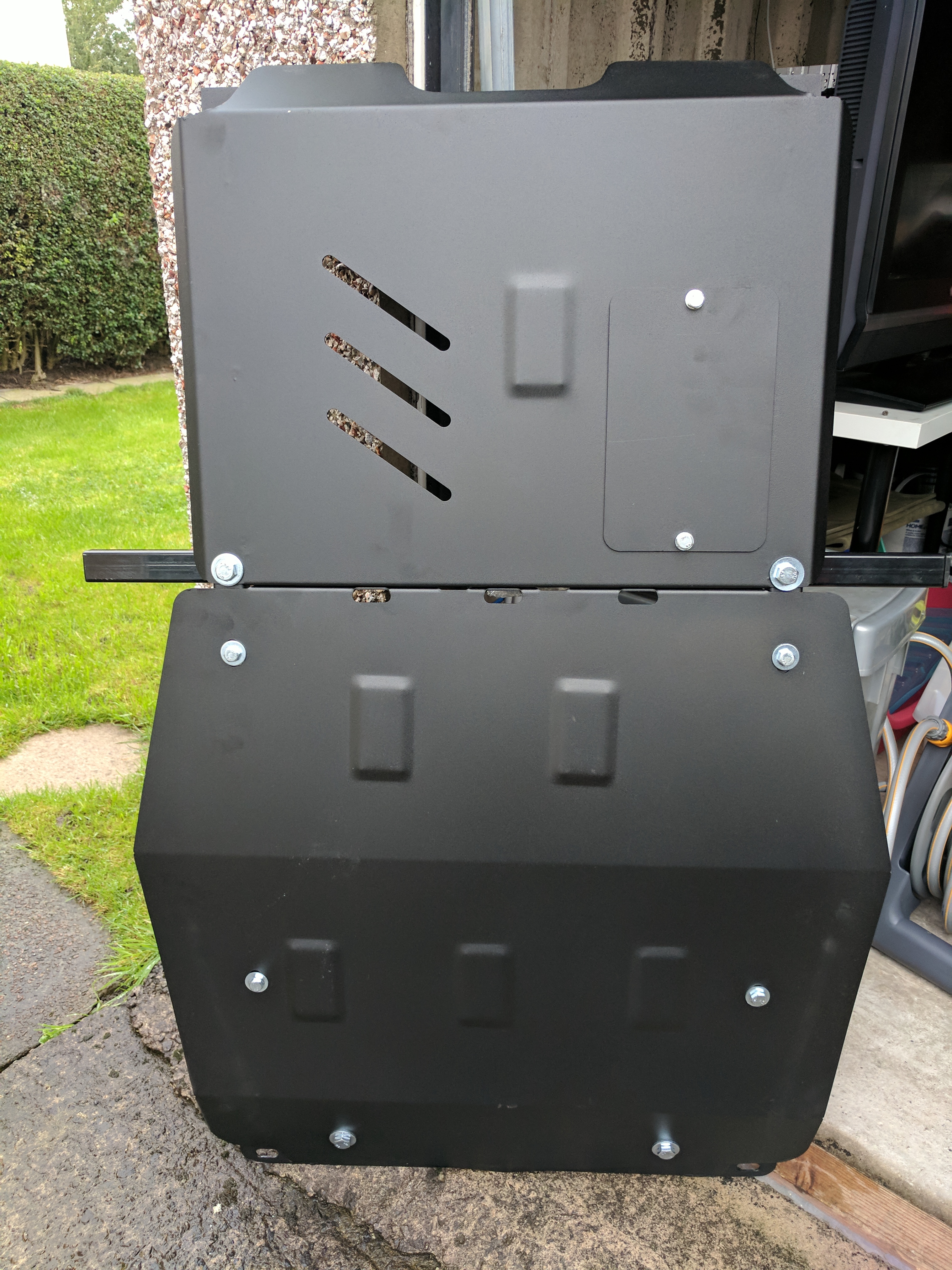

Well this turned up today ?
And fitted photos will be posted soon.

Looks like a fair old chunk of metal you got there lad! Be interested to see how this goes.
Annoyingly my car doesn't have it's engine tray on at the minute. A lot of the fixing bolts snapped off, so I can't refit anything. It was also sagging rather low, so kept hitting on things too.
Be interesting to see if this supports itself better than the flapping plastic factory cover.

I may go down this route... it appears to have an access panel for draining the oil! Sweet.
