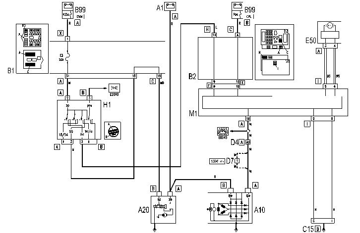

As your starter is permanently engaged then disconnect the starter relay wire, the smaller one of the two- brown and white wire- (not the big one with two red cables)
If the starter is still engaged with that wire disconnected then the starter relay is jammed or there is an electrical bridge across the two connections on the starter relay
If the starter is no longer engaged then the problem is within the ignition switch. This is very likely as you're also getting dashboard lights going on and off

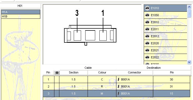

There should only be 12v at pin 3 on connector A at the ignition switch or on the brown /white wire at the starter relay when the ign key is at the start position
