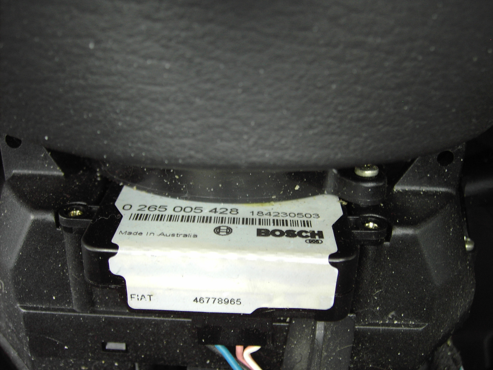

The steering angle sensor is fitted in the multi function column switch. The sensor for your car may be a different part number to the Stilo JTD one in my picture.
Thank you. I'll look into that. The column has to come off anyway to change the motor.
